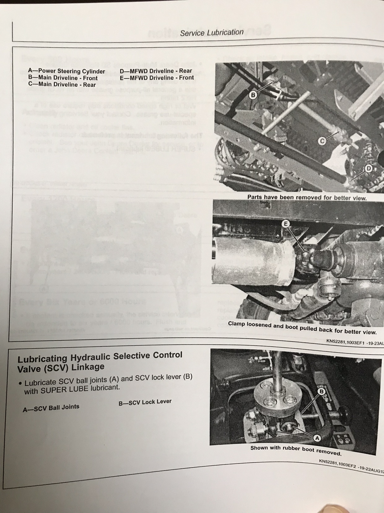

my manual does show the main driveline lubrication with a 50 hr interval. What also caught my attention his morning is that the loader SCV valve ball joints and lock lever may also need grease. This is the 4th tractor with a loader that I’ve owned since Y2K and I don’t recall having to do this previously for any of them. Maybe I've been missing a step, I better double check the manual for my other tractor too.

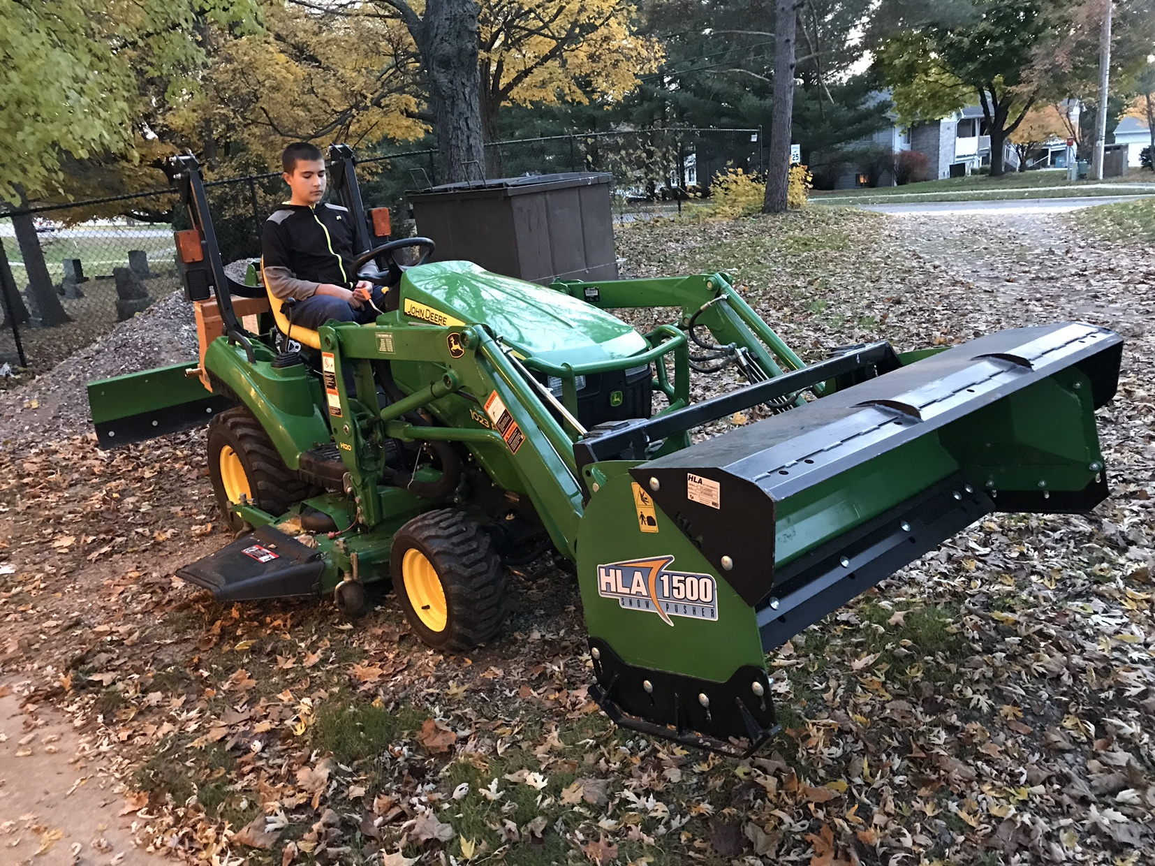

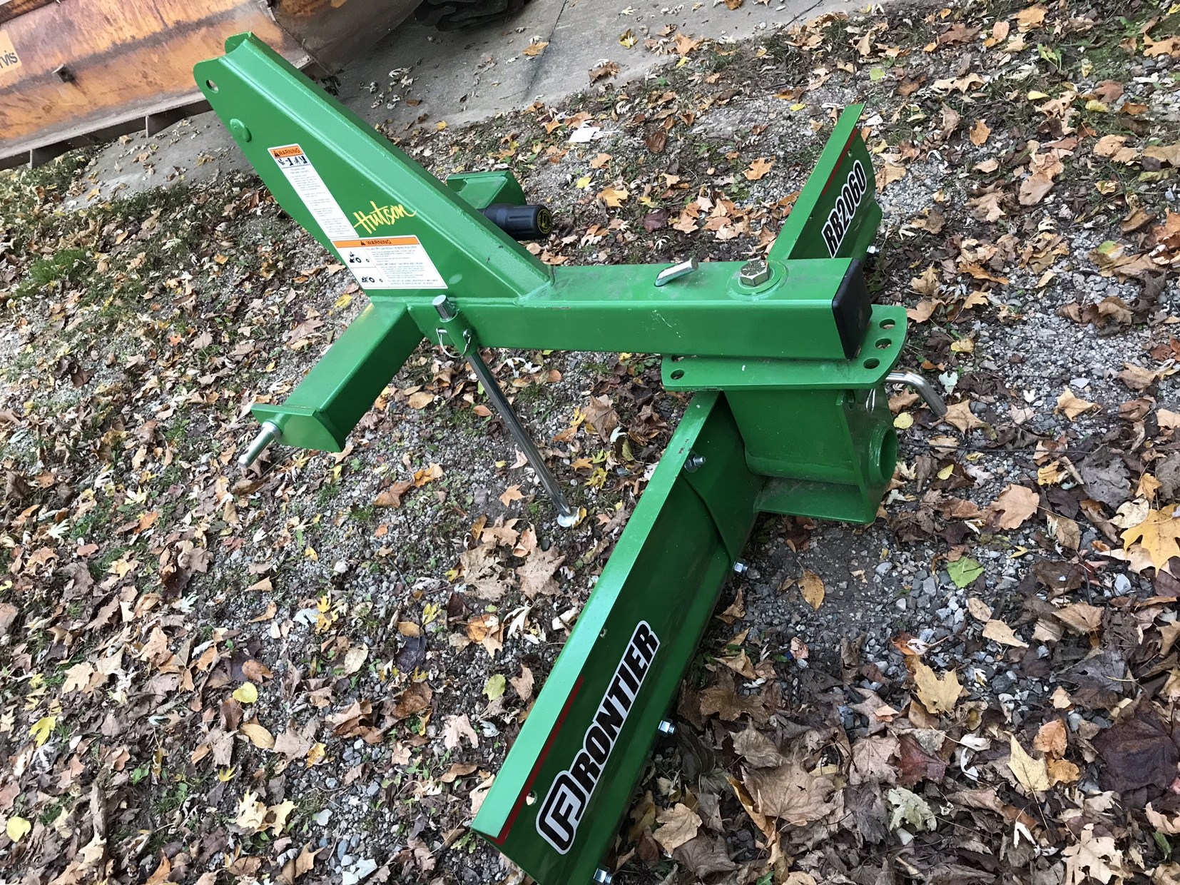

I decided to get some more equipment for the little 1023 this week. My local Deere dealer has some inventory in his yard and gave me a little bundle deal for these two items and a heavy hitch receiver that I’ll try to get installed tomorrow. My young apprentice is pretty happy about this new equipment too.
