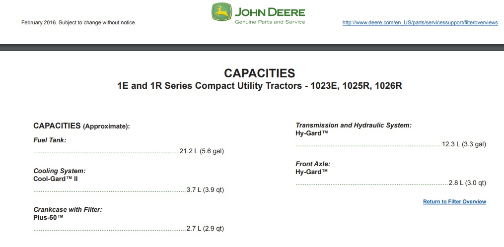

Pretty sure the manual says to use GL5, something like 75-90.
   / Surprise 1023e owner looking for advice.
#32
That may be a good possibility for what was in there. I'd still love to see it in print, but I just looked through the operators manual again and still don't see it listed anywhere.
   / Surprise 1023e owner looking for advice. #33
No it does not use gear oil it uses UTF. Look at this:
  • 1023E_1025R_1026R Service.pdf
   / Surprise 1023e owner looking for advice. #34
John
You thinking UTF is the same as HyGard?
Appears HyGard (in print) is just what milkman used.
#35
#37
Gotta check the label on what you are purchasing to see if it is HyGard compatible.
(y)
It was actual John Deere HyGard. I used it on assumption from previous experience, Seeing how slowly the stuff coming out flowed in comparison with the HyGard going back in made me question that decision. I really appreciate seeing the correct oil in print from Deere. Thanks for posting that document.
