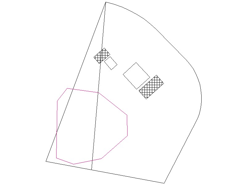

JN4310 said:
plowking,
Does a lot line adjustment mean someone has to give up some land? I don't think my new neighbor would want to have a smaller lot just because a surveyor made a mistake. The houses are in the first third of the lot (from the street), so move the lot line over 40 or 50 feet would have a huge impact on his property, even if I compensated him with more land in the back. The back of both our lots are basically unusable due to a large wetland that spans both properties.
I'm new to this type of issue, but I really can't figure out a good resolution, short of tearing my homes down and rebuilding them 50 feet away. I also didn't move out to the country to live on a zero lot line property, or have a neighbors fence run thru the middle of 'my' back yard. I really need some good suggestions.....................

I updated the sketch to show roughly where the wetland and buffer area are. The actual distance of the error is 175 feet, or 1.33 acre total.

Boy a 1.33 acre mistake on a 5.5 acre lot is huge and it is going to be expensive for someone. The surveyors insurance is not going to want to put up a penny more than they have to. The new owner next door could well tell you to get your septic off his new property and you have 30 days. He may well have the right to bring in a backhoe and remove the septic without notice, it is on his property. A variance for the building set back would be the cheapest for the insurance but it doesn稚 solve your problem of the loss of privacy and they would most likely say 鉄o what, you don稚 have to move your building and you now have a proper survey. There is no way in my opinion they are going to offer to rebuild the two structures.
Really sorry for your problem but I believe I would already have someone in real-estate law on my side representing me.
MarkV
   / Surveyor mistake - a big one #36
I would really advise you to get a good lawyer involved. You don't know and haven't met your new neighbor. He is most likely not going to be happy that what he bought is not what he thought he bought. This could turn into a much larger can of worms than you think if he decides to push the issue from his point of view. Stand firm on a desire to have your property made "whole" or that the surveror's insurance pay to move the buildings, compensate you, or buy your property.
My neighbor's property was surveyed at statehood (1907) here in Oklahoma. A mistake put the property line approx. 50' south of where it was supposed to be. The county built a road which ended up being entirely on the north neighbors property and in fact the property line was 10' to 15' feet past the road easement. Later surveys showed it to be off, but everyone just let it slide with no notes or admendments to the legals until it was sold in the early 80's. The new neighbor wanted "his" property and tried to force the issue of having the road moved which would have put it thru the south landowners house(which had been there 30+ years). There were threats of shootings and several arguments(they where both big horses patoots) until a judge finally ruled that all lines(surface rights, mineral rights stayed as originally assigned) stood as they where when the property was transferred and had a record filed in the deeds to that effect making the county road the actual property line. It was a simple fix to a simple probem that "reasonable" people could have worked out. The problem being that there where no reasonable people involved.
