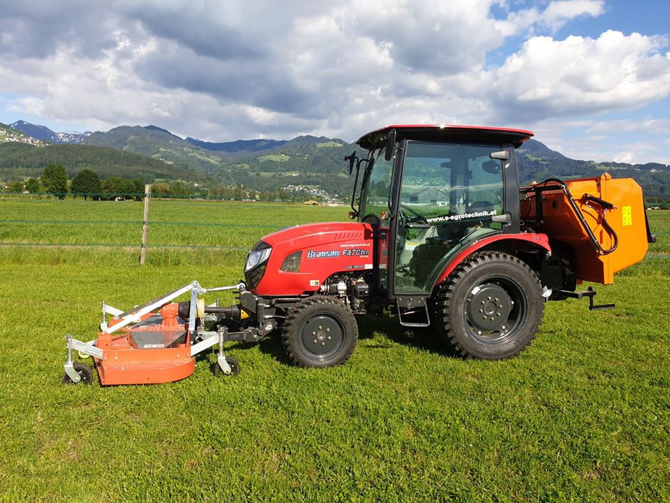

I was trying to give you the link for the Portuguese LS importer but they don't have the English version working quite right, so I'll give your the German one. LS Traktor | Die offizielle Website von LS – Jetzt Ihren Traktor konfigurieren
The main difference between Germany and Portugal, is that we get the Orchard or Vineyard version which consists on a slightly narrow stance and mainly the mid mounted ROPS that folds over the hood making the steering wheel (usually) highest point, therefore making the height of the tractor much lower to go under the branches. Also in Germany, HST is a bit more common than Portugal. In Portugal, I would need to special order an HST model if I really wanted, with a much higher price.
The front 3 pt hitch plus PTO is pretty nice to have. In my opinion, it's a much superior system than the Kubota and JD proprietary ones. The 3 pt implements are much cheaper and there are a lot more variety of implements. The Kubota and JD ones are often crazy expensive, prone to failure and lots of play with usage and one is usually limited to the implements they offer.
Look at this nice setup. Couldn't find an LS picture but it's just to show the concept. Front finish mower and a collector system in the back with dumping feature. Also note the new R14 tires that have been used for sometime in Europe, mostly by municipalities.
