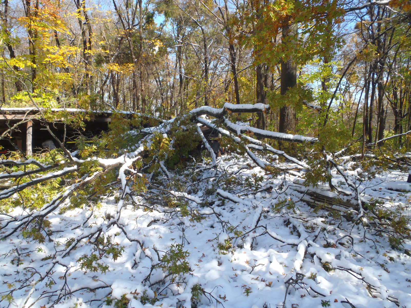

My Kubota has what they call GST (Glide Shift Transmission). Basically, it's an electronically controlled hyraulic actuator system that shifts the manual transmission and actuates the wet clutch. It doesn't need to be clutched, but there's a clutch pedal (dry clutch) that allows you to maneuver very carefully in fussy situations. I used the dry clutch a lot, last weekend, to pick up & place support posts under the shattered beams of my shed after a tree fell on it during our October snow storm. Made it a one man job.

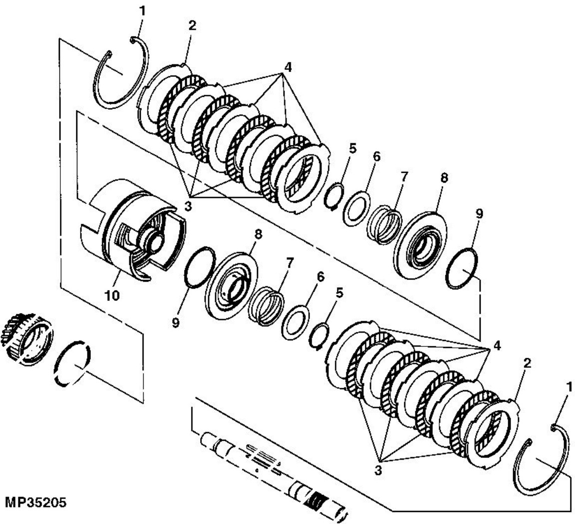

I have a JD 3520 PowerReverser. Once you have chosen what gear combination you want to use (B3 most of the time for me), you never want to use the clutch. Put the reverser on forward to drive forward, on neutral to stop or on reverse to reverse at the same speed you were driving forward. You don't need to stop before reversing but you may experience quite a jolt if you are driving at speed. Here's what the hydraulic contraption looks like.
