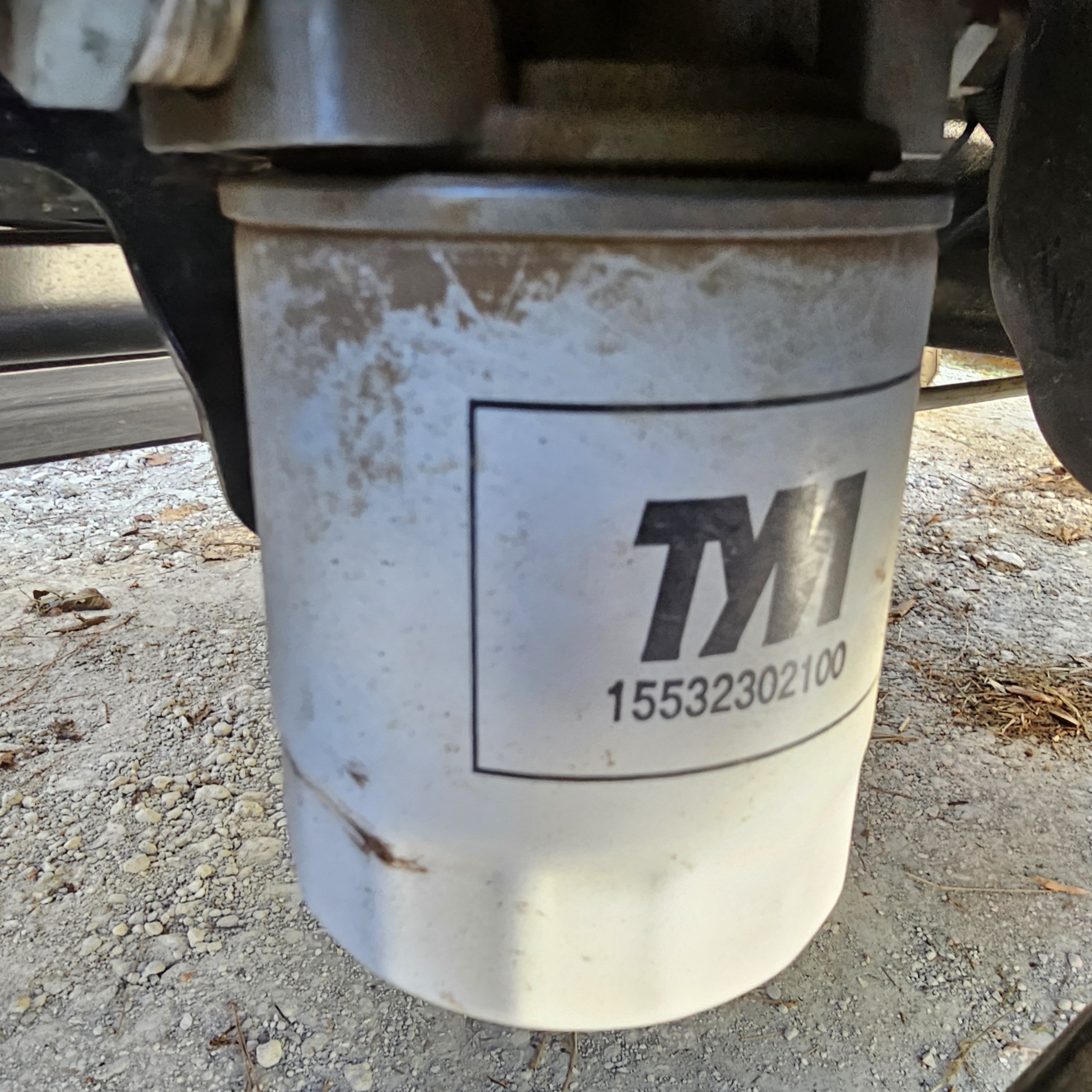

/ T494 HST Filter
#12
The original HST filter was 15532302100 and its mounted vertically but newer models use 19265154110 which is mounted horizontally. I wonder if they changed that because the vertically mounted filter was hanging too low and could get damaged easier.

/ T494 HST Filter #18
This one! Now I have to go back. The manual isn't clear at all. It only refers to the bigger filter and the oil filter.
/ T494 HST Filter
#19
I agree, the documentation could be better. I actually bought this filter from Rural King for ~$36 but when I tried to install it I found it didn't fit. This is the original filter on the older T494/T574. I had to take it back and could not find the new filter in stock anywhere. But this is not the filter TYM put on my new tractor, they used the [WD-724/6] Mann and Hummel Hydraulic Transmission Filter.
The filter you bought is still needed on your tractor though, its the other hydraulic filter.

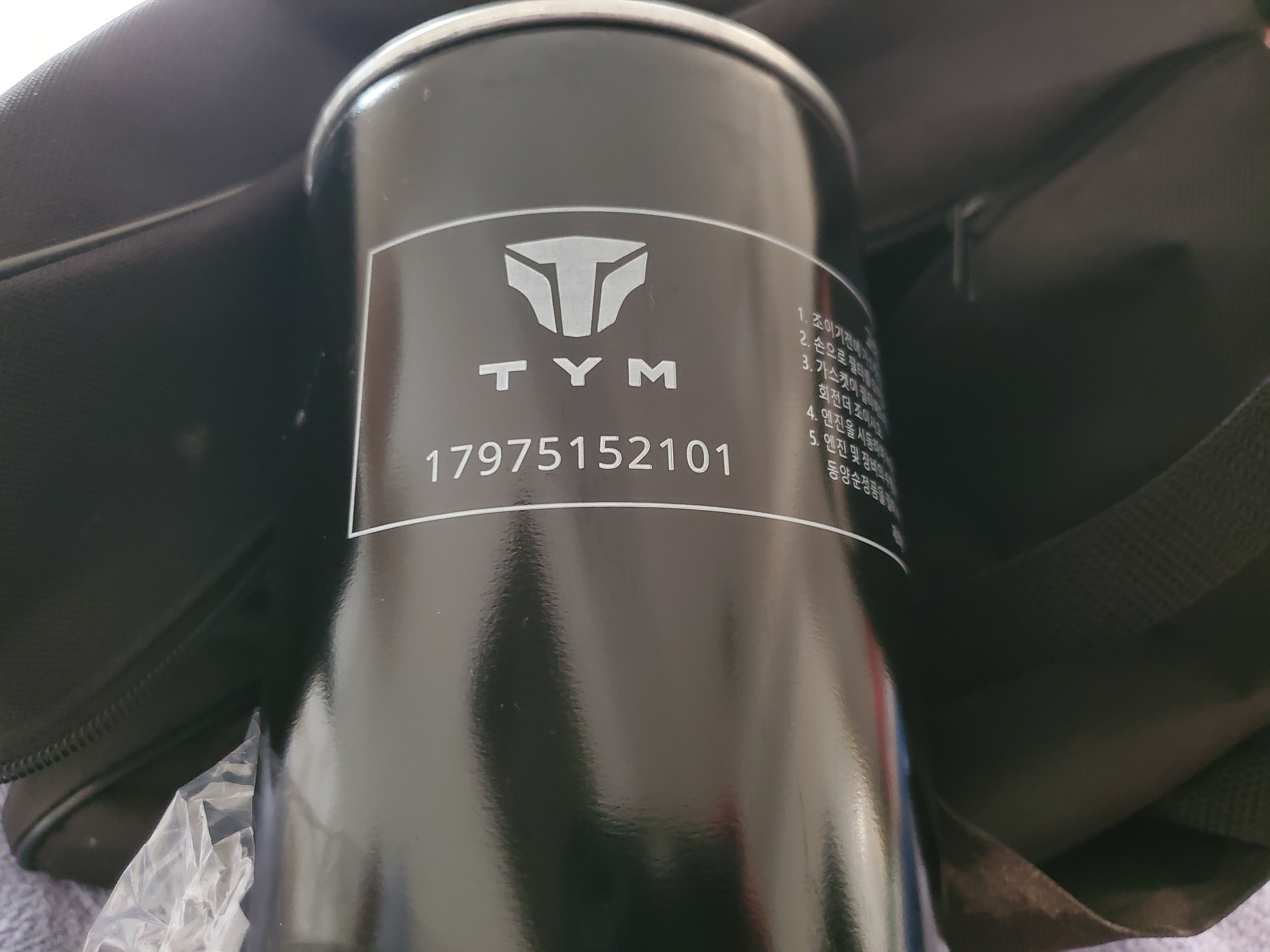

/ T494 HST Filter #20
I bought the oil filter. The picture they gave me with the tractor.
Oil filter was $20. I should call and see if they have one of these.
50 hour service is due and I want everything ready to go before I start.
Any recommendations for filter wrenches?
