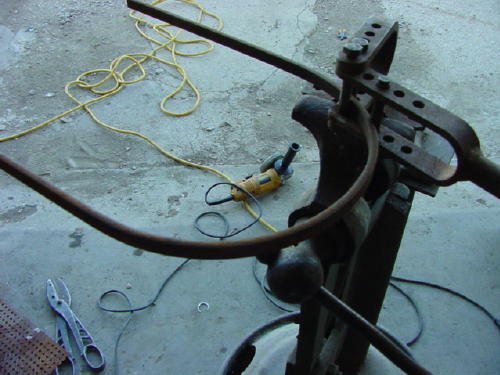

#31

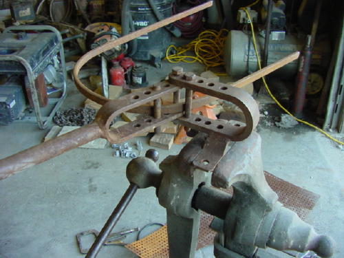

I use a Craftbender a friend of mine makes and sells at swap meet--trade days. It's handier than a pocket on a shirt for doing stuff like this.
The trick is making lots of little adjustments, lots and lots. The bar stock starts out straight. Then usualy the first half the one eighty goes pretty easy. The second half will curl hair on a bowling ball. But with enough bends and unbends it comes out okay eventually.

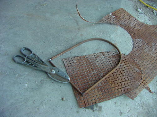

   / Table project rock
#33

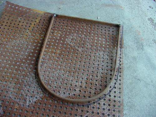

The "fabric" is twenty six gauge sheet metal punched out to look like wicker material.
#34
Sheet metal scissoring one oh one and we have "fabric" for the seat.

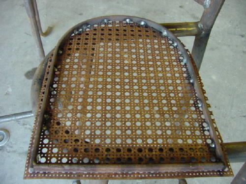

#35
Then it's a simple matter of welding twenty six gauge to quarter inch stock. Simple. /forums/images/graemlins/blush.gif

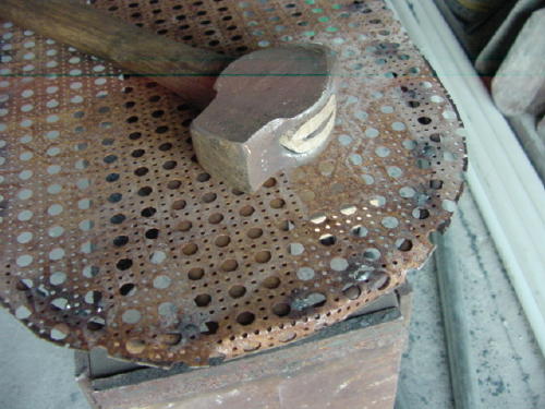

#36
Then it's to the anvil and my Uri hammer to do the fold over.

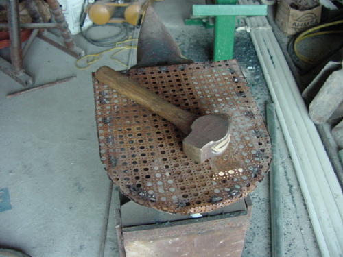

#37
That Uri hammer is about as good as it gets. My hands don't do it justice. But I'd kill if anyone touched it with bad thoughts within a block of their mind. /forums/images/graemlins/grin.gif /forums/images/graemlins/blush.gif /forums/images/graemlins/tongue.gif

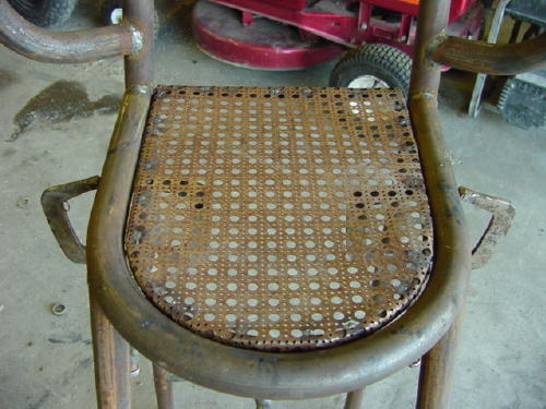

#38
All that's left is to put some welds underneath when the frame's been all ground and polished.
You know I have to wonder if Ibrahim probably rolls his eyes everytime he sees me start one of these projects. All that bandwidth...........all b.s. (band stuff)
