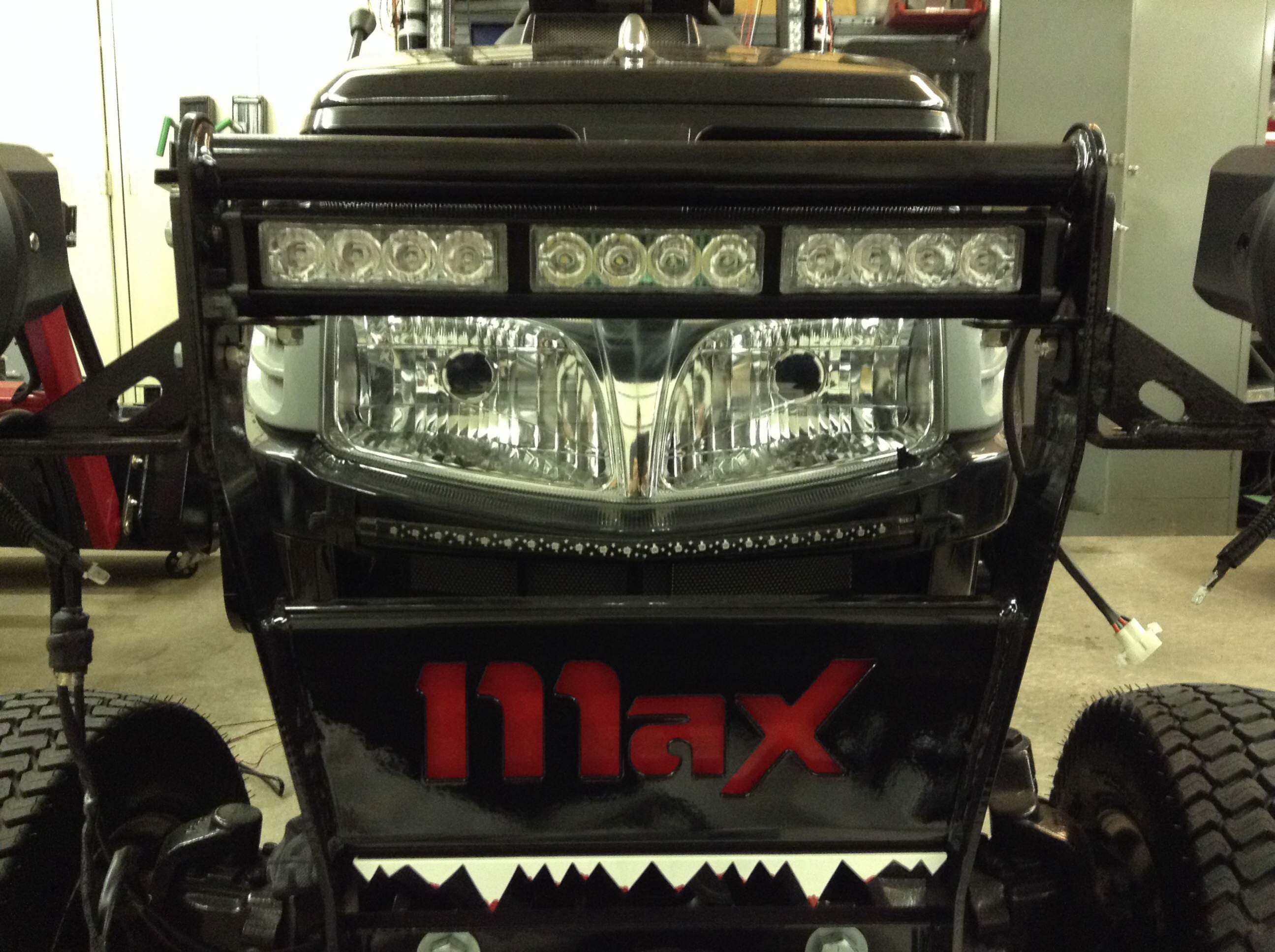

I have been busy finishing my strobe lights. It was worth the effort but I need a break, ALOT of wiring but my 6 zone contoller with twenty plus flash patterns is really cool. Psychedelic and almost seizure inducing comes to mind... No way anyone's not gonna see me out there. I need to take a video for this one, lol, and the only mounted pic I have right now is of the crash bar unit mounted.
   / Takin it to the MAX #105
I have been busy finishing my strobe lights. It was worth the effort but I need a break, ALOT of wiring but my 6 zone contoller with twenty plus flash patterns is really cool. Psychedelic and almost seizure inducing comes to mind... No way anyone's not gonna see me out there. I need to take a video for this one, lol, and the only mounted pic I have right now is of the crash bar unit mounted. <img src="http://www.tractorbynet.com/forums/files/mahindra-owning-operating/405850-takin-max-image-jpg"/>
It looks like you are building a tricked out tow truck with all those fancy lights. You could definitely collect some Trophy Cups with that Tractor!

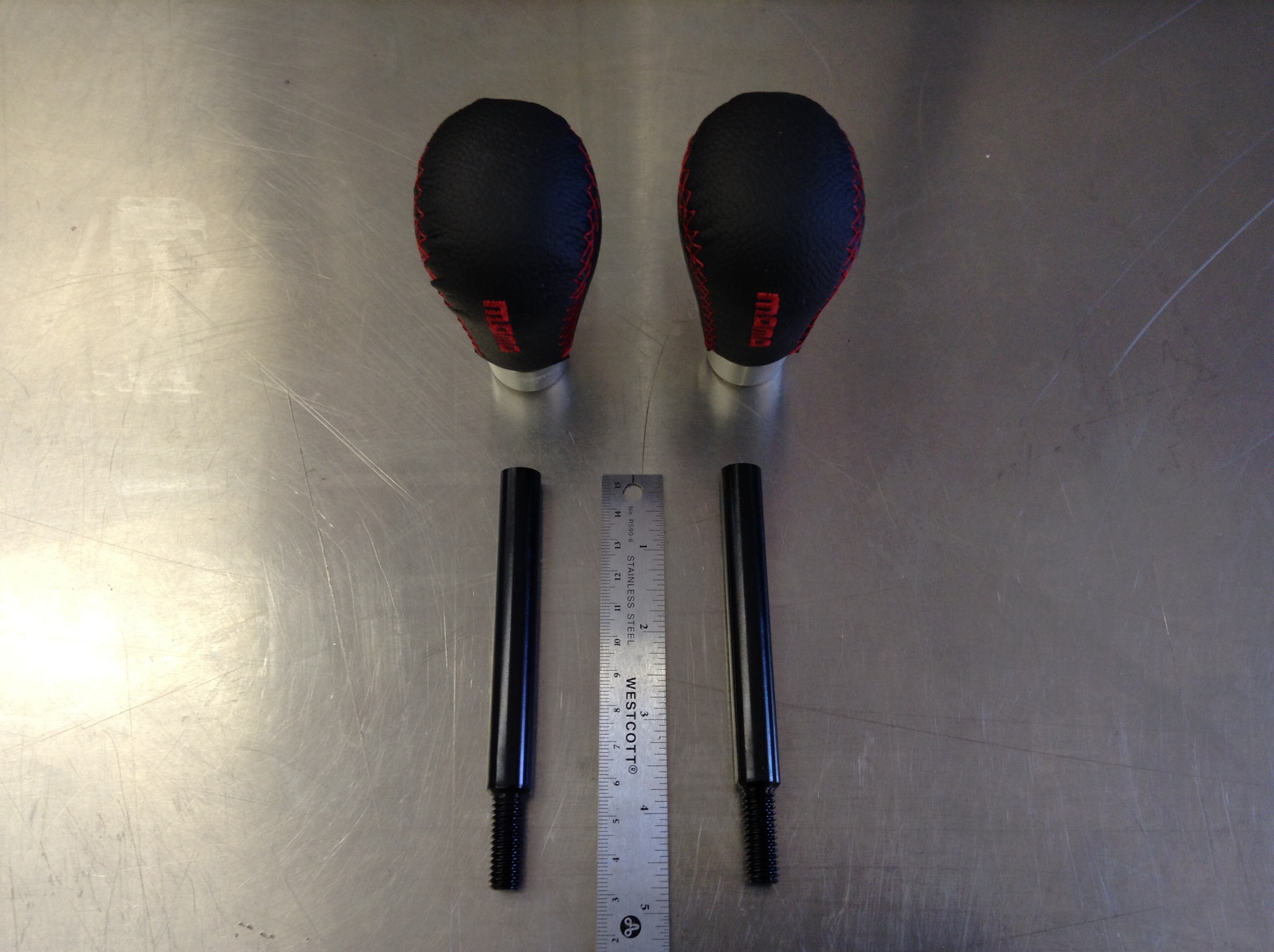

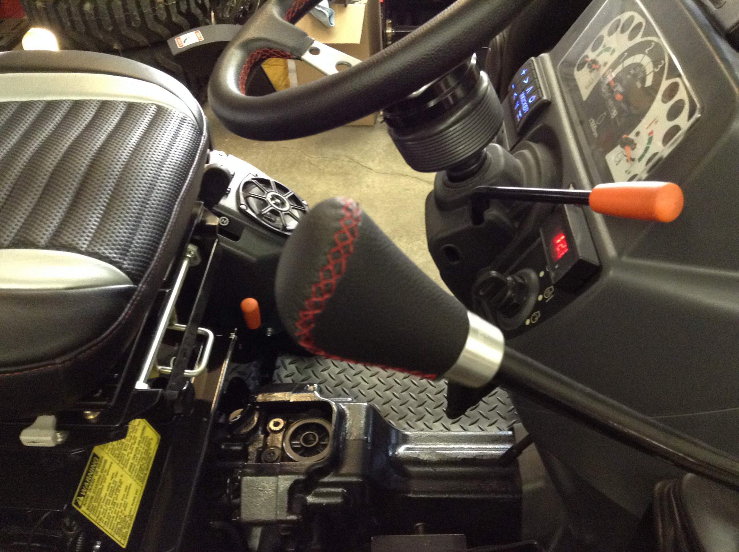

Updating my build thread, so I will start with a really simple mod. My joystick knobs were not very exciting so I decided to replace them, my shafts are standard 3/8-16 thread so it's almost unlimited what you can use. They match my steering wheel and for the backhoe I found the shafts a little short reach wise, so thanks to some more tuner car technology I am gonna try these 3 3/4" shifter extensions which will thread right on. I won't bother mounting the backhoe knobs until after I paint the booms.

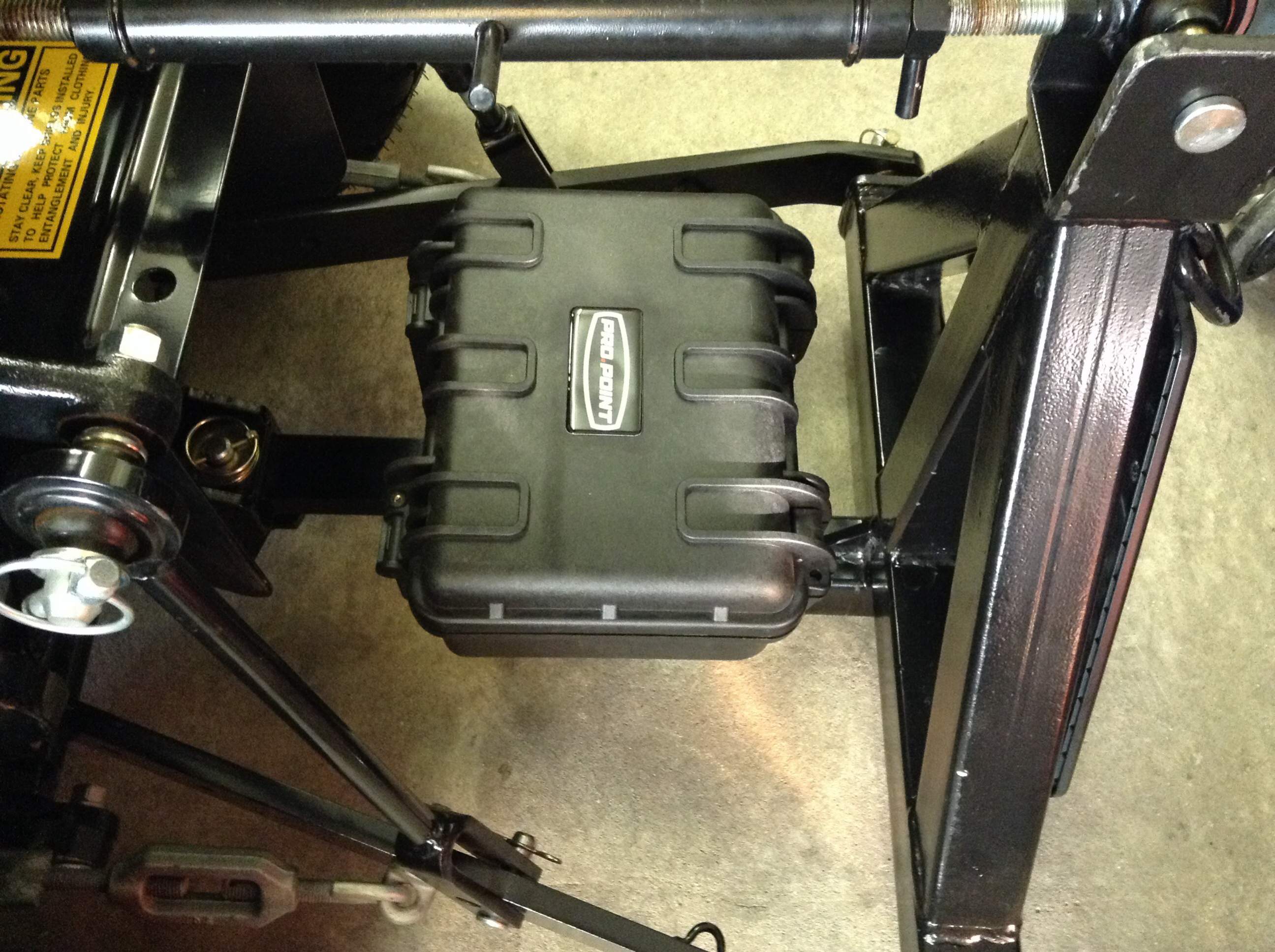

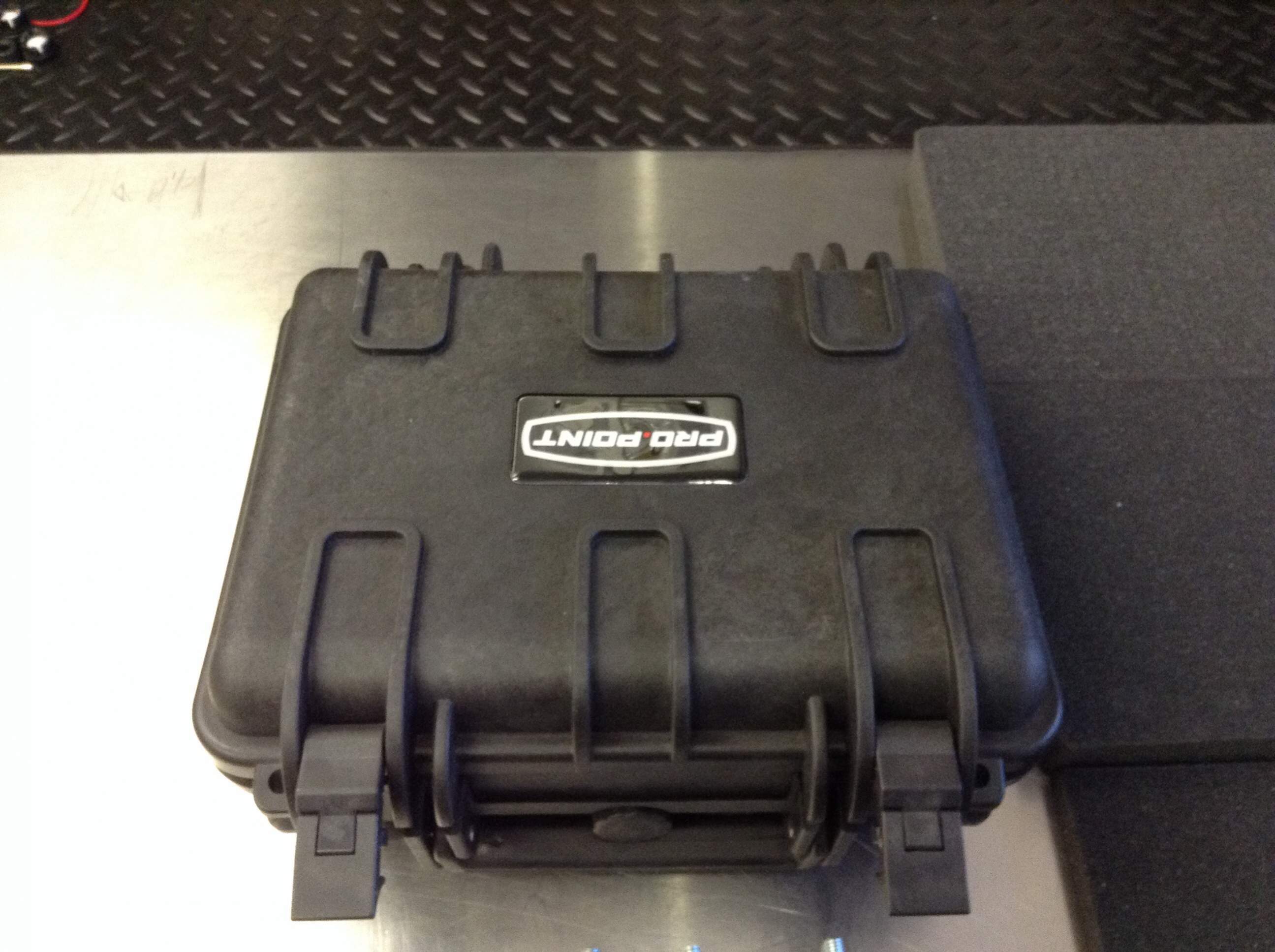

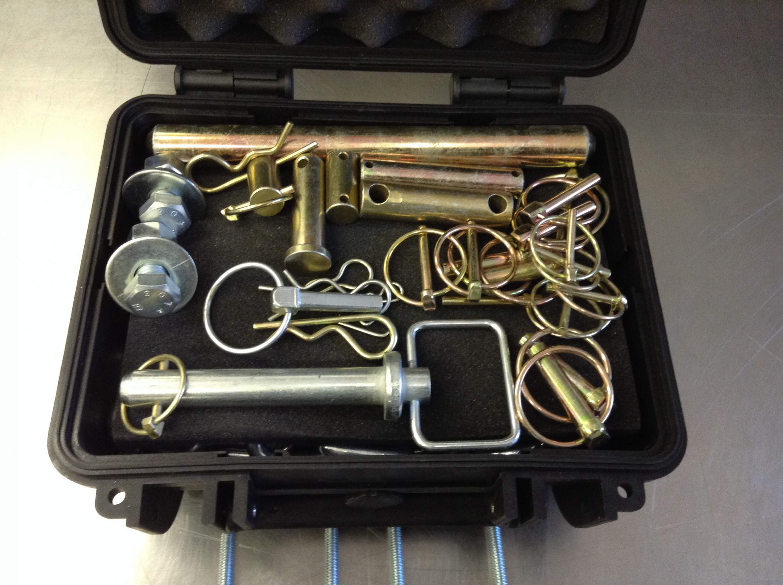

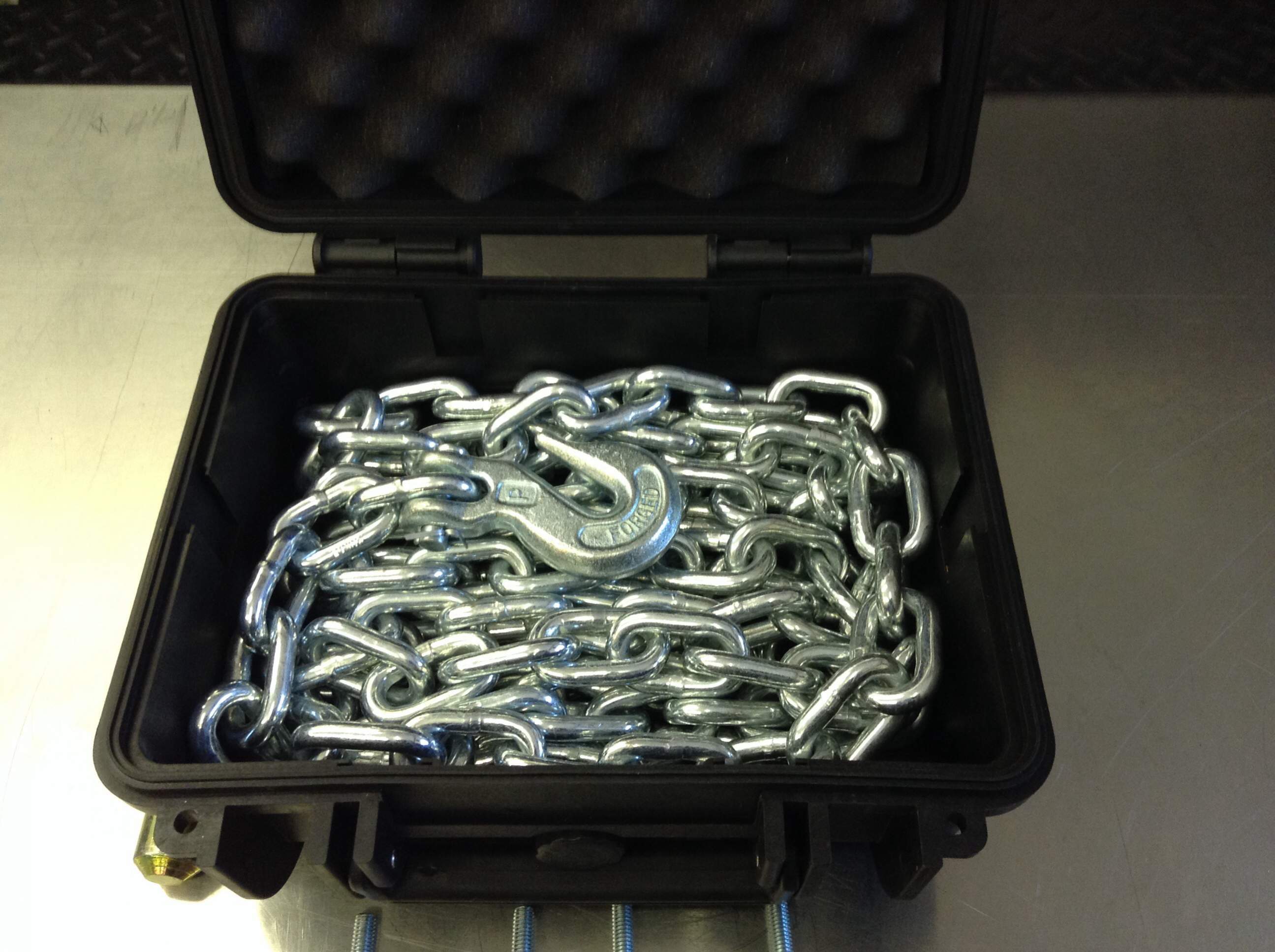

Here is another simple mod I did this morning... I found this impact resistant and waterproof storage box on sale($38) at Princess Auto. I don't have very much room on the Max25 so my solution which will work for me 98% of the time was to mount it on my drawbar. It clears all the 3point arms, holds my chain(3/8 x 14') and pins and clips and I still have room for other things if needed. I am guessing about 40#'s of weight without the drawbar. It removes with the drawbar and will stay on the tractor until I need the backhoe. Perfect storage solution that works for me and how I will use my tractor.

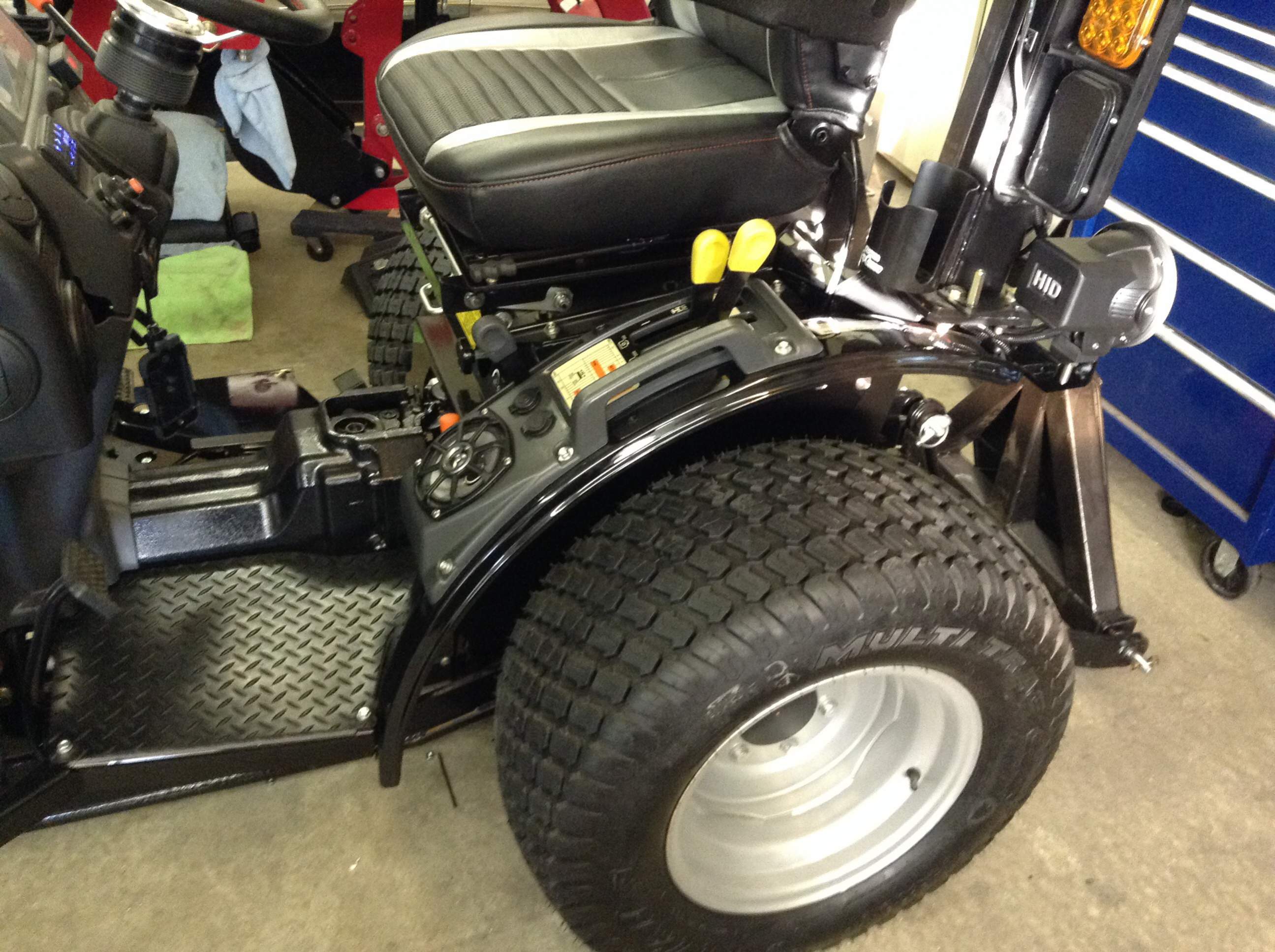

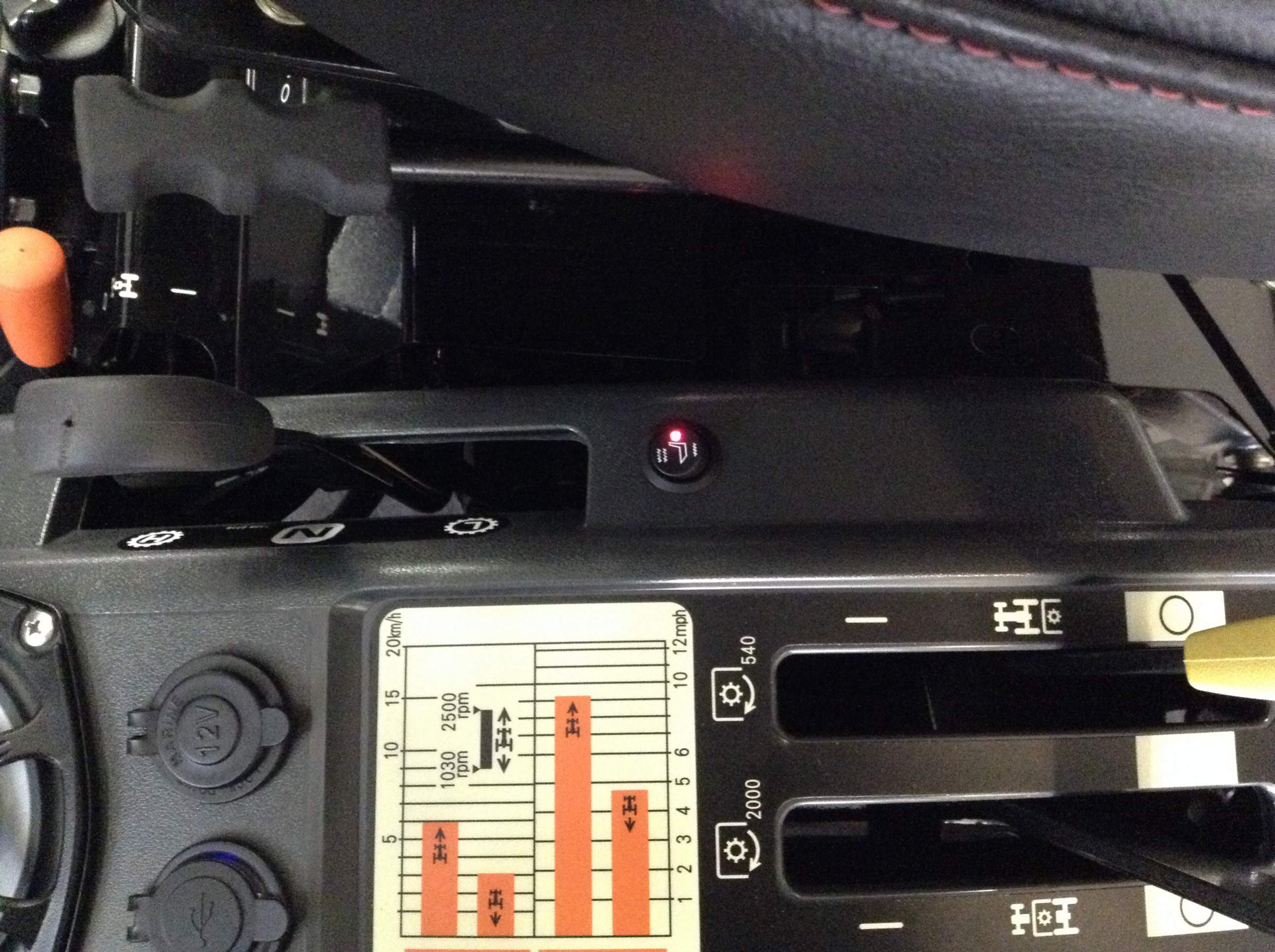

All I can say about this mod is.....Mmm...... Heated seat.... Finished wiring and mounted the High/Low/off switch, allowed me to finish one side of the tractor so here is the rear fender in black all back together. I painted the other fender Friday so when I finish my E-lock diff mod I will be very close to finishing the tractor.

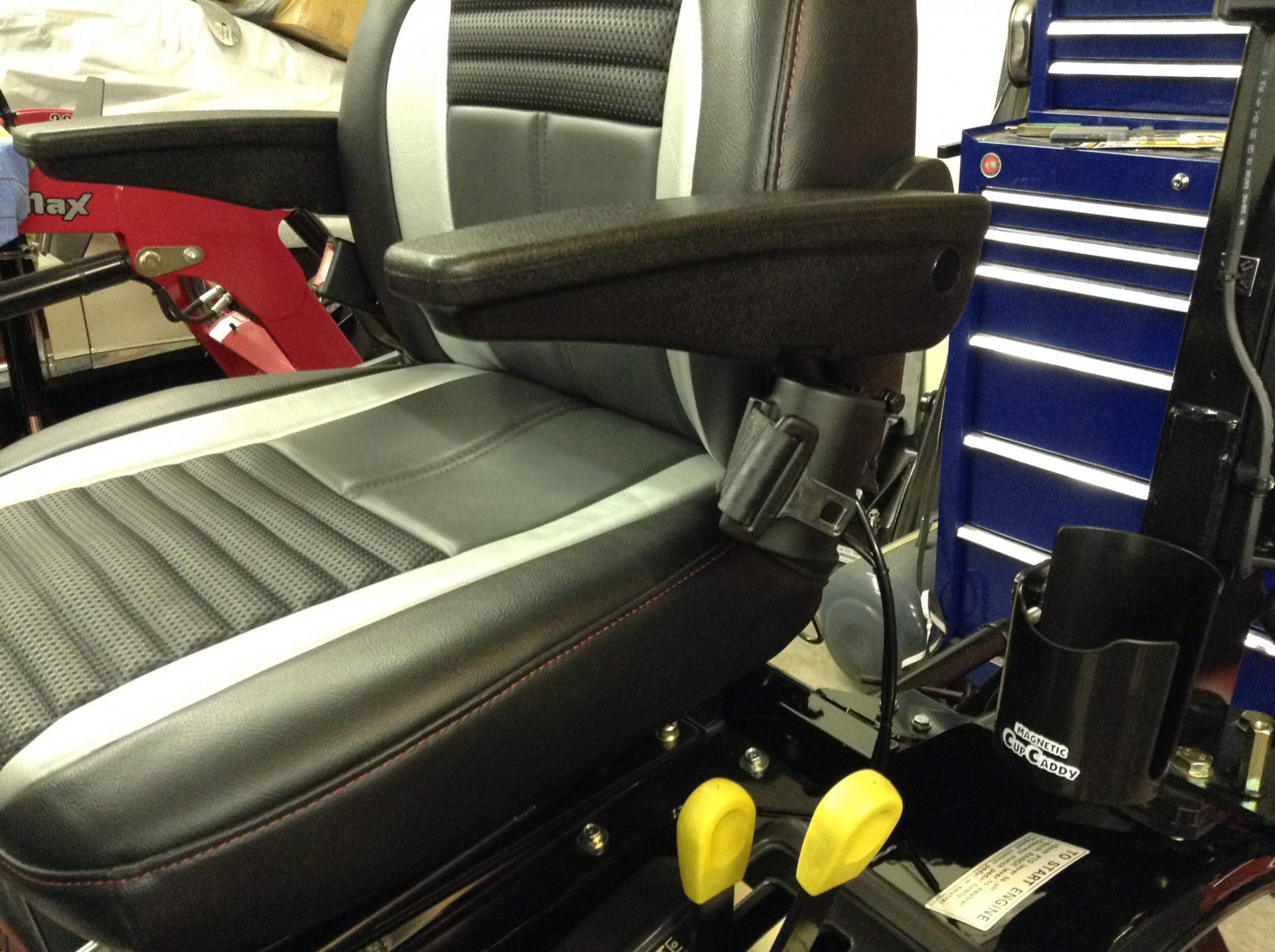

I was able to mount the retractable seat belts from my stock seat to my new seat today. I figured why reduce safety for a little added comfort... I had expected to have to change seats when I use the backhoe but it turns out the new seat, being bigger and having armrests and now with seat belts rotates around with good clearance. The only mod I had to do was trim one inch from the seat slider arm, it hit my PTO levers. It stuck out to far anyways... Now it looks better too. I can honestly say the seat was more work than I expected to mount, if I had a non backhoe Max25 seat and mount it would have been easier.
