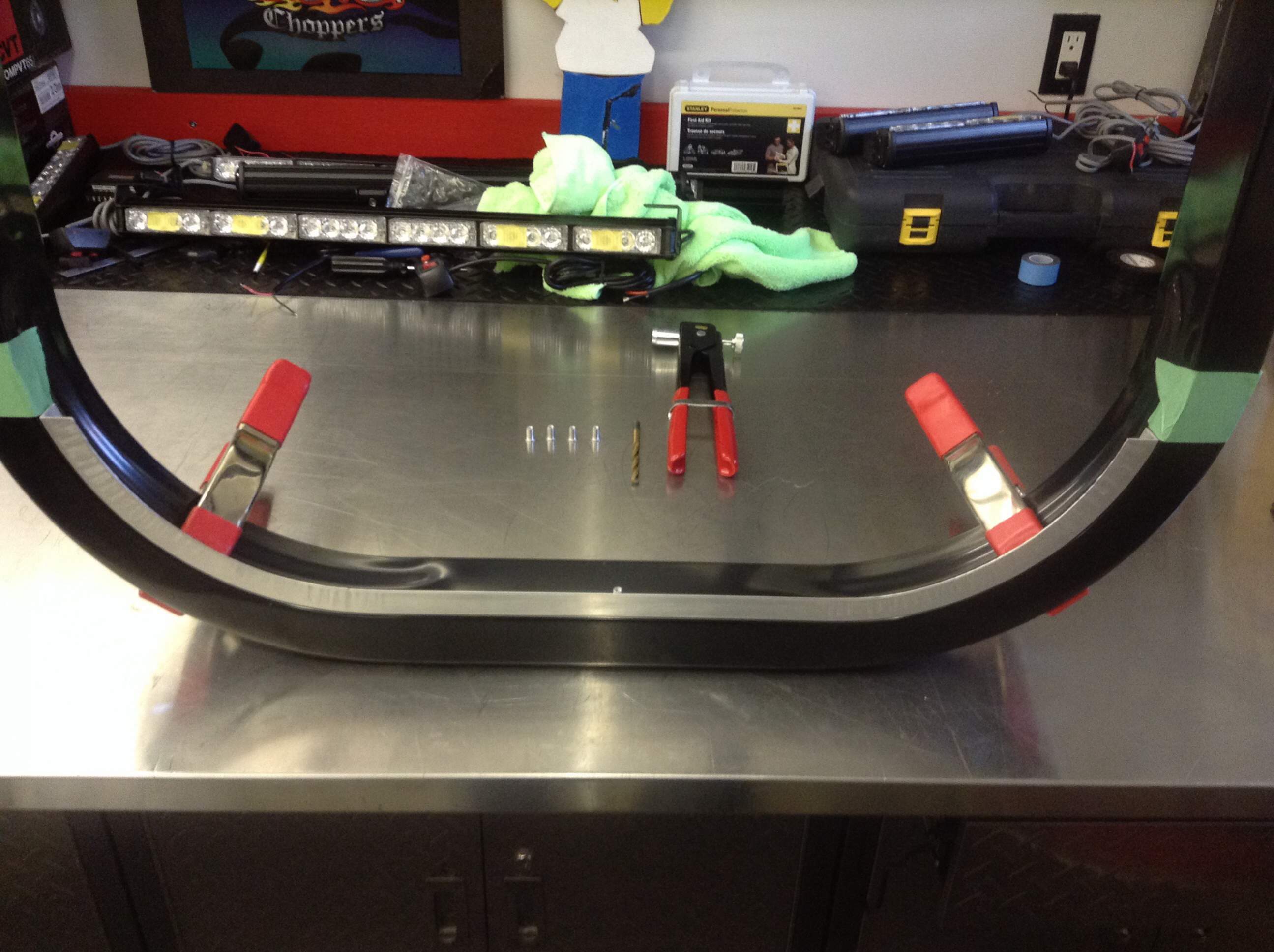

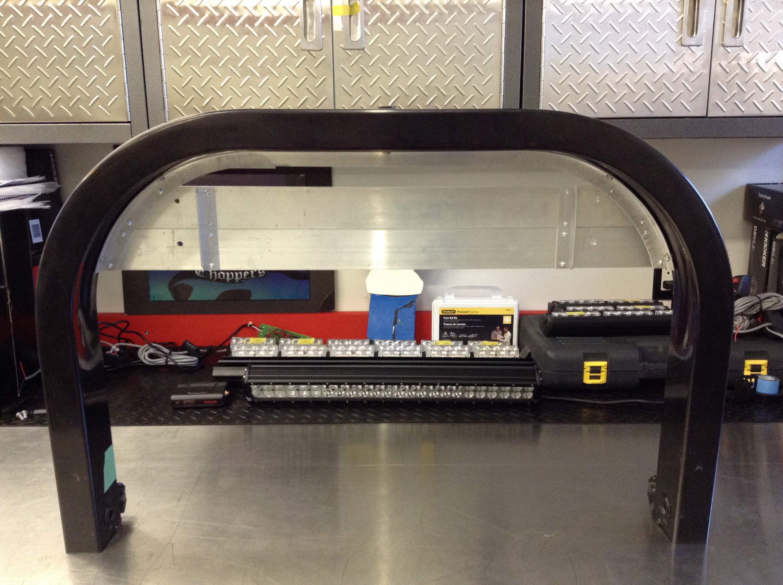

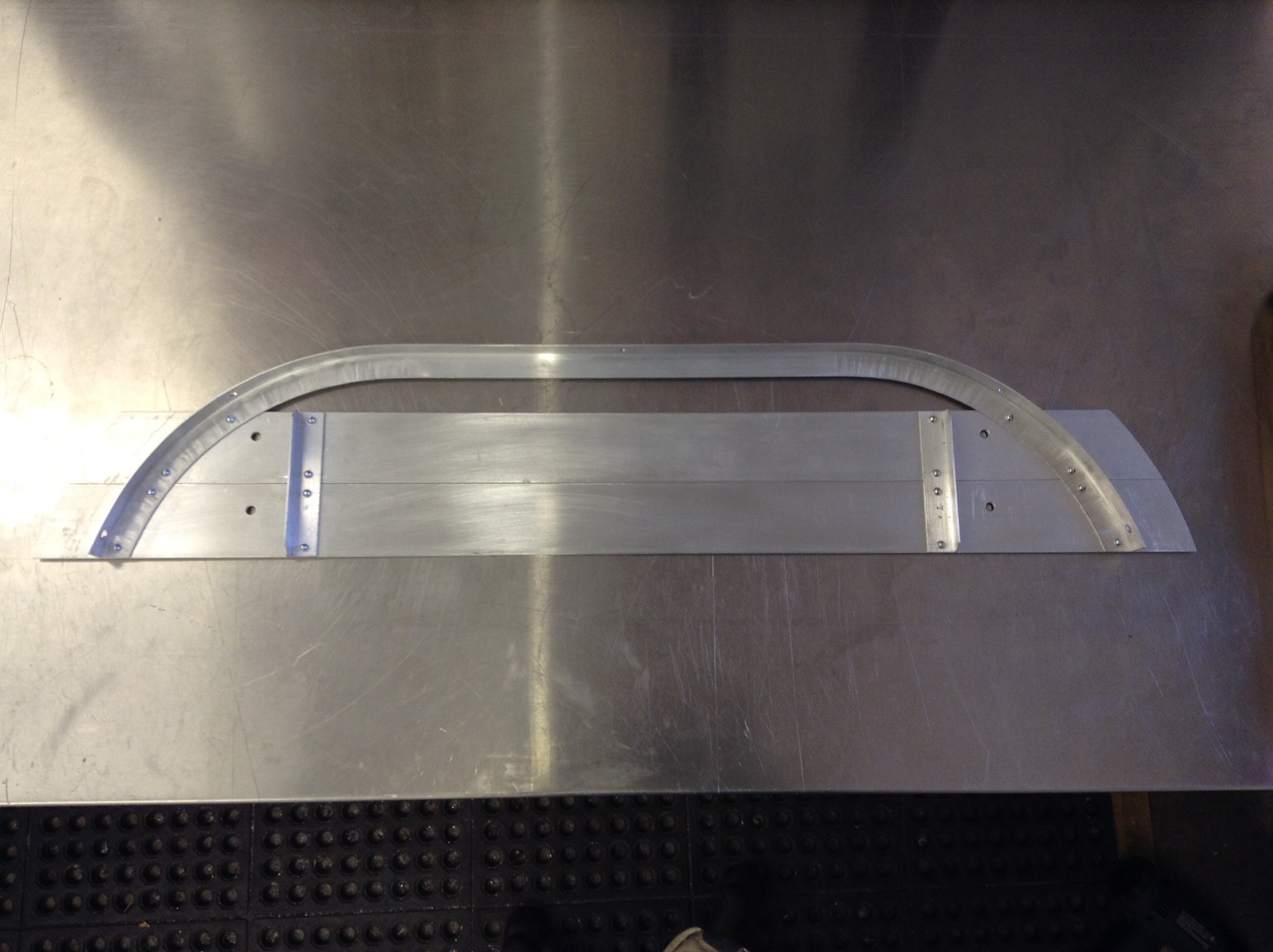

Here is what I decided to do with my light bar mounts, the lights themselves are pretty weighty so I needed something strong, but with a little stealth built in. I un- boxed my Princess Auto(equivalent to Harbour Freight) shrinker stretcher I bought about a year ago, assembled it, and made the curved piece. Took me about 3 hours on that piece, never having done it before, and I feel stupid cause I kept running over to the tractor and used a ladder to constantly check the progress/fit. Almost aerobic and the next morning it dawned on me to just unbolt the top of the ROPS and take it to the bench.... dummy. I will post a bench shot of the lights after the paint dries.
View attachment 404250View attachment 404251
Or perhaps you could have traced the radius on a piece of cardboard while still mounted on the tractor?

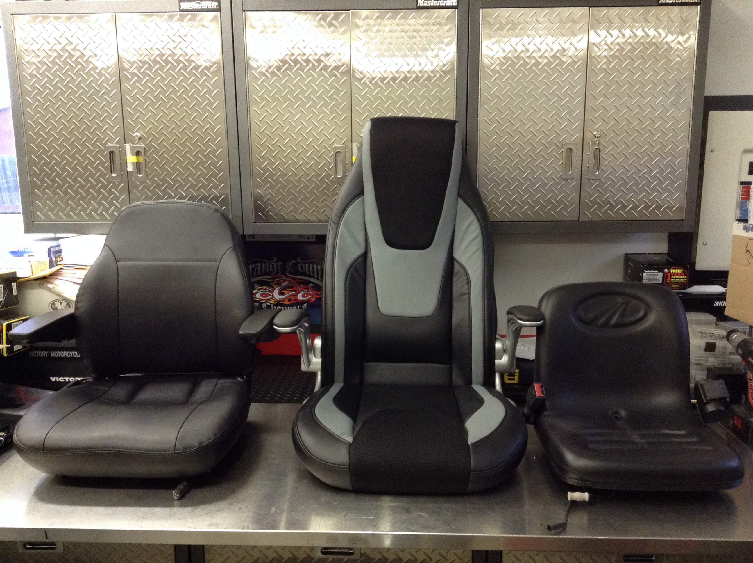

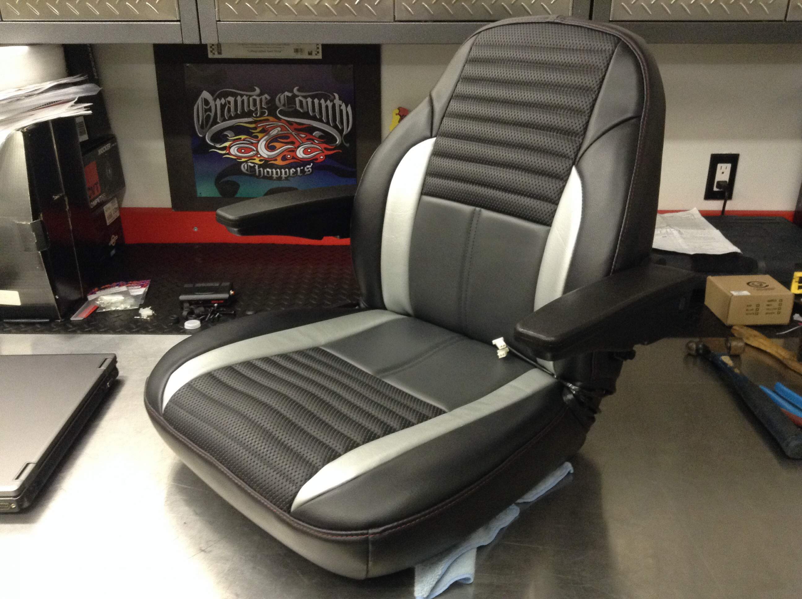

Well... Sometimes things don't work out. 1st time I received something made in China that was BIGGER than I expected, my office chair was huge !! Always have a backup plan I say, I now have a new "thinking" chair for my shop. The Xpress seat that comes with the MB60 backhoe is so tiny it creates problems trying to replace it. Most seats are just to big it seems. So I had to come up with a plan B, and it may have worked out better. I now gained adjustable armrests, lumbar, reclining and fold forward on the new seat, nice. It was boring to look at compared to the office chair, so I took advantage of having one of the best custom auto upholstery guys on the planet in my family. He took time for me as he normally works on high $$$ streetrods and we redid my seat, added seat heaters top and bottom as well. If you ever get a chance to see what's involved in making a custom interior grab it... It's an art form!! I have black carbon fibre, grey to match the dash, silver to go with the shape of the hood decal and wheels etc, and nine pleats top and bottom to represent my birth month(September). When you go custom you can pretty much have anything you want. We did it in a day, pretty decent result for a tractor seat...... Thanks Dad!!

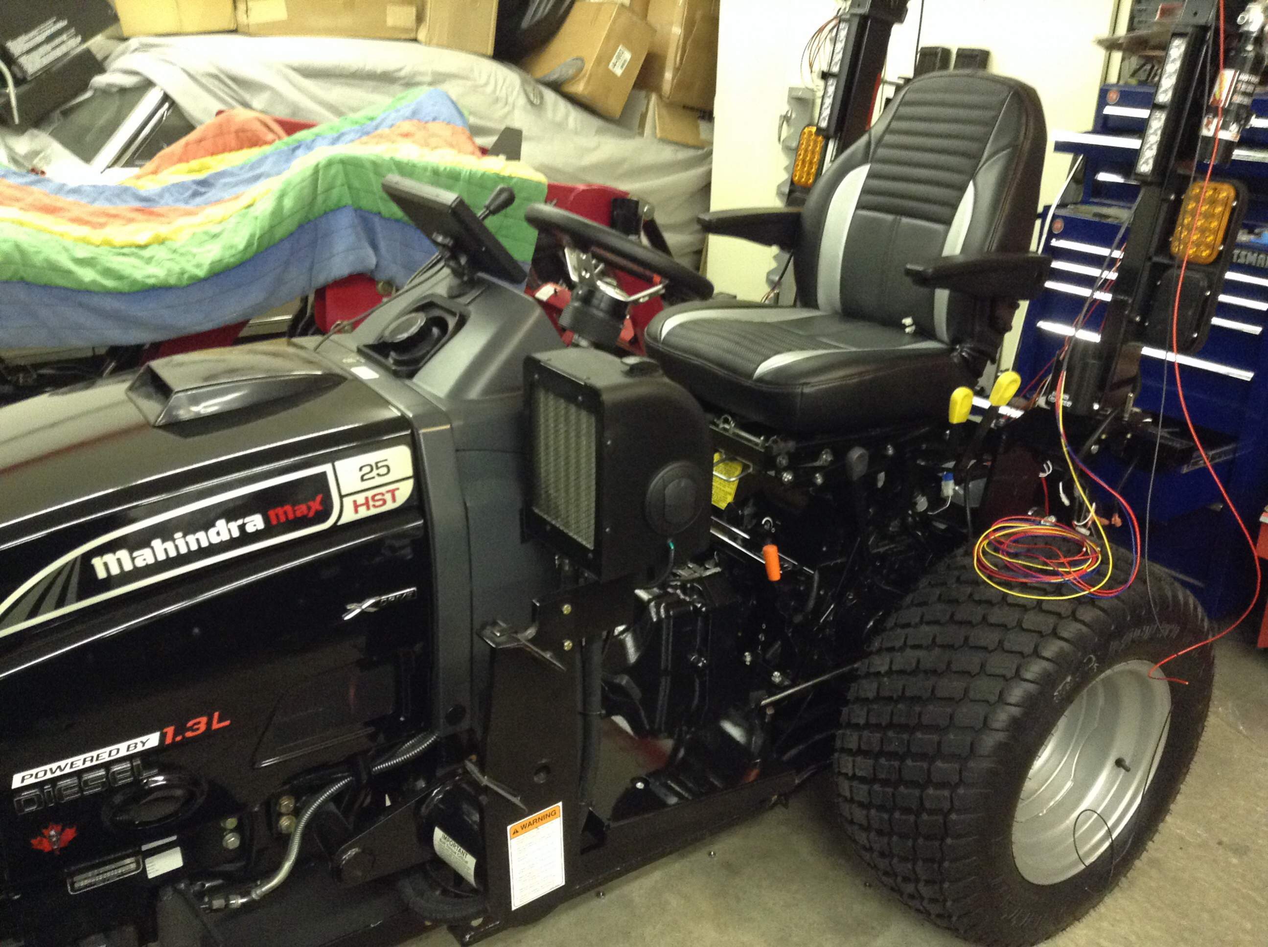

I decided LED and HID lighting would replace my stockers. Picture shows new light cluster, rear HID flood lights, and I installed LED reverse lights where the stock tail lights used to be. My new LED tail lamps have running/ brake lights in red so I fabricated two brackets with micro switches and used one with my treadle for automatic reverse lights, when I push reverse, reverse lights come on. For brake lights I used the linkage and other micro to have my brake lights always "on" when tractor is stopped, but when I go forward or reverse the brake lights dim to running lights. This was a really neat addition and example of how I took it to the Max, so to speak. <img src="http://www.tractorbynet.com/forums/files/mahindra-owning-operating/402115-takin-max-image-jpg"/>
I like how you incorporated the function of the brake lights with the linkage, and the reverse lights. Thx for sharing that.

No problem, I should explain that my brake lights come on whenever I take my foot off the treadle. It returns by use of a spring so technically it looks like my foot is "on" the brake as I begin to slow and the brake lights will stay on even when fully stopped. My actual brakes are not wired as by the time I take my foot off the treadle and actuate the brake my brake lights have already come on anyways. The HST is like an auto transmission so even when I actuate reverse it looks like I have my foot on the brake when i "shift" into reverse. My brake lights are timed so the reverse lights come on before the brake lights go out, an up-coming video will show/ explain it better. Reverse lights also automatically change my monitor to rear view, all this came from adding brake lights and and camera system, I figured it would enhance safety and allow me to use fully what I added to the tractor.
Understands perfectly. No video needed. I have HST and like how you incorporated it as I never use my brakes.

Wow that seat is beautiful! A work of art. I've been curious as to how you handled all your extra wiring. It seems to be something you have some expertise in, maybe a how to?
