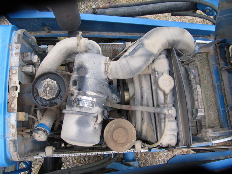

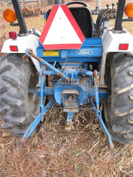

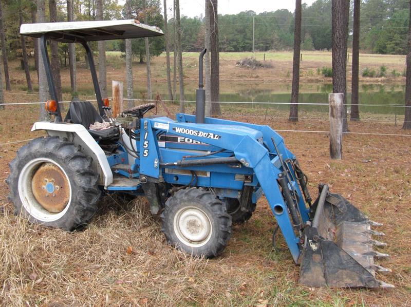

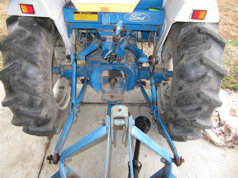

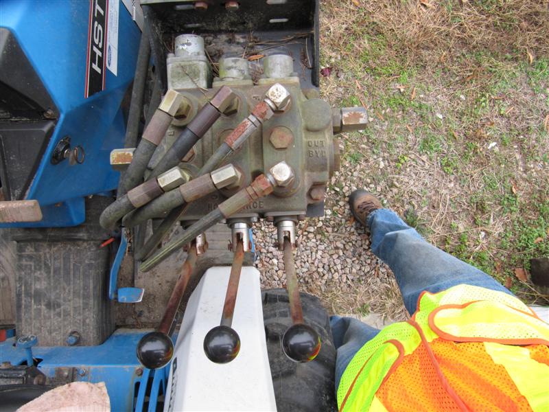

OH NO! :ashamed: I just realized I broke a major forum rule (well, at least it is on horse forums) -- pictures (before I wiped it down and blew out the pine needles):
1620 and Implements 16 Nov 13 013 (Medium).jpg1620 and Implements 16 Nov 13 002 (Medium).jpg1620 and Implements 16 Nov 13 003 (Medium).jpg1620 and Implements 16 Nov 13 009 (Medium).jpg1620 and Implements 16 Nov 13 010 (Medium).jpg
And yep, I was wearing my work safety vest -- it was the first day of rifle season for deer in our area and I work for a wildlife agency, I know who's out there. I AM NOT A DEER JUST BECAUSE I MOVE. :eek:
   / Taking In Used Tractor -- What To Care For First? #27
... Oil is black as midnight...
If this is a diesel...?...
I didn't see anyone else mention that this is quite normal for diesels...so it does not necessarily mean the oil has not "ever" been changes...as long as there's not water in it it's nothing...

Thanks on the chainsaws! They are GREAT!
To use the diff lock bring the wheels to full stop and then press the pedal, and use it in straight line forward or reverse, NOT turning. It really helps getting unstuck.
