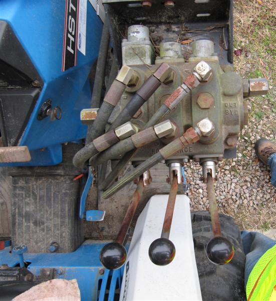

Oh, I do have a pic of the FEL levers -- on another thread, someone told me if there was a canister behind one of the levers, it had draft control, but manual is unclear. I tried raising FEL all the way, then pushing 1st lever all the way forward and letting go. It just stopped, no magic. 1620 and Implements 16 Nov 13 010 (Medium).jpg
I think you mean float? If it has that, the lever to lift the bucket should "stick" in the "lower" position, but the "sticking" mechanism might be stuck in the "non-stick" position. :D
If you can get a picture of the make/model/serial number on the valve someone can probbaly dig up a manufacturers spec sheet which will say what features it should have.

Yeah, I was wondering if you, OP, were referring to 'draft,' which is a 3PH lever control for the rear of the tractor, or float which is the FEL position which puts the bucket into 'float' over the ground surface, rather than being set in one position rigidly like when you lower the bucket to the ground, it stays at the position you lowered it to, UNLESS you have it in float...
The way 'float' is engaged is to lower the bucket with the FEL level and then stick the lever as far forward as it will go, WITHOUT forcing it, and it should stay in that position, sort of 'stuck' forward into a detent like setting, until you pull back on the FEL lever to release float. Don't try it with the bucket raise completely- it's designed to work for ground contact so the bucket will 'float' and drag over topsoil, for instance, while backdragging. I hear tell one can float going forward too, but I've never been able to get it to work for my tractor?!:confused2::confused3:
