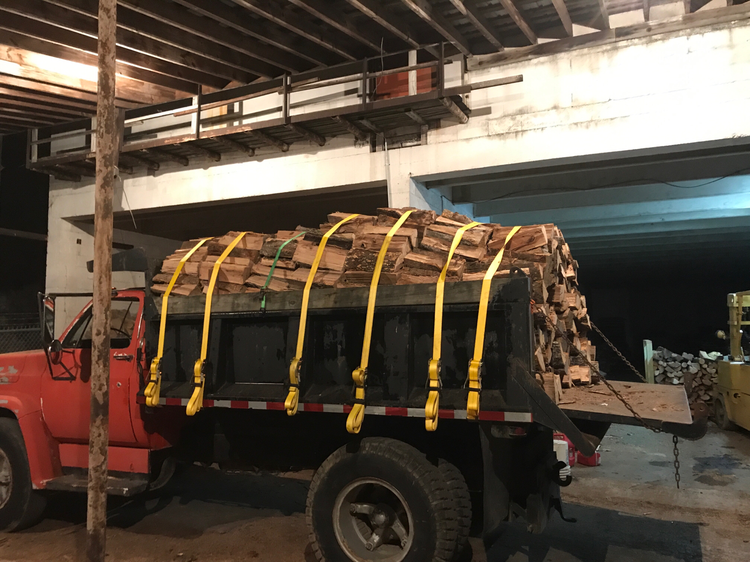

They might not actually fit 10 tons of dirt but they’ll haul 10 tons of gravel. Here’s 6 rick of firewood on one. IMG_0468.JPG

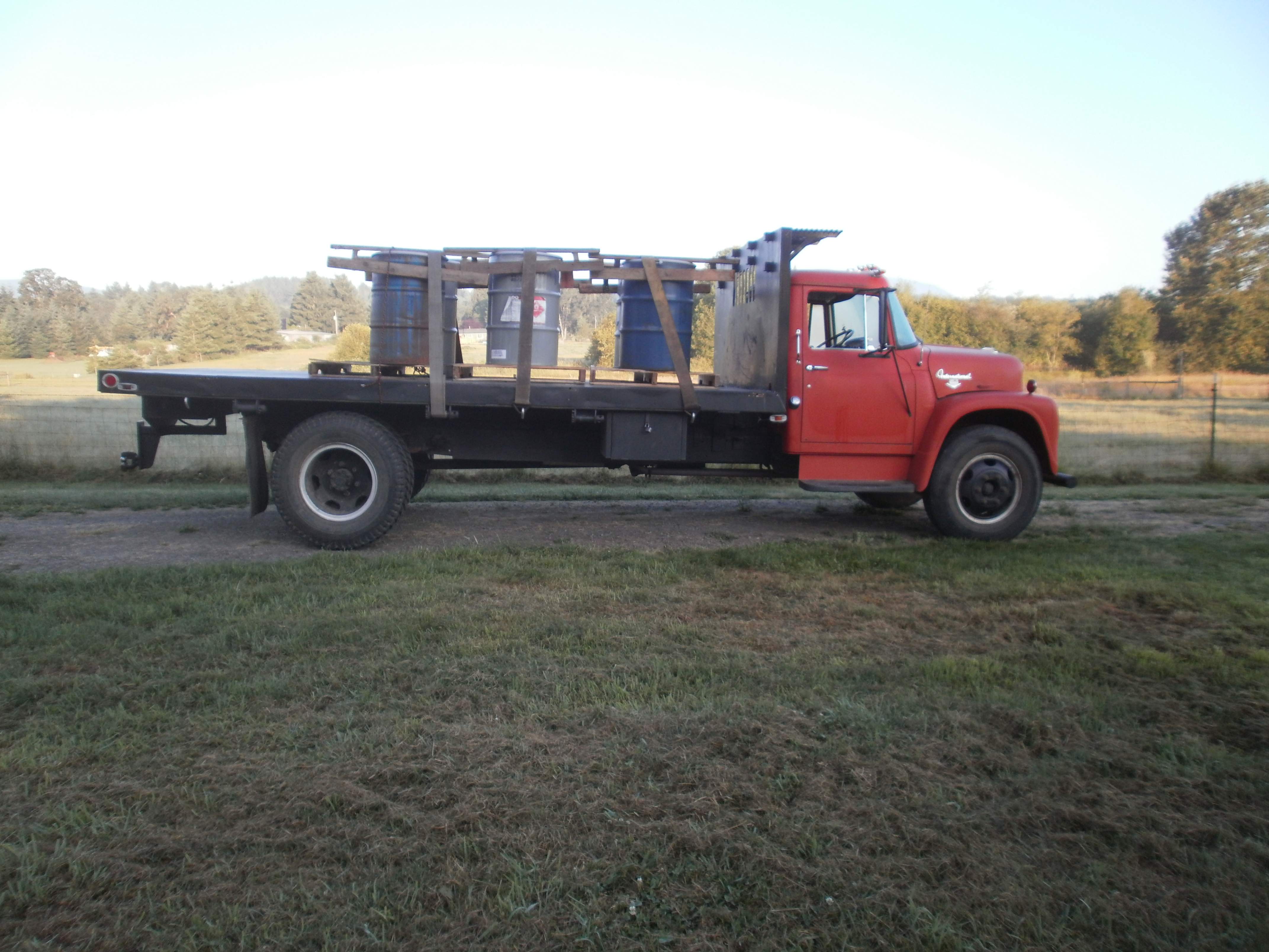

1967 Loadstar with a sixteen foot steel bed, scissor hoist, single ram. It is pretty convertible, I have a huge box I bolt on to it, or five foot side boards, or one foot sideboards.
345, five and two. Not the fastest but the gears are the key. I haul five six yards of rock, equipment, raw logs for firewood or saw milling. I used to keep it licensed for 28K, it weighs 11,500 or less empty. Oregon ag plates are legit for me, not too costly.
Die hard ol truck, I've had it forty years. It would be nice to have a similar truck with diesel and power steering, but it still works, runs down the road, stops, and gets a thumbs up when they pass me by.
