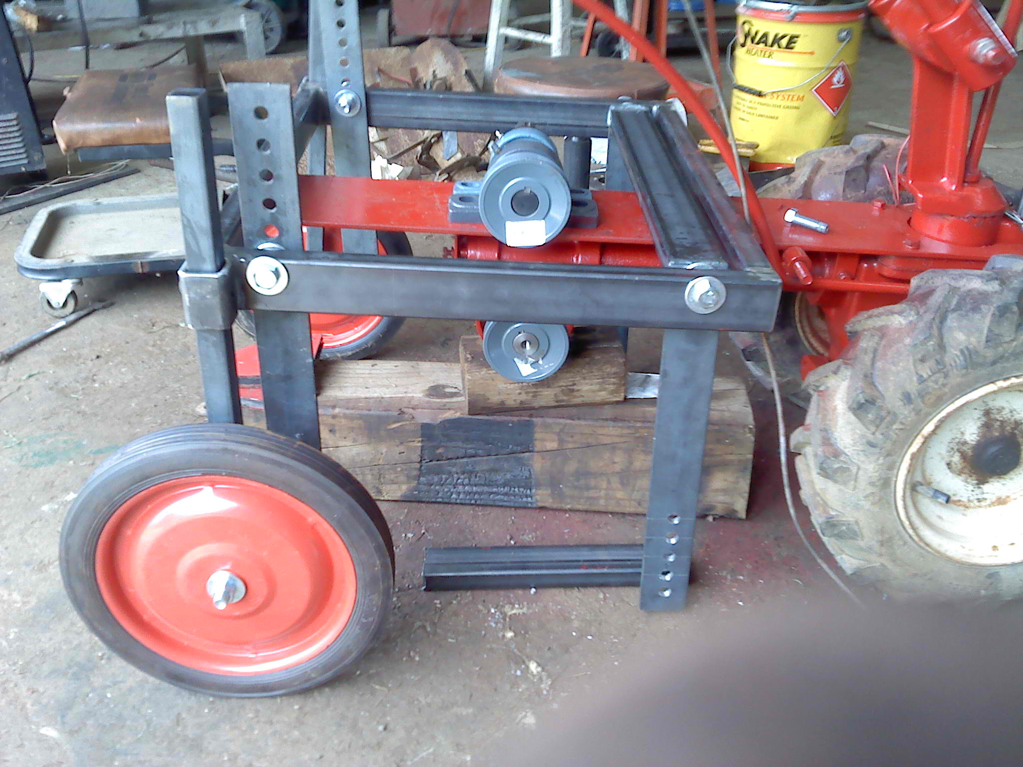

Got a little work done on the picker. To many honey do's to get it finished, but I'm close.
I used a piece of 6 x1/4 plate to make a mounting point for the digger frame. I cut it and drilled it so that it bolted on top of the transmission and runs all the way to the back of the tiller where it is also bolted in the original holes. I had to extend it beyond the end of the tiller so it would be long enough to mount the digger frame on.
The wheels are mounted on a 1x1 sq bar. This I will drill several adjustment holes so I can adjust digging depth. I am thinking about welding a piece of angle across the top of the wheel posts and using a piece of allthread rod to make height adjustment just a turn of a screw.
The swing arms have several holes 1in apart and the digger plate has 3 holes each side drilled 2in apart. this should give me plenty of adjustment. I suspect the swing arms will be longer than needed, but I will cut them off later after testing it out. I Made the frame out of 1x2 11ga tube. Its 24in wide by 18in long.
Engine is a new Predator, 6.5hp from Harbor Freight. Well one site says its 6.5hp and another calls it a 7hp, anyway it should work. So far i have about $250 in this build, but thats because I have been buying all new steel and the engine cost just over $100, machine work was another $50. I still have to source a pulley for the engine, but Its pretty close to being finished and I dont see any other major expenses.
I am done working on it for this wk, probably finish it up next wk and be ready for a test run.
