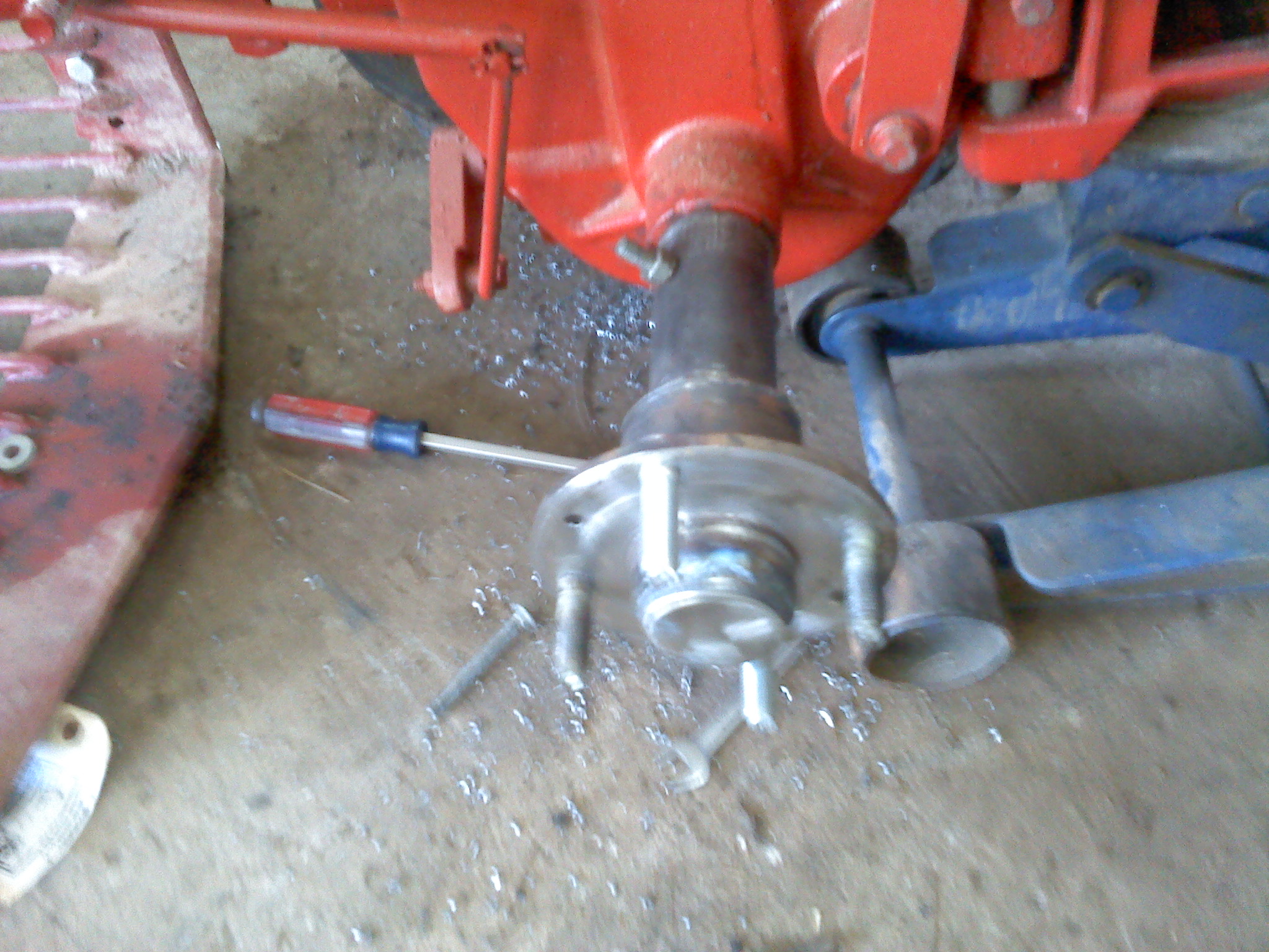

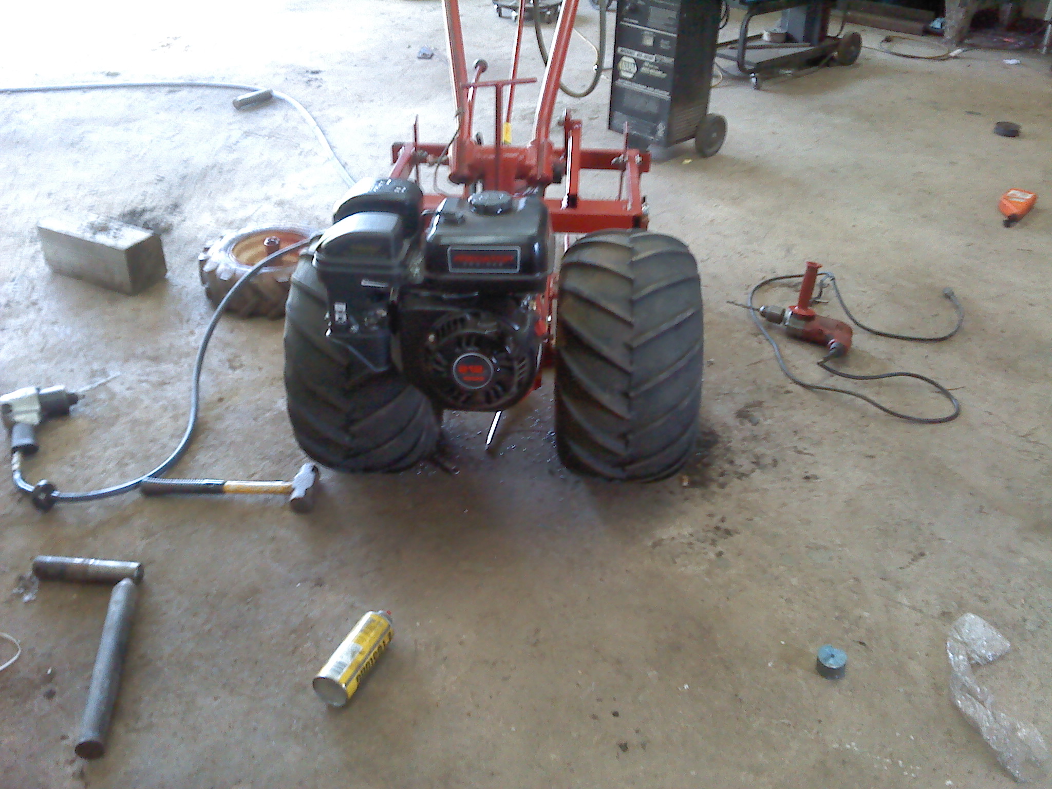

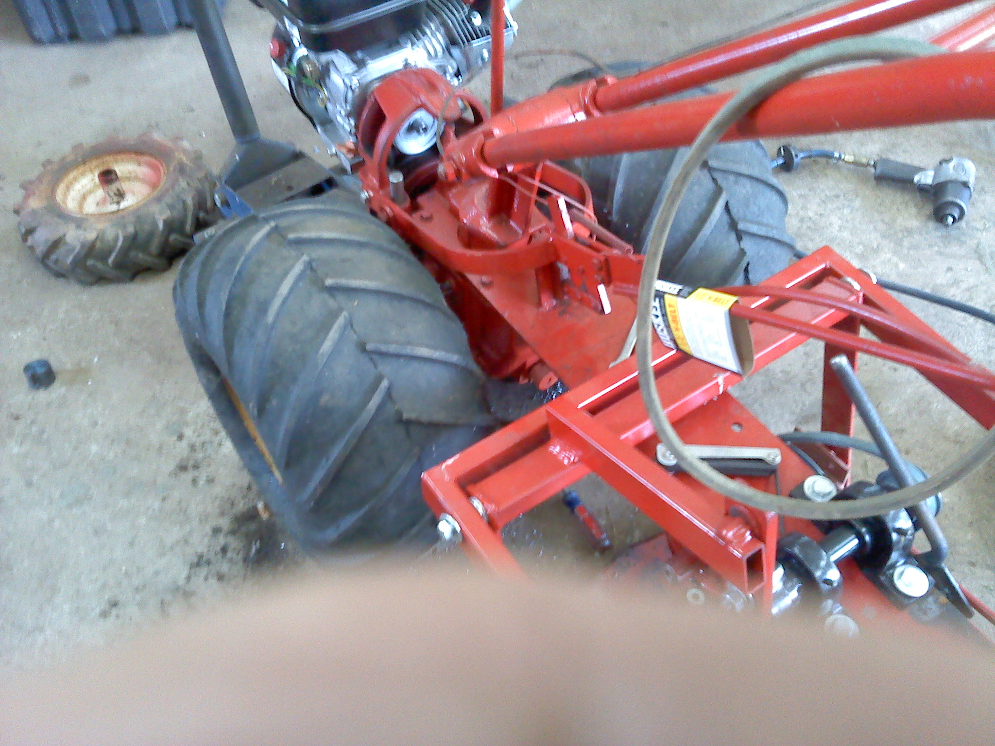

Got back to the digger build this wk. I had some old Steiner tractor tires laying around not being used, Just had to figure out how to mount them. The axle shaft out of the troybuilt tiller is 1in, the Stiener uses 4lug hubs. these hubs just happen to have the same bolt pattern as a couple of old hubs I had on the shelf. I took a piece of 1 7/8 shaft material, bored the center to 1 india to fit over the troybuilt axle shafts. I then turned the outside dia down to fit inside the 4lug hubs. A little welding, trueup the flange face on the lathe, and I now have big tires on the troybuilt.
Having a little slippage problem with the belt tensioner, I think I made the tensioner pulley mount a little to flimsy, it twists and lets the belt fly off. Still got a little tweaking to do, but my roundtoit seems to wander toward other projects
