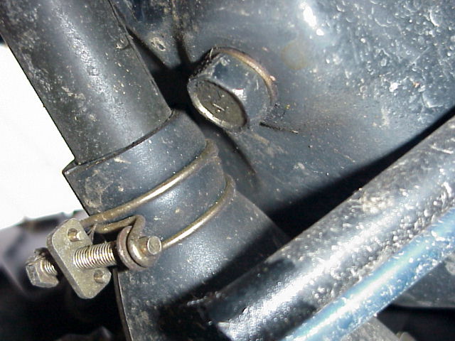

Re: TC 24D with hole in the oil pan more pictures
4 of 6.

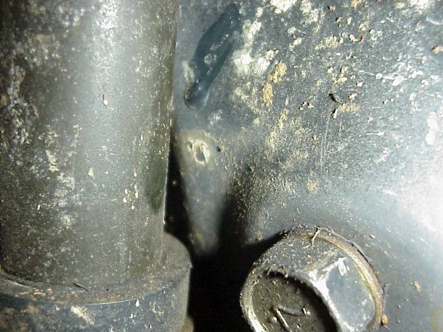

5 of 6.

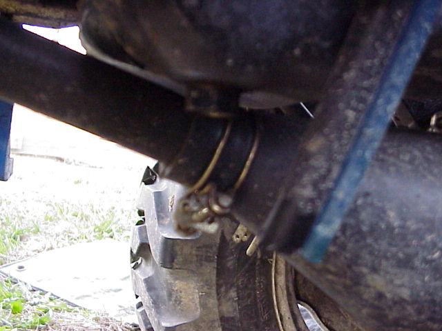

Wow, that takes awhile over dial-up. Now I remember why I usually upload pictures from work /forums/images/graemlins/smile.gif
Anyway, here is the last one. A close-up shot of the pan. You can see some mud & grease spots but no sign of anything hitting it.
