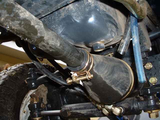

George,
FYI, I just looked at my sleeve and oil pan and took a couple of pics for you to compare. My TC24 was purchased in September, not sure of the manufacture date, if that matters.
There is no flat spots on the sleeve and the oil pan has a definite indent to accomodate the shaft. Did your sleeve pull out of the boot or did the whole boot come off the axle? We all might want to give the clamp a little torque as the boot ages?
Hope things are coming together for you.
Brad

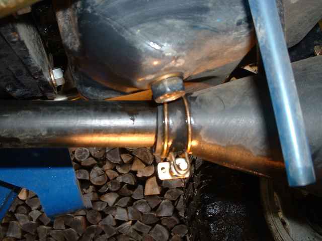

Another view

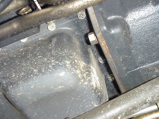

One more - keep us posted

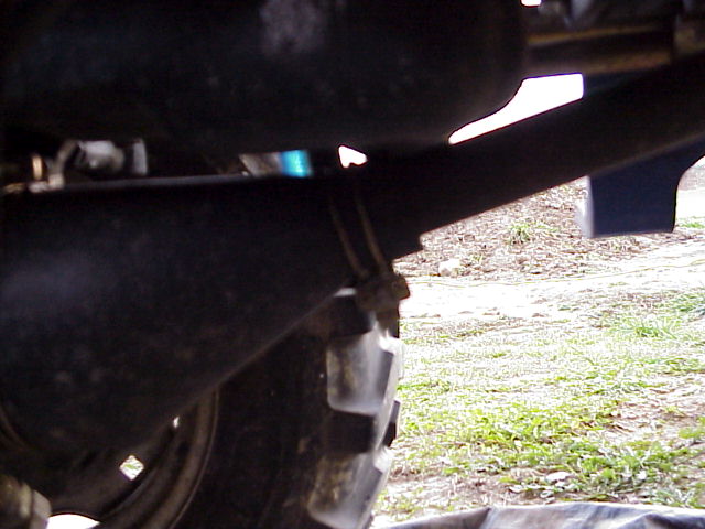

Sorry it took so long. I took some Monday when I got home from work, but it was too dark and they turned out really bad. I was able to get some yesterday. I didn't see any flat spots on the sleeve. Here are a few pictures. Mine looks different than Brads.
Here is 1 of 6.

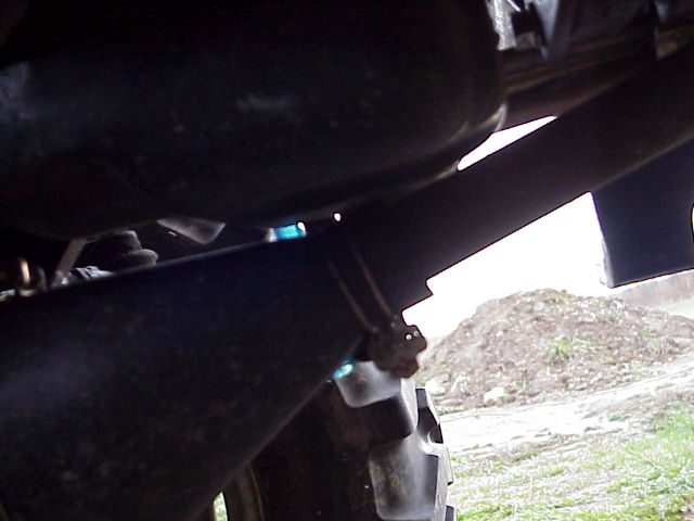

2 of 6.
Just went back and looked at Brad's again. Looks like they've redone the oil pan for the newer ones. I would see if they could put the new pan on your tractor.

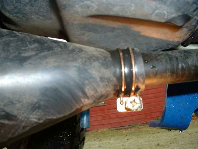

3 of 6.
