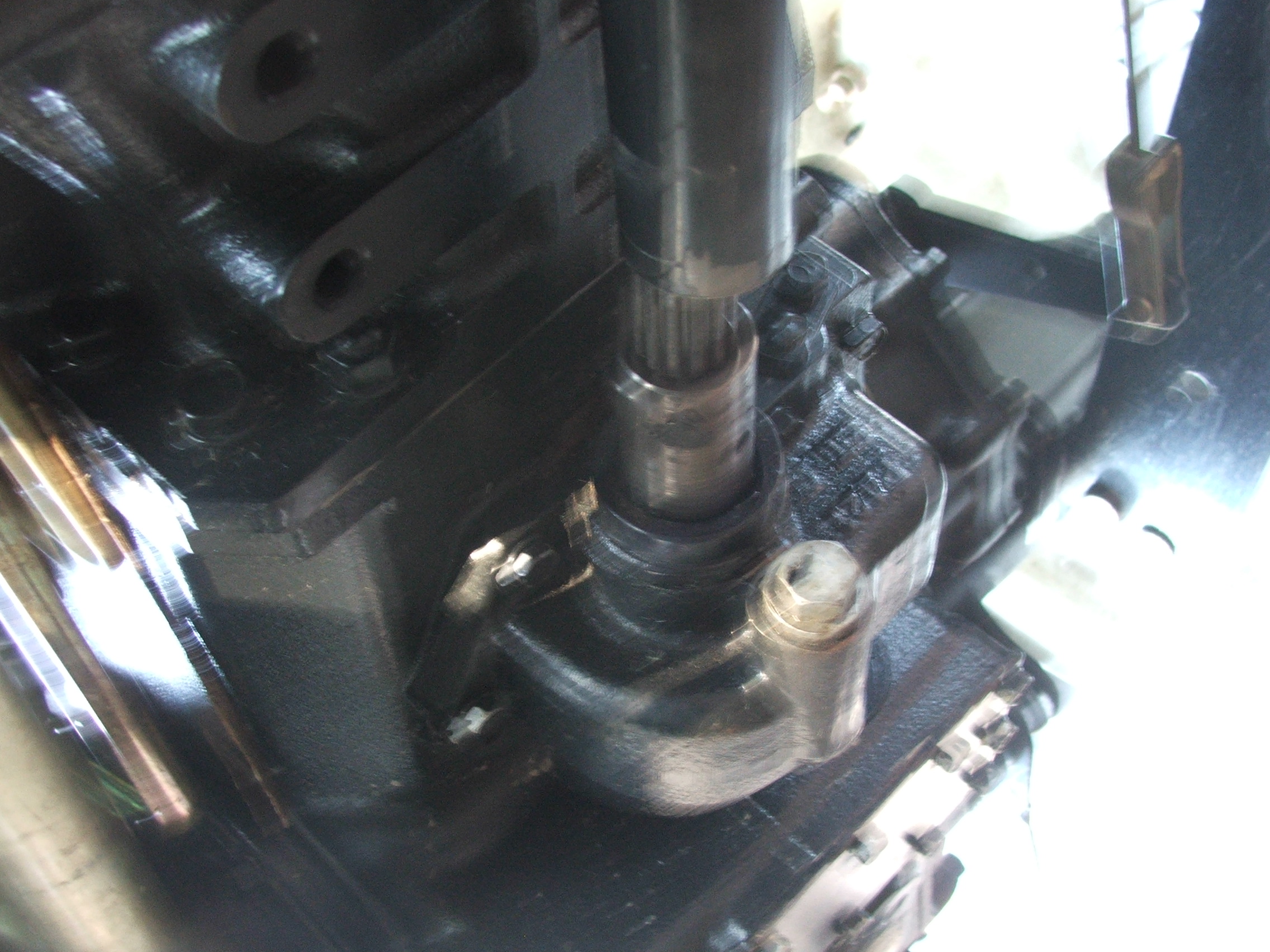

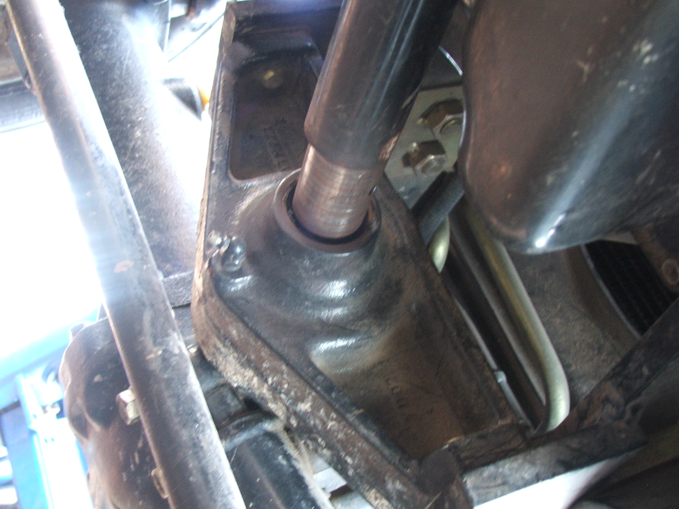

Tractor friends,
One of my old threads. Finally got around to taking closer look at tube that protects my drive shaft. Tube is bent and dinged and creates awful metal to metal sounds that I have endured for 75 hrs of tractor operation. Time to fix. Procrastination is one of my strengths.
I dropped the sleeve off the aft portion of the shaft going into the rear gear box. Looks like I will have to drop the shaft to,as well, to remove the tube for straightening. Any advisories. thanks
