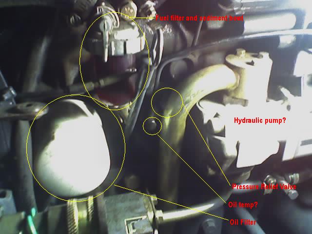

Tonight after the kids were in bed I got some time to work on the tractor. I've attached a few pictures. All I had with me was the cell phone, so pardon the quality.
It took me a while to find the oil pressure relief valve, even though I had pictures of where it was supposed to be. I finally took off the FEL, and that made life a lot easier.

OK, on to the oil pressure relief valve. As you can see from the attached picture, it well behind quite a few things. At a minimum, it looks like I'll have to detach what looks like an oil temperature line, remove the dipstick, and remove the fuel filter and sediment bulb. I'll probably have to remove the oil filter as well, which will probably mean draining at least some of the oil.
I tried to get a crow's foot back there, but my biggest (22mm) wouldn't fit on the bolt. I'd love to be able to remove what looks like the main hydraulic line, but something tells me I'd likely make a mess doing that. True?

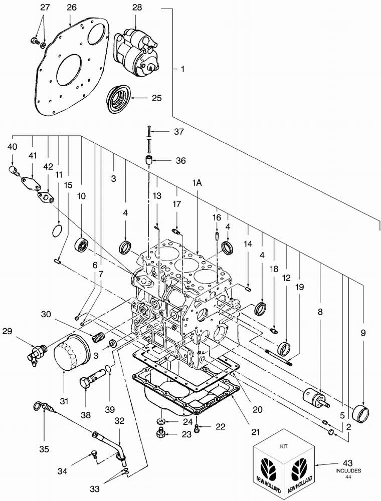

Are you sure that's the relief valve? I'm not saying it is not, but I see something else in your picture that looks more like the relief valve. It's below and slightly to the right of your oil filter. Don't know...just lookin' over your shoulder.:)

jinman said:
Well, I went back and looked at the NH diagram on the website and I think you are correct. I'm attaching the diagram with the relief valve being item number 38.
Darn! I posted the wrong diagram! To make it worse, I can't delete that last post because only a few of TBN's buttons work on this machine. Don't know why...I can't even edit a message. I know how...the buttons are just dead. They all work on my computer at work, so I'm sure it's a problem here only.????
see new attachment...

I got a couple more to work correctly by setting all my security settings to default (from high) and disabling my ad blocker, but I still can't get the formatting buttons to work. (Tools --> Internet Options --> Security)
If that isn't the pressure relief valve, then I don't know where it is. I was looking at the same picture you posted. I'll take a better picture later on today. Found my camera.

That bolt you see below and to the right of the filter holds the hydraulic diverter valve in place. (At least I think that's what it is called). Large hydraulic line running to it, small ones going away from it.
