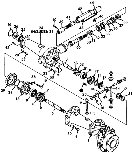

Hi all, I have 2001 TC40D. I was moving dirt this weekend had it 4wd went to pickup dirt with the loader, as I was going forward to pickup the dirt I felt a pop in the front end. Now about 5ft the front tires lock up and not a good sound coming from the front chunk. I can back up a little and move forward again for another 5ft tire lockup again. It sounds like something has broke off in the front diff. The 4wd lever is moving more easier now since this has happened.

Class III New Hollands have developed the nasty habit of shearing the bolts holding the ring gear to the front differential carrier. Not what you wanted to hear, but it's probably what you will find. Your first operational test didn't force the front ring/pinion to turn; the second test did and produced lockup. If you dig into it yourself, you should get the proper info from a NH repair manual one way or the other.

The same thing happened to my TC40D a couple of years ago. The dealer got NH to repair it under warranty even though the warranty had expired. He found some of the ring gear bolts, or what was left of them, in the bottom of the axle housing. There was one that had backed half out and was the only thing holding the ring gear on. They stated that the lock washers were missing and the front end had obviously been misbuilt which is why NH covered the repair.

My TC35DA made that nasty pop sound once too. I think they have the same drive train? If not they're similar. My problem was the spider gears in the front differential chipped a tooth or two off and they would get stuck after a little rotation.
You have to watch your turns when your on a hard surface when your bucket is loaded. I try to make 99% of turns like that on dirt or grass now.
See attached diagram part #17 for the gears (this is for a TC35DA). I replaced the gears myself (dealer gave me the parts) in a couple of hours and it wasn't too hard to do.

I split the front end the differential housing had 7 broke bolts there was only 1left. I could easily take it out with a socket. I got all the broken bolts out and there was thread mark inside the housing telling me they have been coming lose for a while. On the only bolt left that I took out had about 15 degree angle on the head telling me again the bolt were backing out.
It looks like I need all 8 bolts plus housing. I think new holland should take care of this that to me is a defect.
