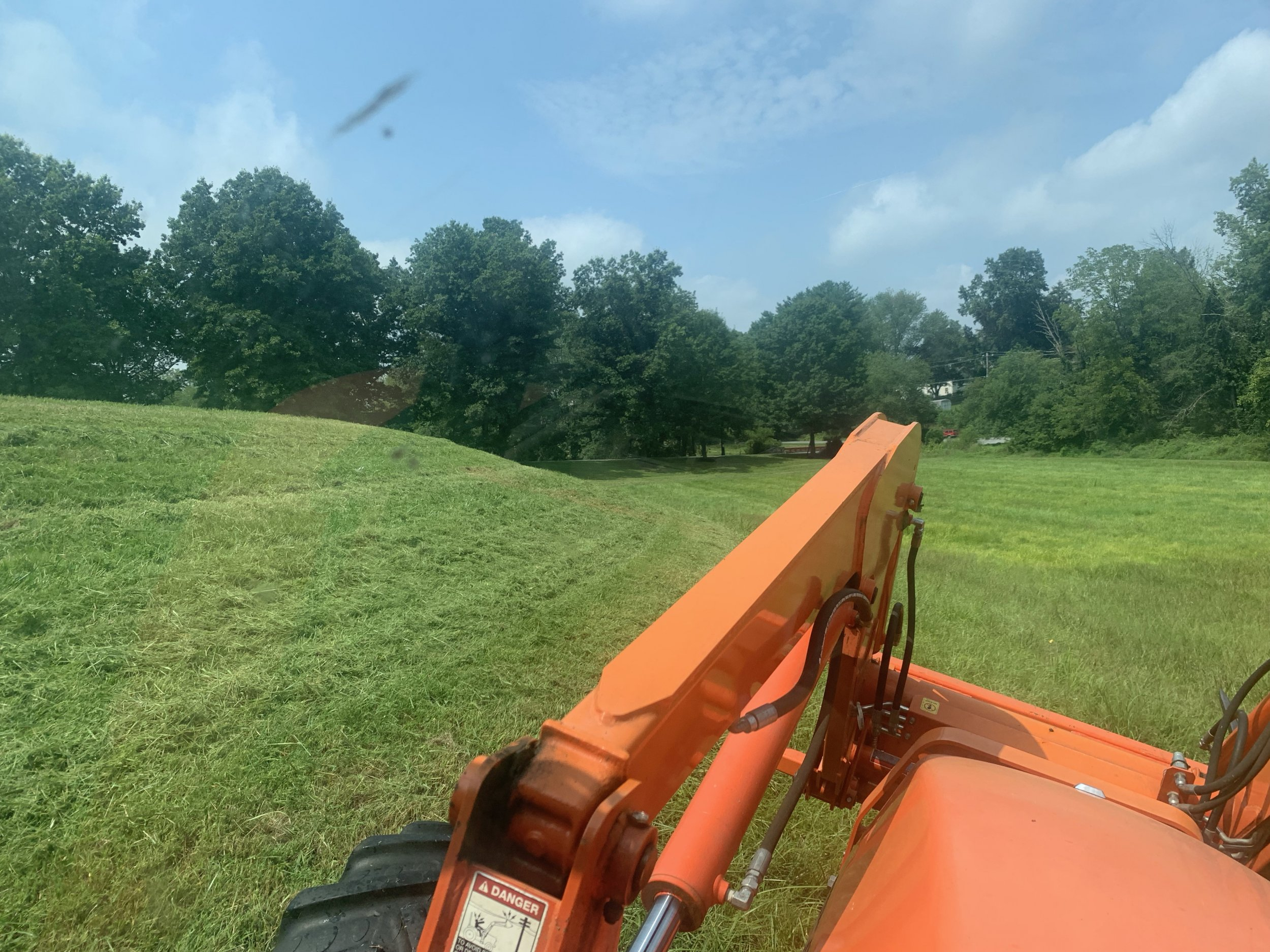

Heres a very steep incline I cut (retention basin) and it’s pretty scary, but I found the tractor will slide slightly before it tips.
Its funny how pictures never quite show how steep it is.

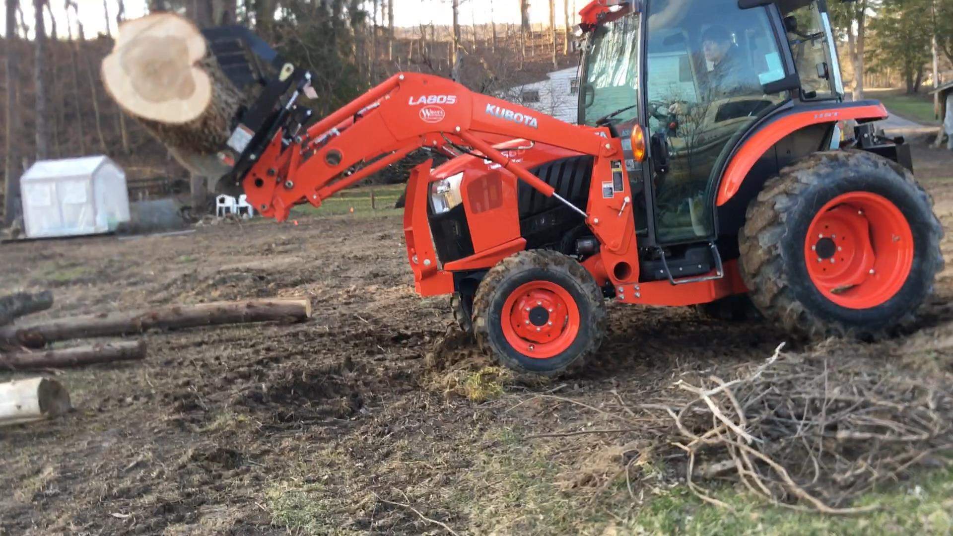

Quick story from a beginner:
I had used the Grapple to pick up an 800 to 1200 lb 12ft log from a trailer and was backing up and making a 100% full turn at the same time in reverse - while on a relatively gentle slope.
I was angled about 45 degrees off of center sideways on the hill when this happened. I was moving too fast, I stopped too fast while moving backwards into a depression I didn't see, the load was way to high, no Ballast other than filled tires, and my wheels were turned up the hill as I was backing down the hill, adding to the narrower stance of the front end of the tractor and less resistance to roll.
The downhill right rear tire hit a small indentation in the ground... not a hole.
What is that law of physics? "A body in motion will stay in motion until it is acted upon by an opposite force?"
The momentum of that load up high, held tightly in the grapple, my speed backing up, the 3" deep dip that I didn't know was there (that I was about to sink into), along with my angle on the slight grade. All of that acted together in swift and calculated measure to lift the left side of the tractor both front and rear. But I had no idea...
It was a perfect storm of things NOT to do.
It felt floaty and then this feeling in my head as my equilibrium started to tell me something was terribly awry. I glanced out the left side window only to see the ground starting to drop away, my foot was still on the treadle, I was still moving in reverse.
I had no idea what to do in this 1, maybe 2 seconds that seemed like an eternity - it was like I was stuck on the upside on the teeter totter at the playground with absolutely NOBODY on the opposite down side. One way or another, I was going to drop, that was certain.
I felt a bump as the rear tire began to climb up the opposite side of the shallow depression and only then did I realize I needed to hit the loader valve forward as hard and as fast as I could to drop that load. I slammed the knob forward with my right hand as my left hand flailed around the Cab for something, anything to grab a hold of!
It worked as the log slammed into the ground still in the grapple. I had hit the loader valve forward hard enough that it went into float and instantly dropped. That instant drop, and the rise out of the depression pulled the front end back down followed by the left rear.
After cleaning up myself, I realized something. I had been instantly "edumacated" on a number of things the most important being that weight is not always a positive thing... its very fluid, very dynamic as it's moving and unstable in many many circumstances. It can work against you as much as for you.
Time will tell. I have good respect for things that aren't always under our ability to control, or when we shave too much of a safety factor down either knowingly or unknowingly.
I used to Hang Glide, and I will never forget the first time the seat of that glider actually picked me up and my legs were no longer on the ground. It was at that point that I instantly realized that my movement through space and time just expanded to another level, another dimension of up and down. That dimension was much more fluid than simply bending down, standing up, or jumping. It was a dimension that I either had to come to grips with very quickly or face the consequences.
With Hang Gliding its all about not ever getting close to a situation where you need to take action to prevent something crazy from happening. Preemptive actions are much better than emergency actions because there is usually more time to make them.
I wont ever forget looking out that left side window and seeing the ground drop away from me while my hands were looking for something, anything to hold onto, just as I will not forget the feel of that hang glider seat pulling me up into the sky on that first flight experience where I actually grabbed some real air.
Cheers !!

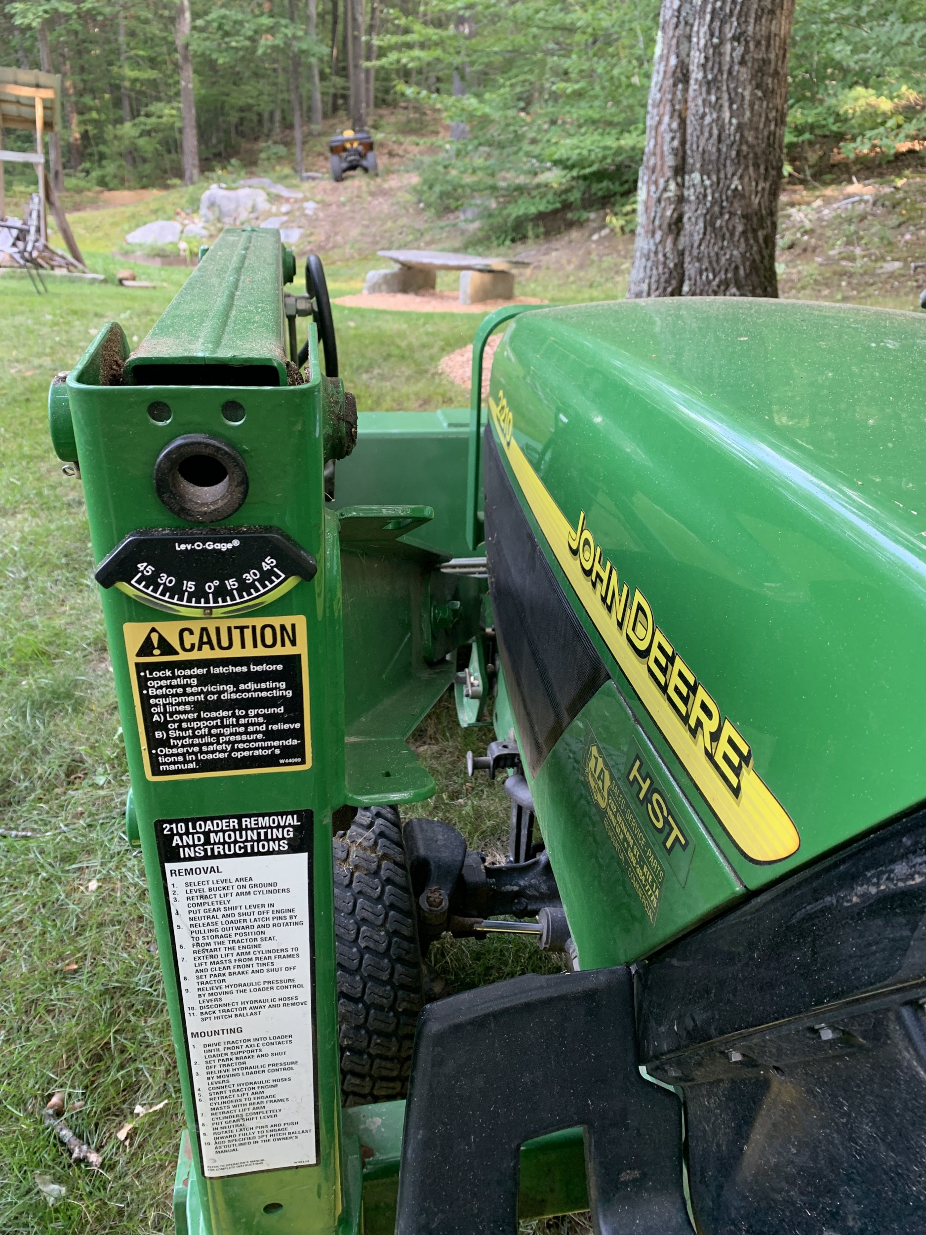

I had no idea that this topic would become such a hotly debated issue. I put one of these inclinometers on the 4600 and another one on the 2210. I have found that my limit of comfort is at 15 degrees, and seeing the reading is very helpful to me, because sometimes I get nervous even at 10 degrees when the rear tire goes over a rock, and so this helps to calm things down for me.
   / Terrified of tipping - how about an inclinometer? #149
That is unjustifiably timid. I hasten to add that EVERY driver has to establish his own levels of comfort and far be it from me to "tell you what to do." That said, 15 degrees is silly for a limit with the tractors you mention and most/all normal utility and compact tractors. I'm talking WITHOUT the rear wheels out to the max and WITHOUT rear wheel spacers, etc. I used a JD 4700 mechanically the same as your 4600 on rough and hilly ground. No problem going across 45% slopes (approx. 24 degrees) if fairly smooth. Up and down 50% slopes many, many times where cattle paths made the ground very rough, etc. I did have my wheels set out to most of the available adjustment width. If you are as timid as your post suggests, for heavens sake put the wheels out as wide as they will go and relax. Ten degrees is not even a reasonable threshold for concern with the wheels in to the narrowest possible setting on any tractor sold today.
And as has been said somewhere in the 148 prior posts --- looking at some meter is not what you need to be doing if you are in any chance whatsoever of tipping or feeling tippy.
p.s. I do like your inclinometer size, readability and location.
