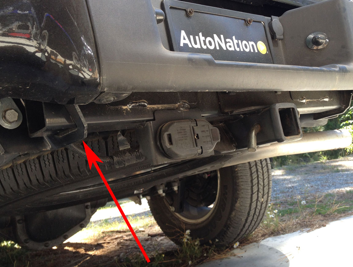

This looks like a weld defect to me. The arrow is where the joint is improperly joined, and the red line is tracing what looks to be a crack or pull starting where the weld is not properly tied together. If it is not a crack, there will eventually be one there I suspect. The weld will start to crack at the weakest point...and that is the weakest point from what it looks like.
I was thinking I saw the same thing....but figured my screen was playing tricks on my eyes.
Speaking of trailer hitches and roadways,,,,
Mark you have an eagle's eye - in real life it looks even more like a crack! But this (OEM Ford trailer hitch) has only pulled 3,000lbs on dump runs, for 10 miles, and below speeds of 30mph (truck is new, 3 weeks old). I thought it was interesting to note almost zero penetration. Jim I''ll probably weld it on 2nd side but still thinking whether I should go back to the dealer with it. One thing about this joint, its good weldment design, it's a good weld to crack, if that makes any sense.
I bet it was welded with a 240 volt machine, but that doesn't mean it was set hot enough!
