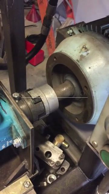

Only proper way to tell is put as pressure/flow test on it. Think of it this way, with absolutely no backpressure, i.e. oil being pumped into a bucket, you could have 10 gpm flow. Put a bit of back pressure on it, 2-600 psi and the flow could drop to almost zero as there'd be leakage past the gears, end caps etc.
Best way is get a flowmeter when the pump is on the tractor or, take it to a shop that has one and can run it on a bench..............Mike

Typically the charge would be $85 in our shop. We'd rather test pumps right on equipment to determine other problems if warranted (air entrainment, cavitation, worn splines, bad relief valves ect)
We are very selective when it comes to testing pumps cuz we don't want to contaminate the oil in the test bench in a case of a trashed pump
