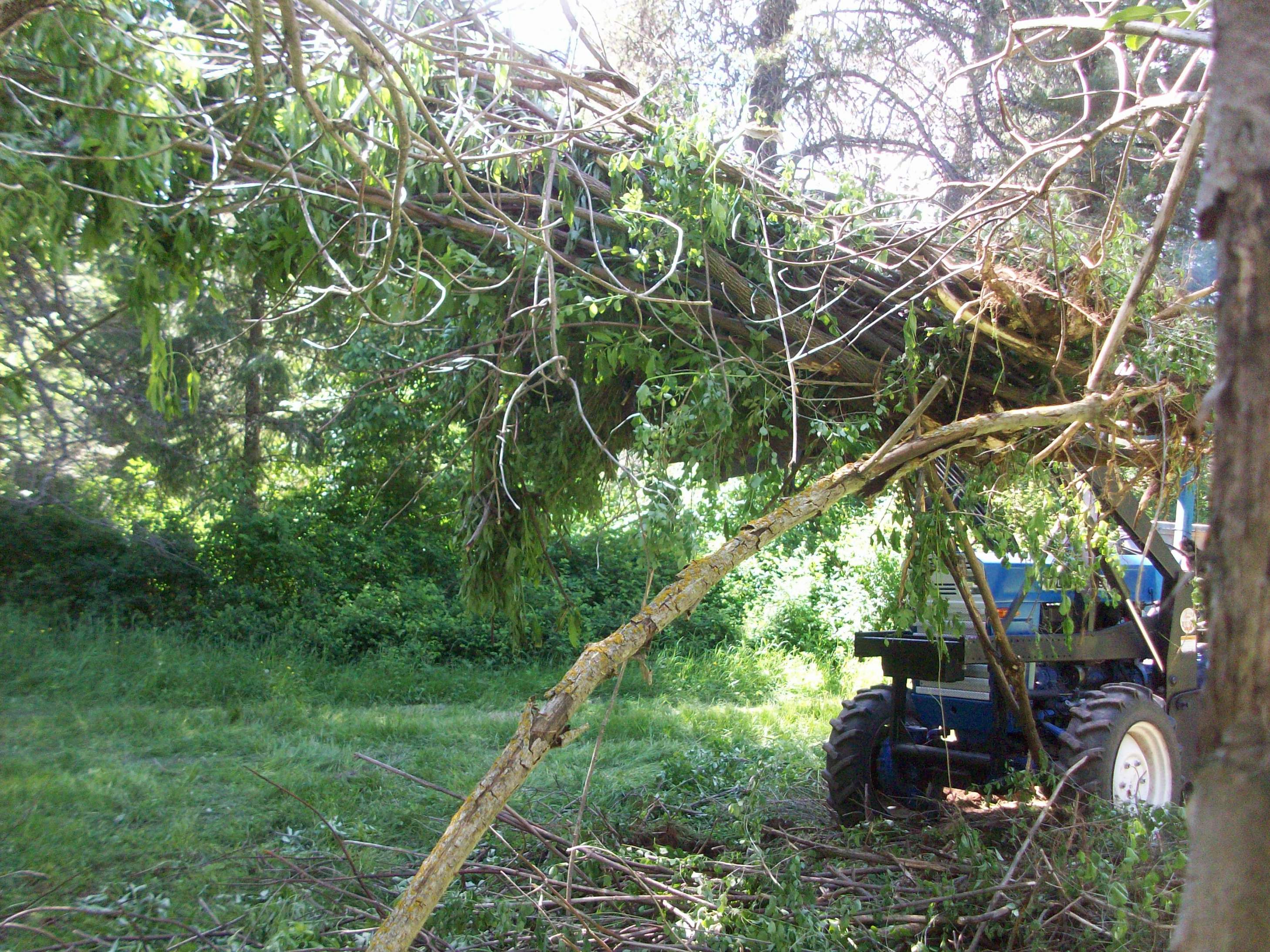

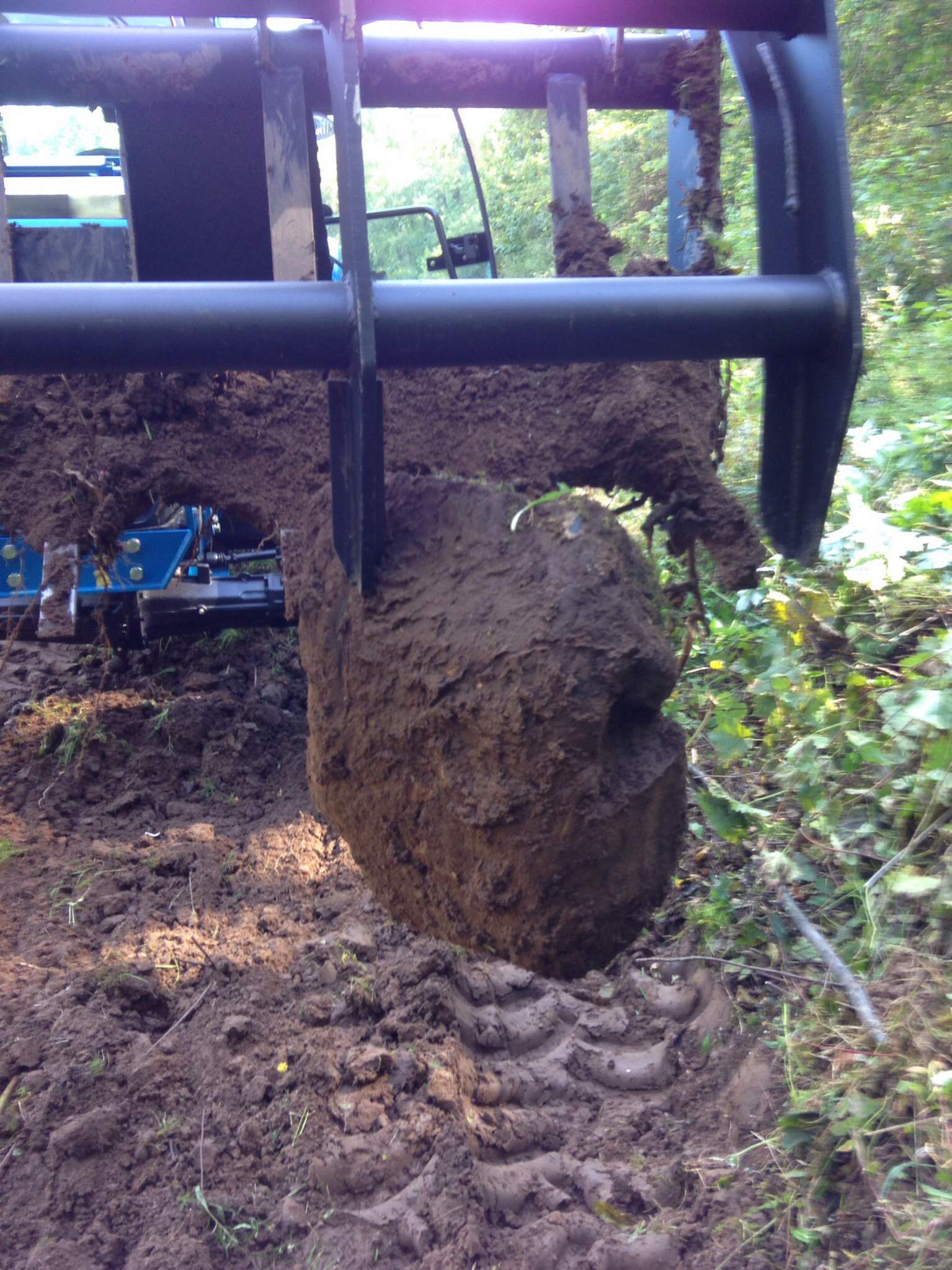

Or instead of dragging it, grab the root ball- like this and start driving... ELDER BERRY TREE REMOVAL 003.jpg Oops-. after breaking off the part that was about to jamb into the left front tire.
using this method i was able to remove it without cutting it into short pieces

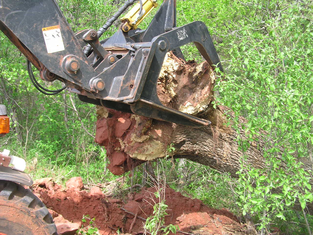

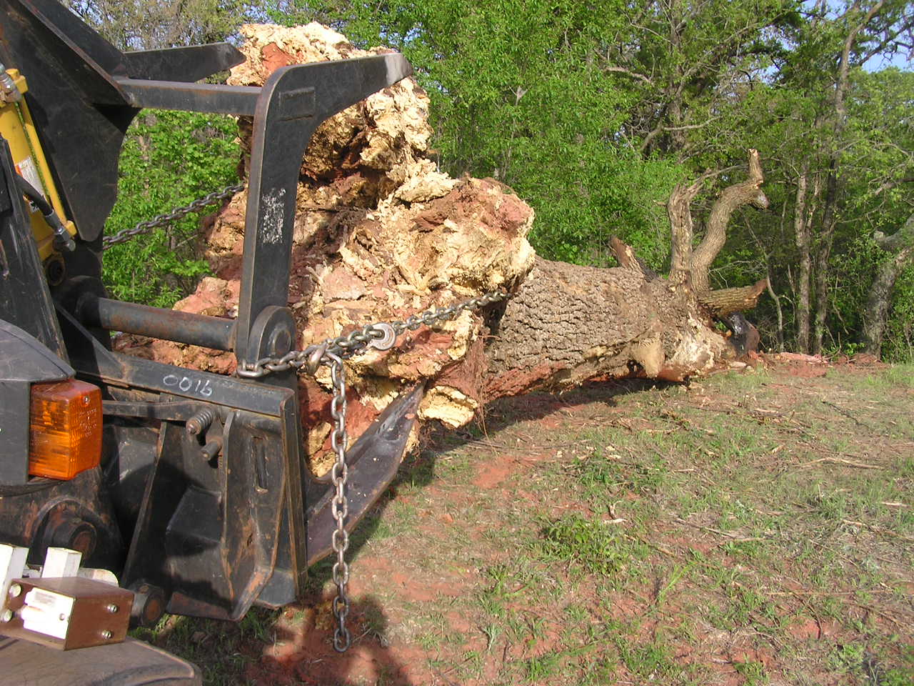

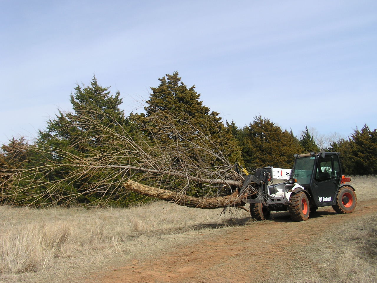

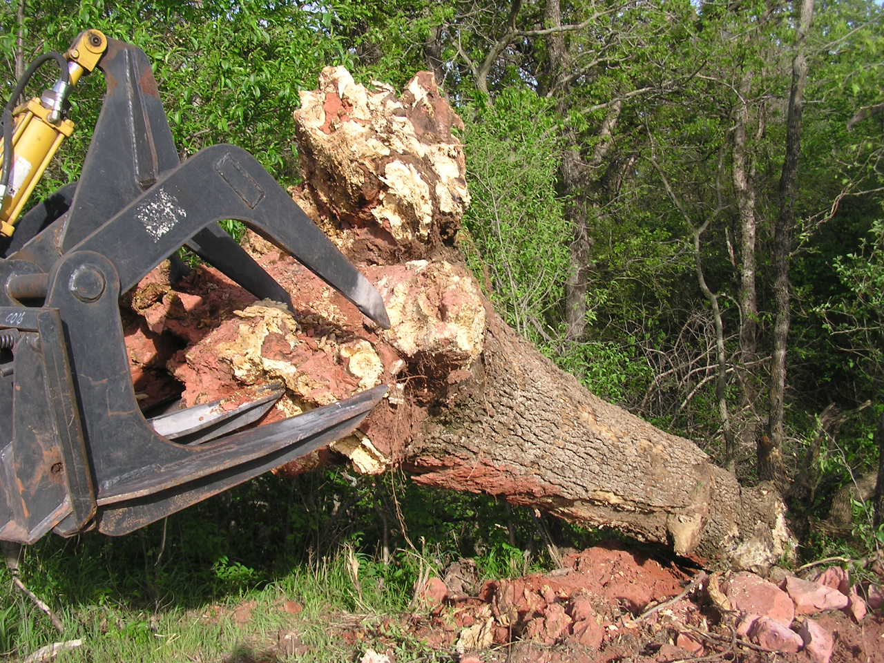

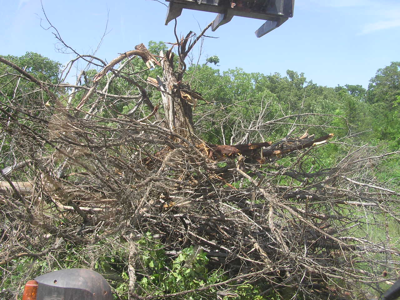

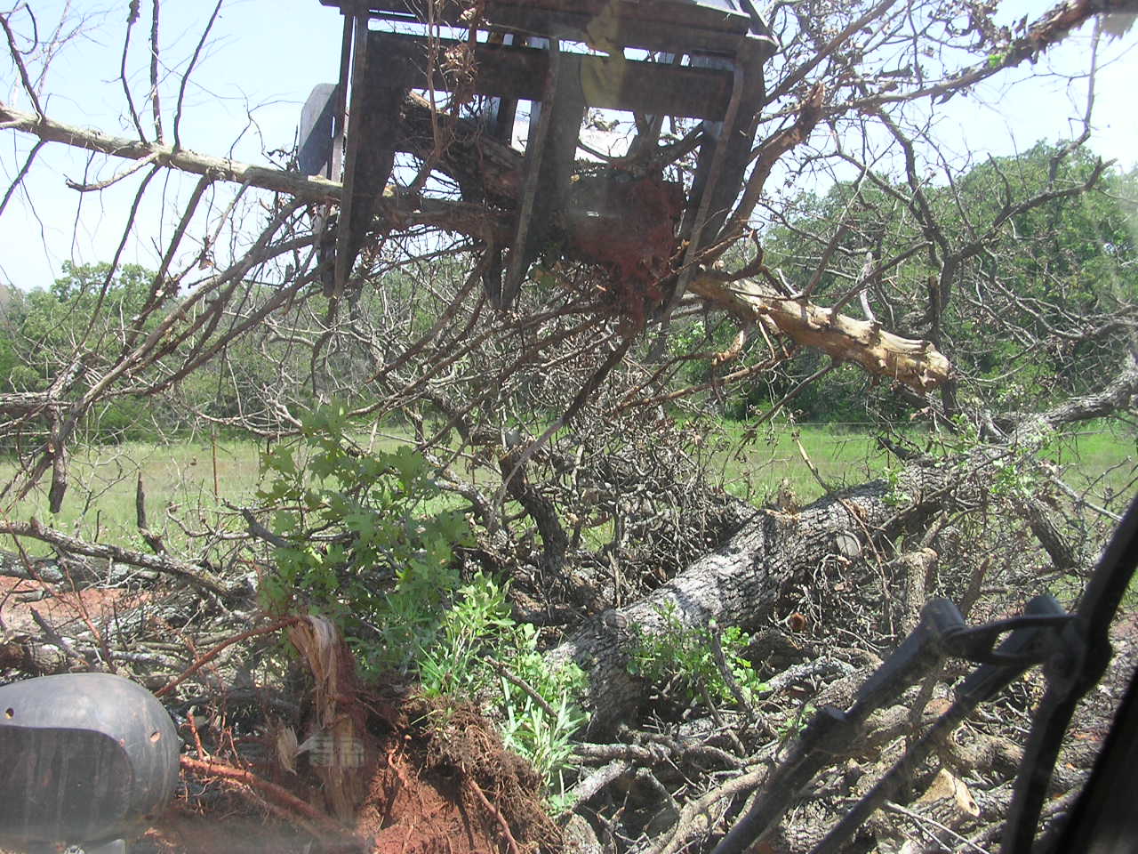

Sometimes you have to use a chain! :thumbsup:
Here are two smaller ones grabbed at the end.

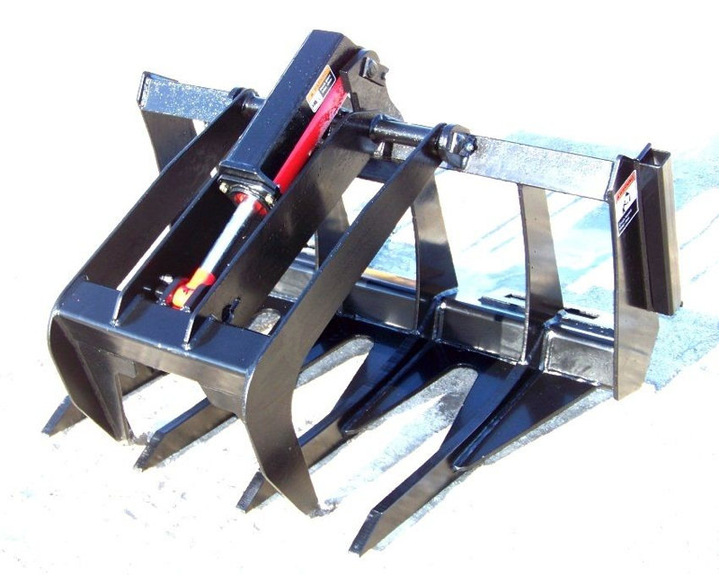

Yep, I'm in the same boat. This one seems to have a lot of good qualities and is getting closest, a bit heavy, what are your thoughts?
Faver SCX 627

took a look at the Faver SCX grapple that you posted , i see why you are considering it- because
it has tandem lids
it has a flat bottom so it can be loaded (or even hand loaded)
It has grubbing ability
It has a good wide opening
It has protection for the hydraulic cylinders
AND my favorite- no cross brace at the front of the tines- allowing it to penetrate thru slash piles, garbage or even barn stall floors that need cleaned out without (pushing) the material you are trying to pick up.
I think that design is a winner but this is JMO Looking forward to others thoughts on this grapple...

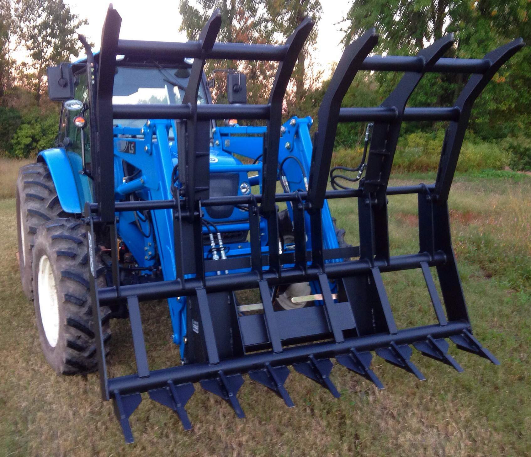

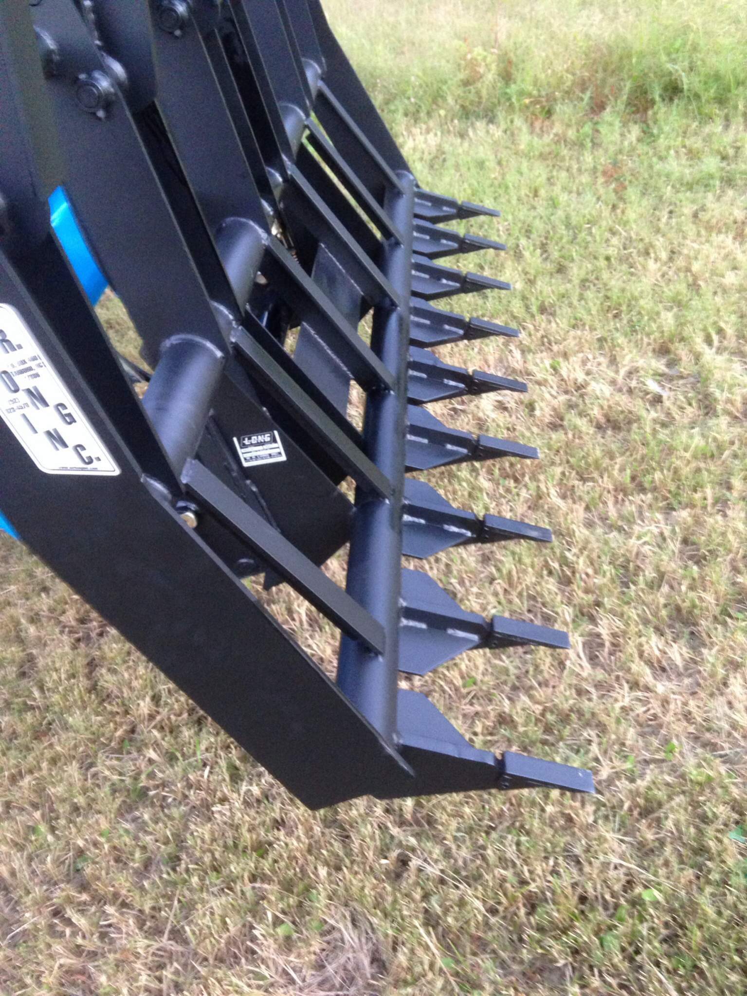

I also think the Faver design is nice. The lack of cross brace tube reminds me of my Wildkat Deep Penetration grapple. You can use the tips more effectively to penetrate into tree limbs, etc. when picking things up. Faver uses a high quality steel that allows them that long of a lower tine without as much danger of bending the tines which I think is the real reason mild steel grapples have the cross tube out front. I like their narrow 31" model. The upper tines cross over the lower tines in the attached image, making for a very small 12.5" holding area compared to most L bottom grapples.
