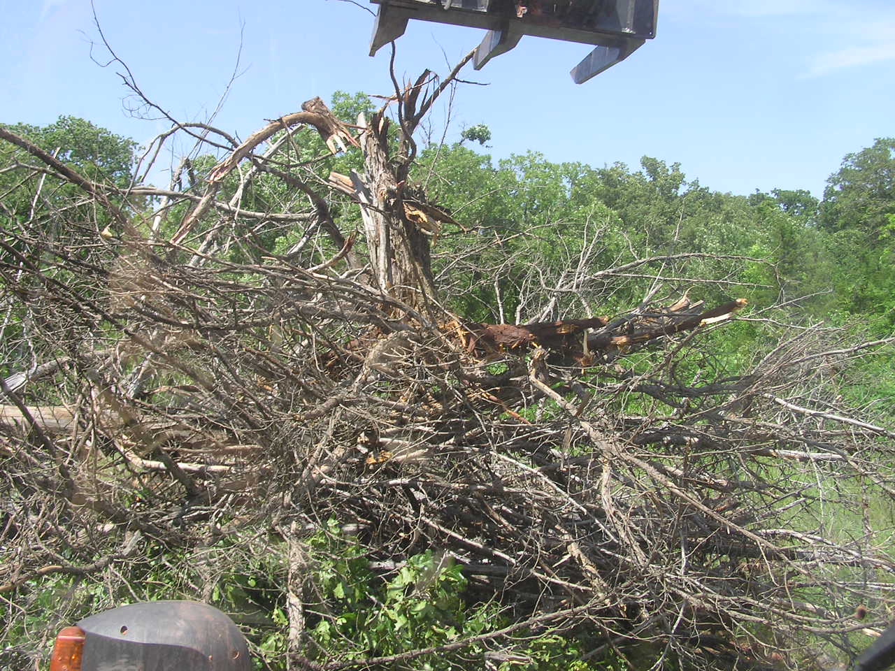

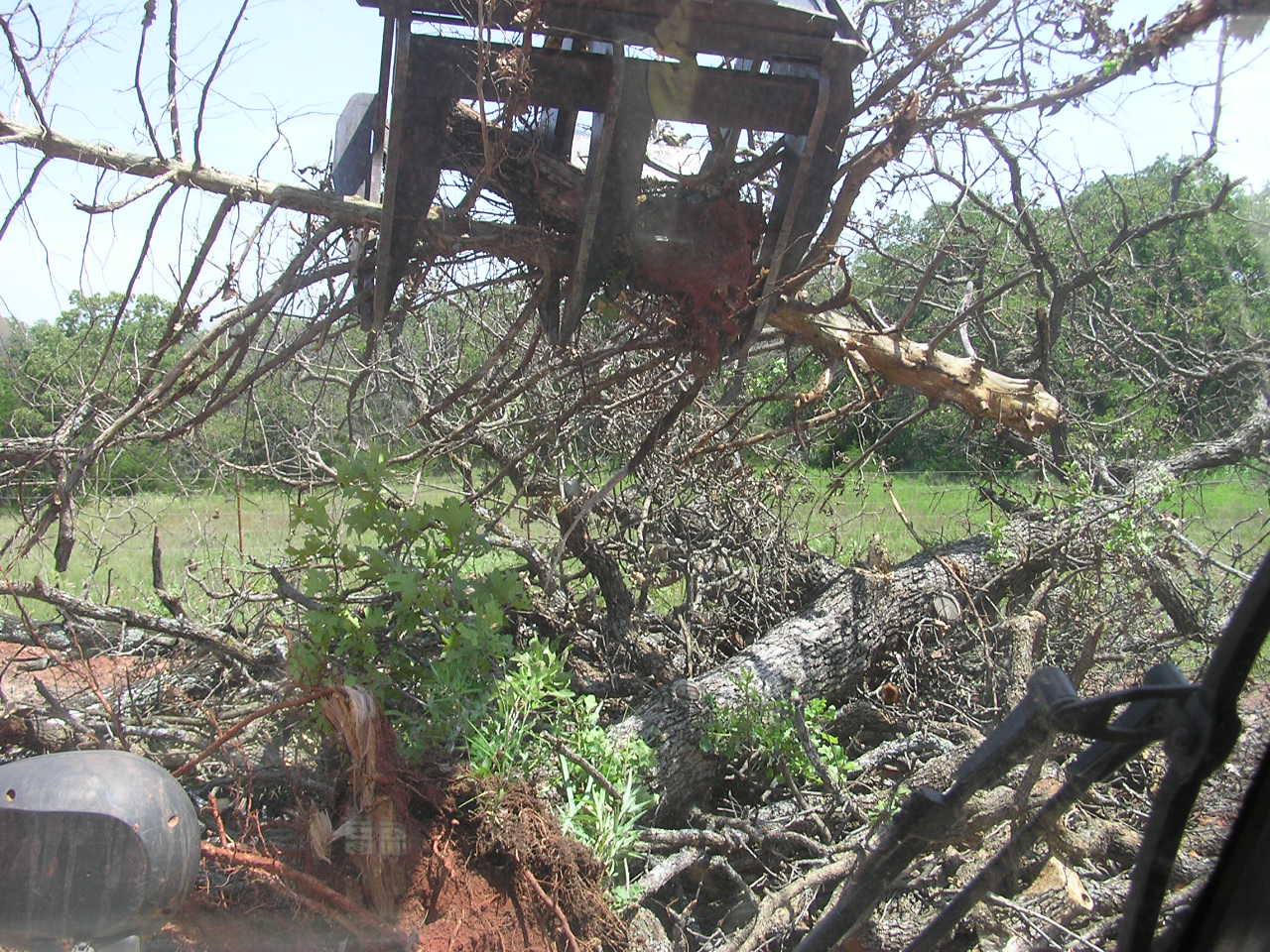

Forgot all about uploading my photos at the Grapple Shootout. I did take some videos, but they did not come out good enough to show how the Grapples worked.
I did take a couple of videos. But they did not show much because of the thick brush.
My opinion is either unit will work. But prefer the one on the Kioti.

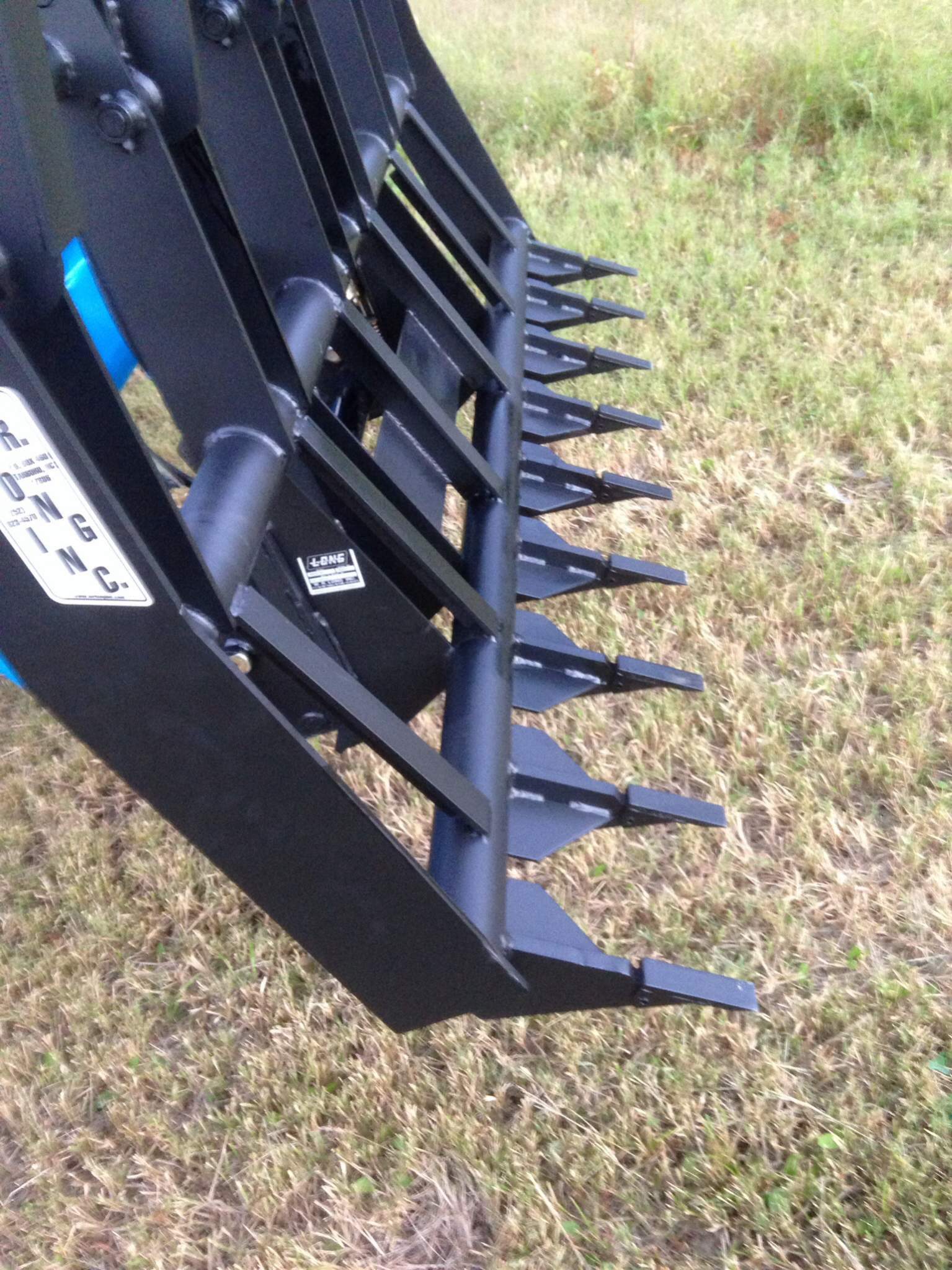

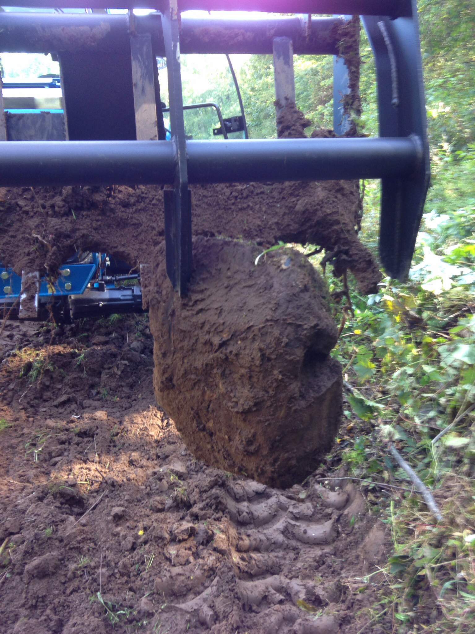

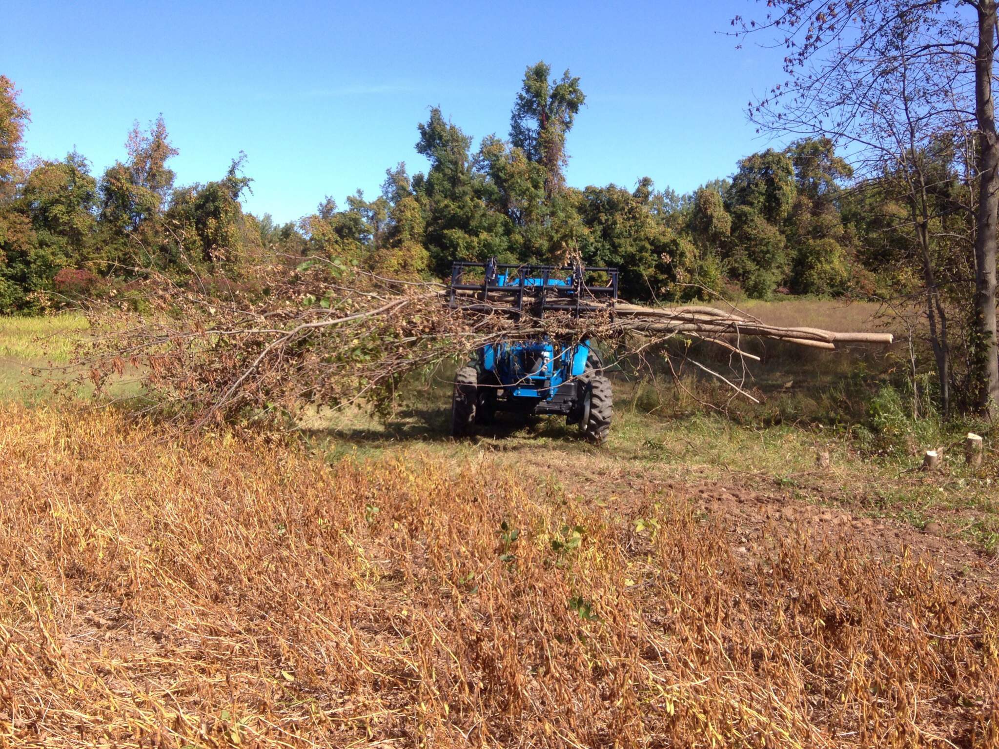

I paid $3600 for mine from my local dealer, but it was the only one that had the features I wanted. I have owned two of the flat bottomed types and much prefer the rake style.
It's the only one I could find that had the spade style lower tines, replaceable teeth, dual lids and a very large (70") jaw spread. It's much easier for me to pick up single logs and works great around my fields. I looked at the Pallet forks brand root rake style and it didn't have the features I wanted and has a lower jaw that is way too flat to carry much brush.
I have literally miles of hedgerows that I need to keep clean and I can go along with a chain saw and drop trees/limbs into the field then go along and clean up with the grapple. With my rake style I can push the trees/limbs ahead of me and get three or four at a time. This wasn't possible with my old flat bottomed grapple.
Also I needed a grapple that would really dig out roots and this one works great. It's much better than my last two grapples but to be fair, it's also on a much larger tractor.
For me, it was worth the extra cash and it does save me a lot of time, but yes it is pricey!

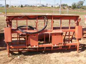

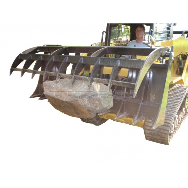

This is Titan's Rake. Not enough lower tine to grip with. Titan sells through various channels, most notably PalletForks.com.

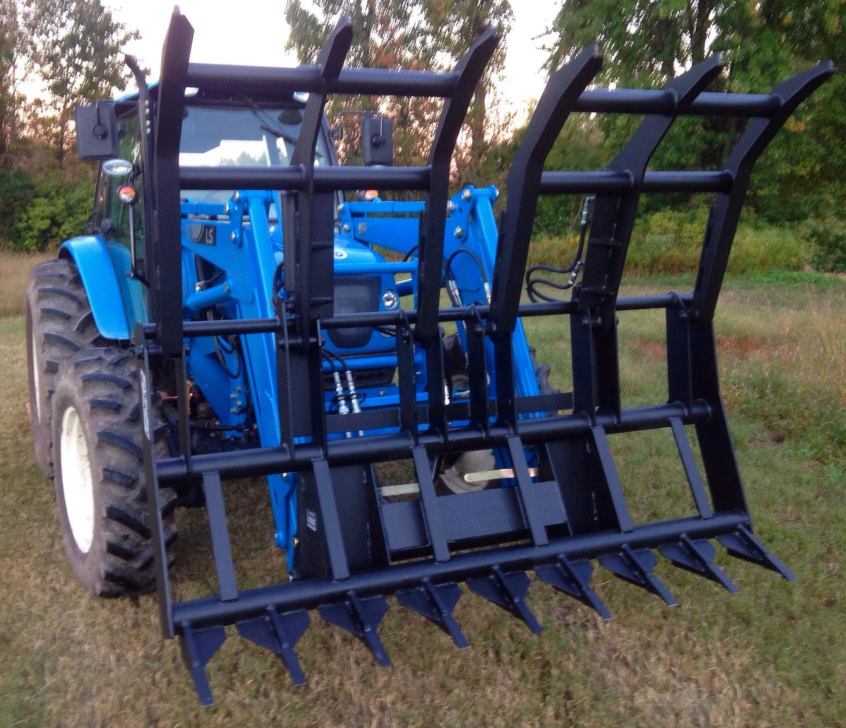

For a good grip it does seem like the upper and lower tines should overlap like this one. Both grapples we worked with did not overlap and the yaupon not sufficiently loosened slid out of the grapple grasp.

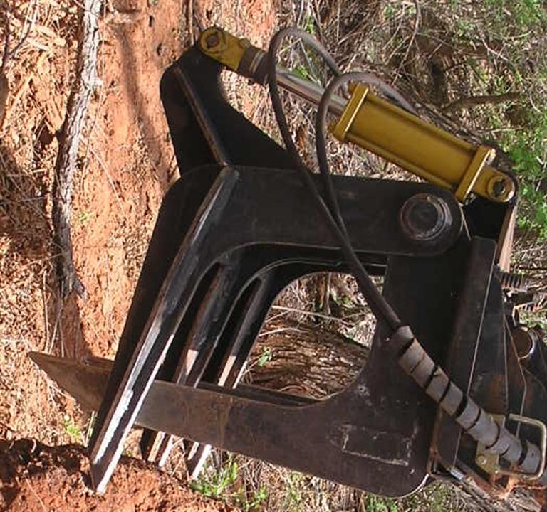

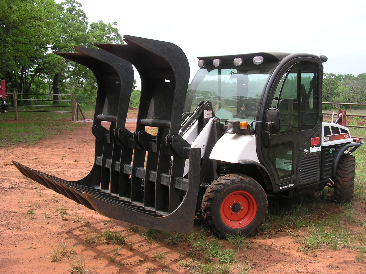

The ultimate grapple would have to have the lid pivot moved up like the Monster Grapple, to get a bigger opening.

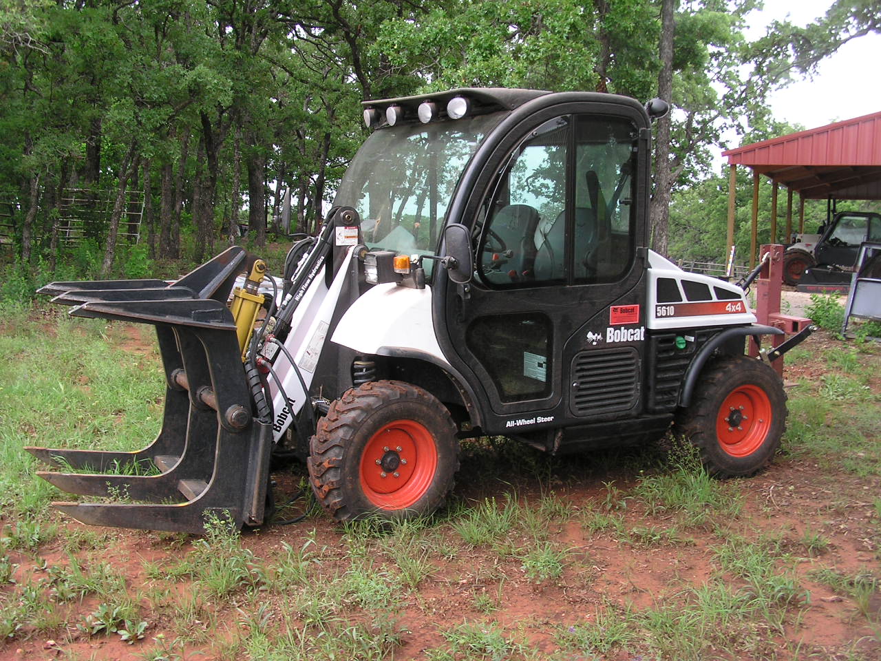

6' wide on my Toolcat
