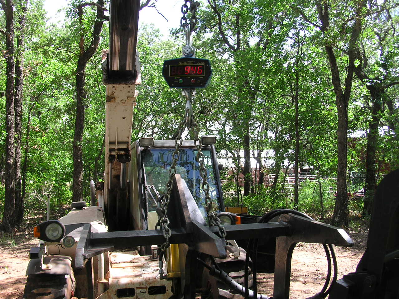

Yep, 1" thick and the frame that is tubing on most grapples, is solid bar on this one.
44" wide, weighs 946 pounds.

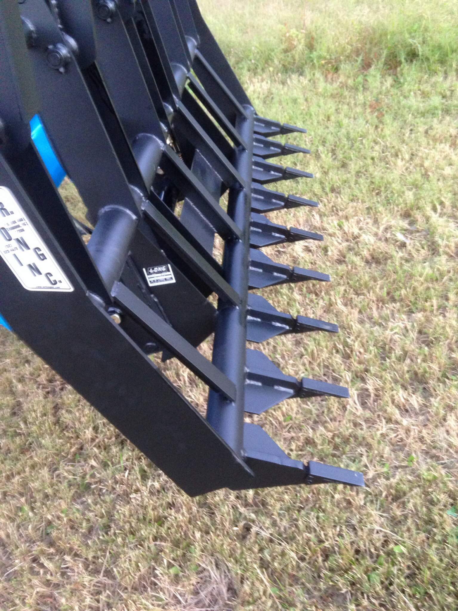

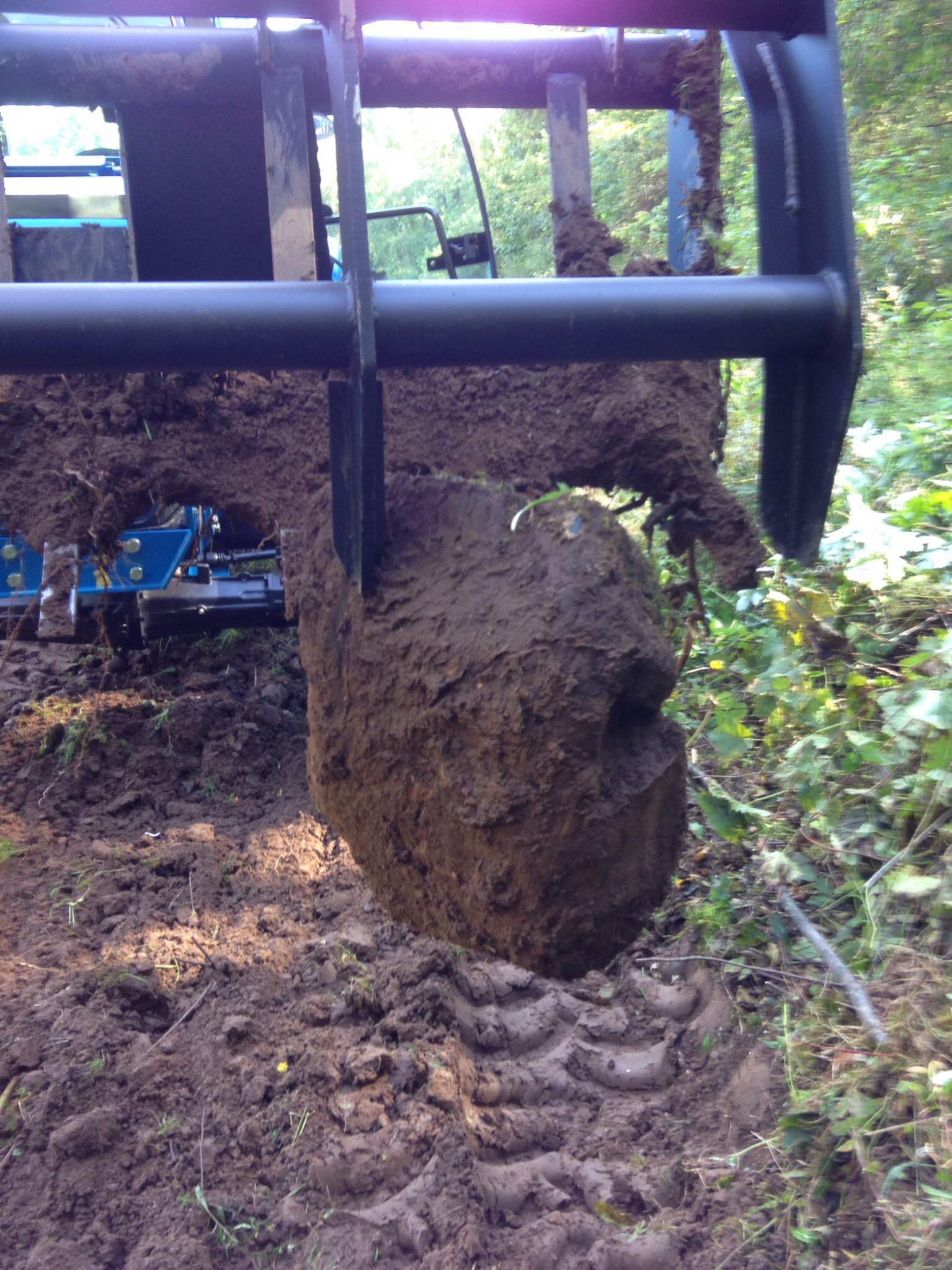

IMHO tooth design has more impact on digging ability than any other aspect. I went with a wider spade style with lots of horizontal "cutting edges" because most of the roots in my neck of the woods grow up and down.
I can sink the teeth up to the cross bar and dig up to 10 to 12" deep, but seems to work best 4-8" down with the cutting edges more perpendicular to the roots. In my wet clay soil if you're not careful you can move a lot of dirt! Dirt does build up on the spade style teeth and requires quite a bit of "grunt" to run effectively but it does a great job. Here's a picture of the grapple and one showing how the dirt builds up on the crossbar.

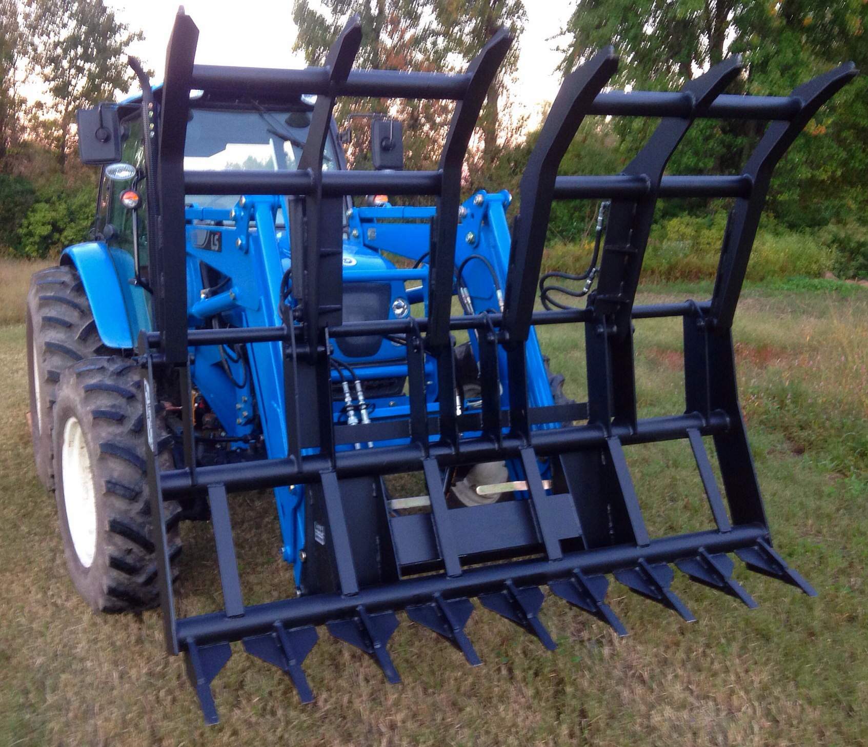

It is a dual lid rake style and this is what it looked like new.
A single "lid" was why I shied away from a root rake style grapple and went with the bucket style. I wanted two independent arms. I like yours. What make is it? Do you have a link?
