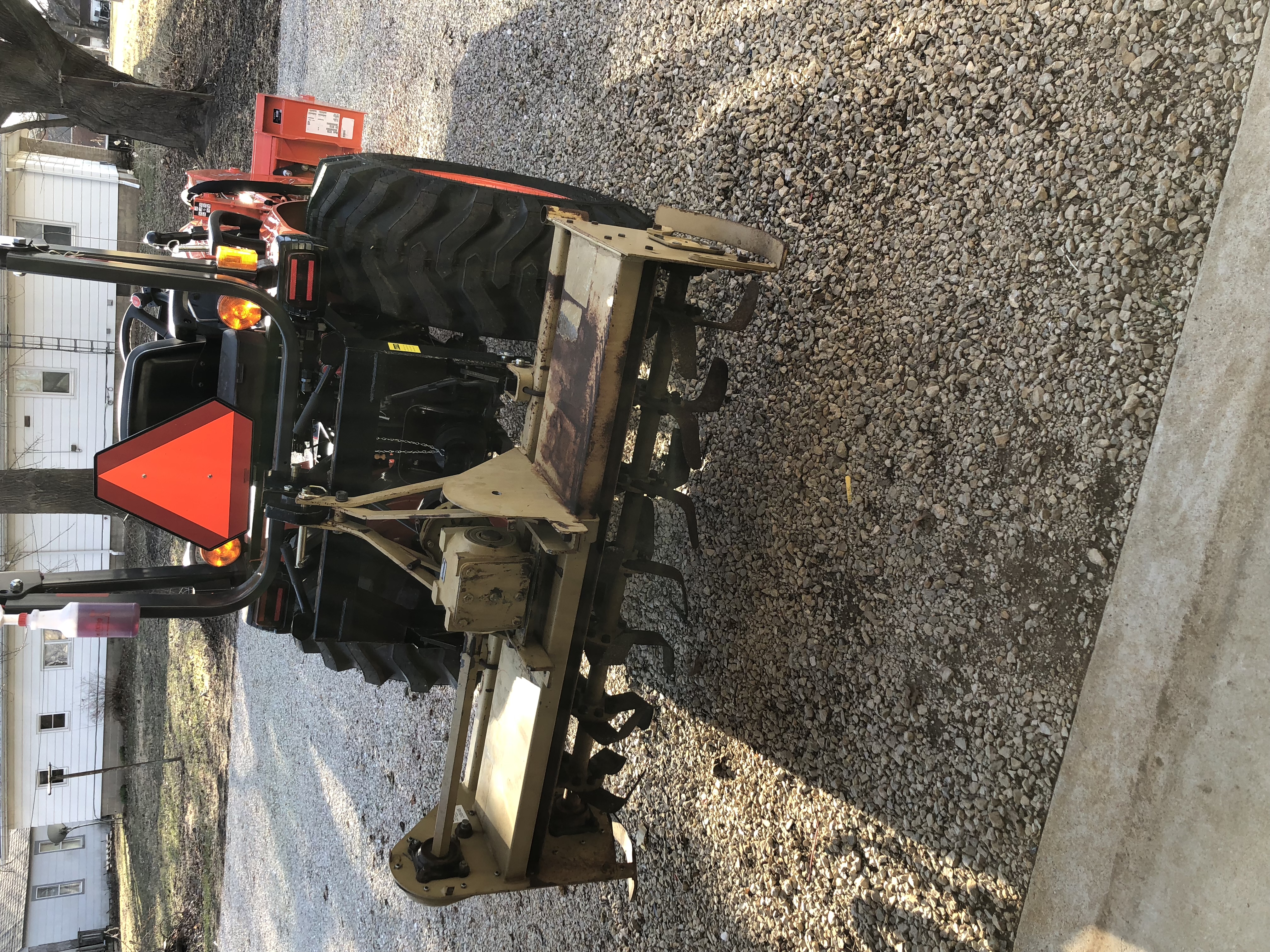

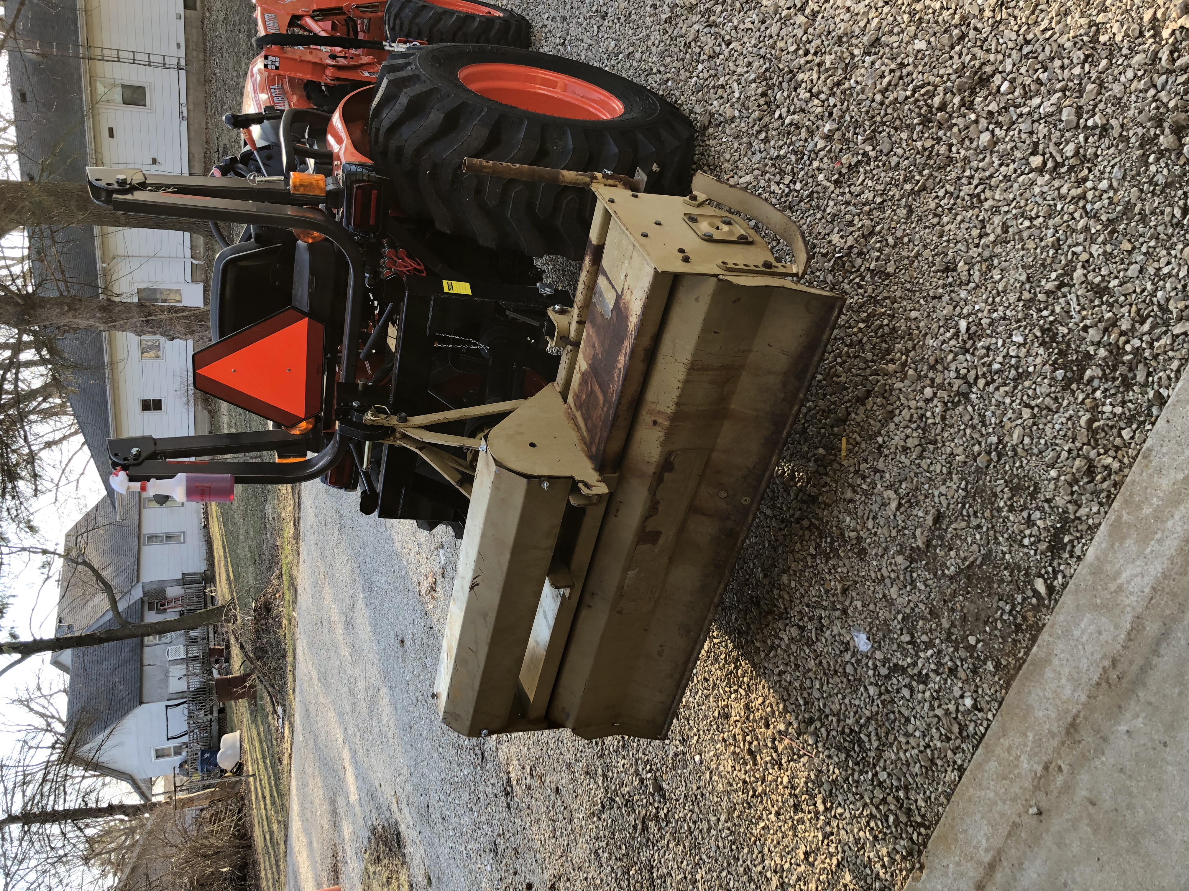

Got the tiller centered and some pierces straightened.
Just needs to be sandblasted and painted.
