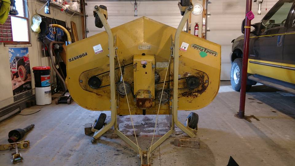

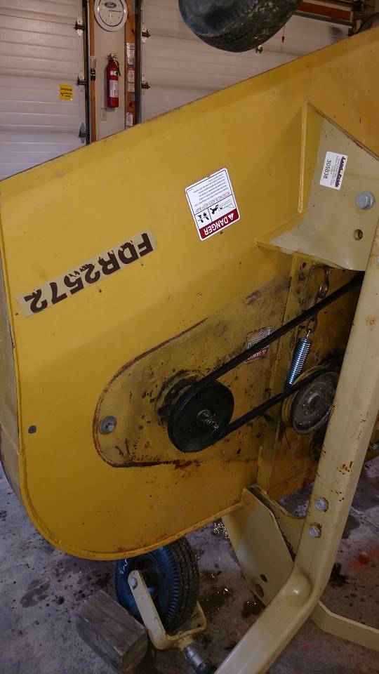

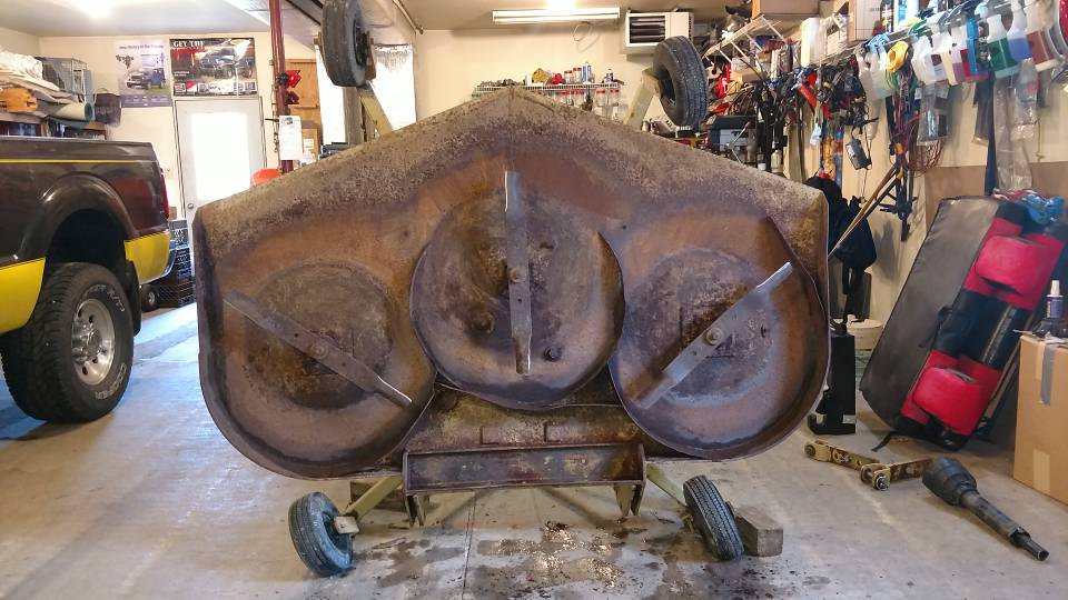

So I'm beginning to restore my $650 FDR2572 Land Pride mower. Soon it will be Kubota orange, top to bottom. Solid tires. New belt. Blades are sharpened already today. New stickers.... It should look and function like brand new. IMG_20180330_181535473.jpgIMG_20180330_181517051.jpgIMG_20180330_181459381.jpgIMG_20180330_181438003.jpgIMG_20180330_181417709.jpg

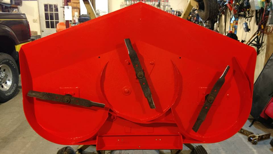

I have everything on the bottom scraped off scale and coated heavy with Rust-Oleum Kubota orange. I'll attack the top tomorrow...IMG_20180330_213316522.jpg

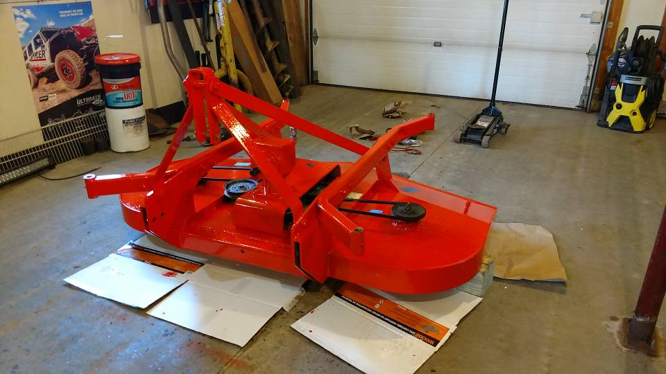

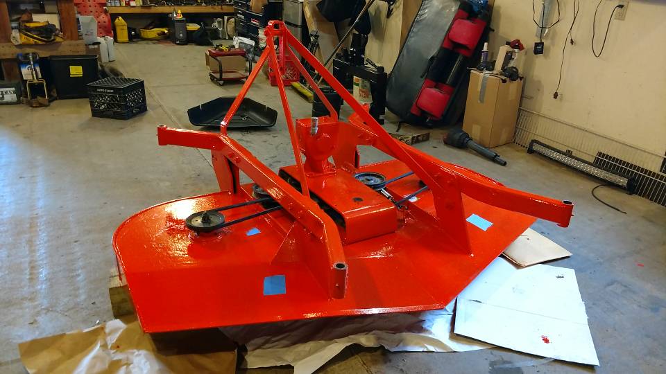

Well, I started on painting the upper side of the Land Pride mower today.
I ordered the newer style solid rubber tires for it, but the center hole is 0.750" in the new wheel bearings, and half inch on the old wheel bearings and axle bolts. So I would need to drill out the wheel yokes and get bolts to match, or convert the wheel centers down to the 0.5".
I need to talk to Kubota tomorrow.IMG_20180401_133649650.jpgIMG_20180401_133638399.jpgIMG_20180330_213316522.jpg

Wouldn’t take anything to drill them out to 3/4 quick.
How did you prep the existing finish for paint?

Pressure washer for any loose rust or stickers, scraper for any loose paint or rust that the pressure washer may miss, acetone wipe, paint brush. The great thing about Rust-Oleum is that it's very forgiving about prep, it's very durable once fully cured and it looks/lasts for years.
