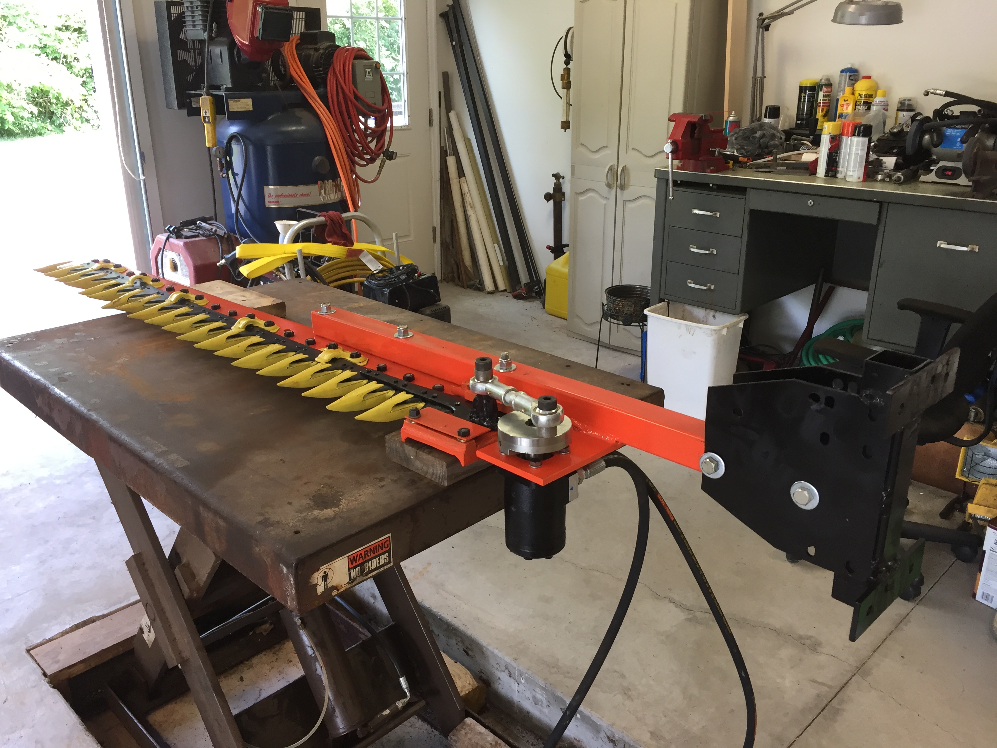

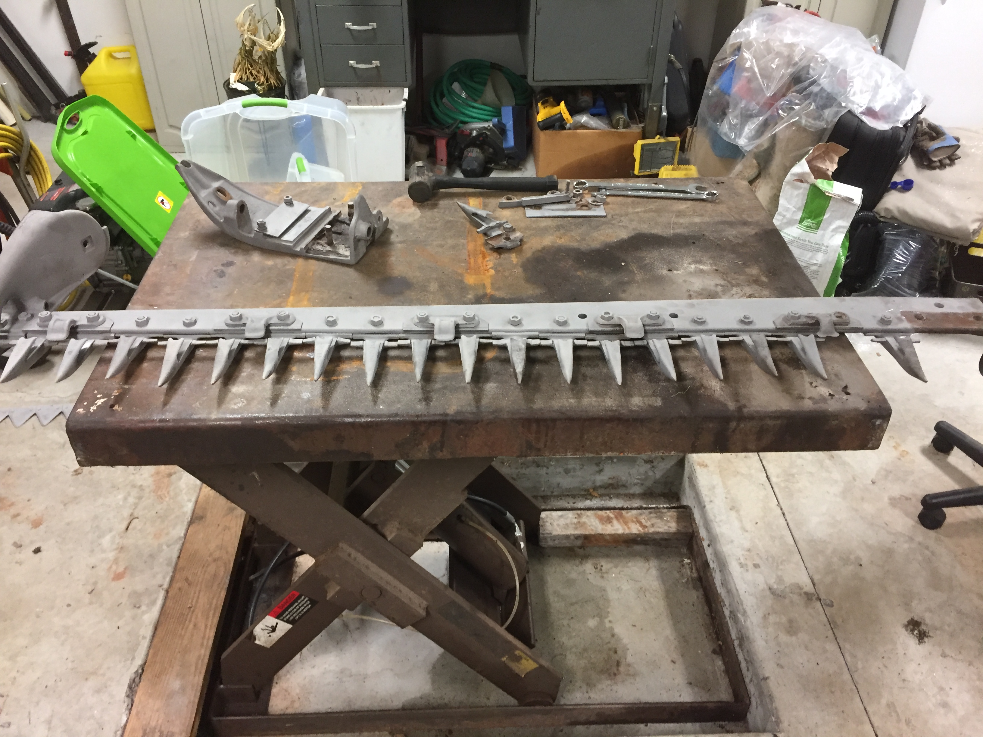

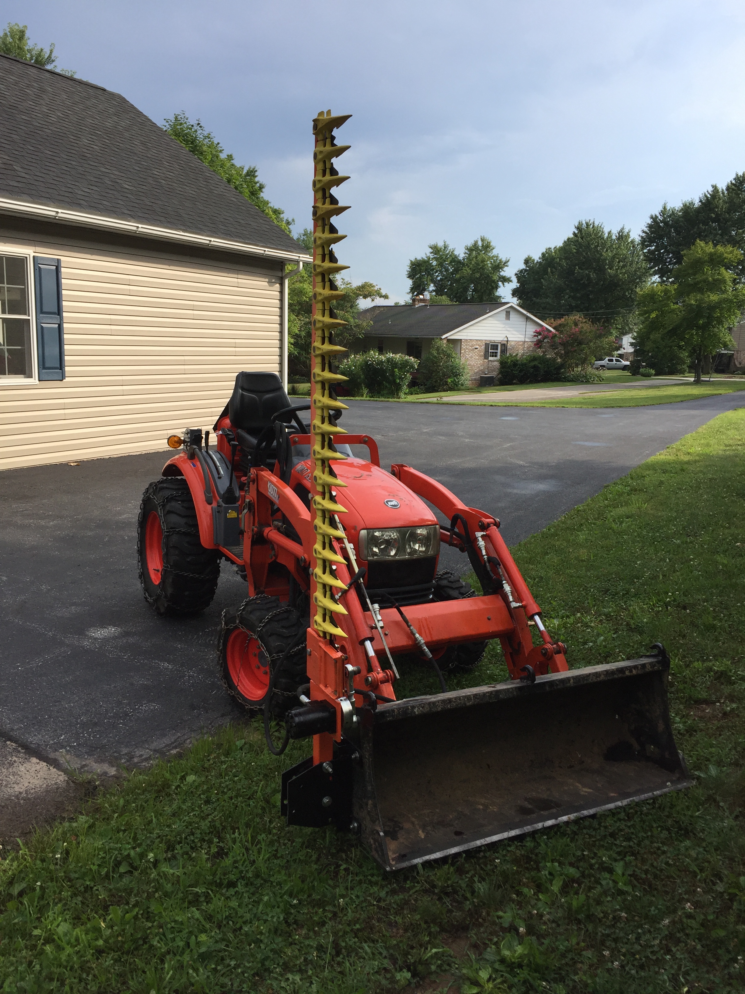

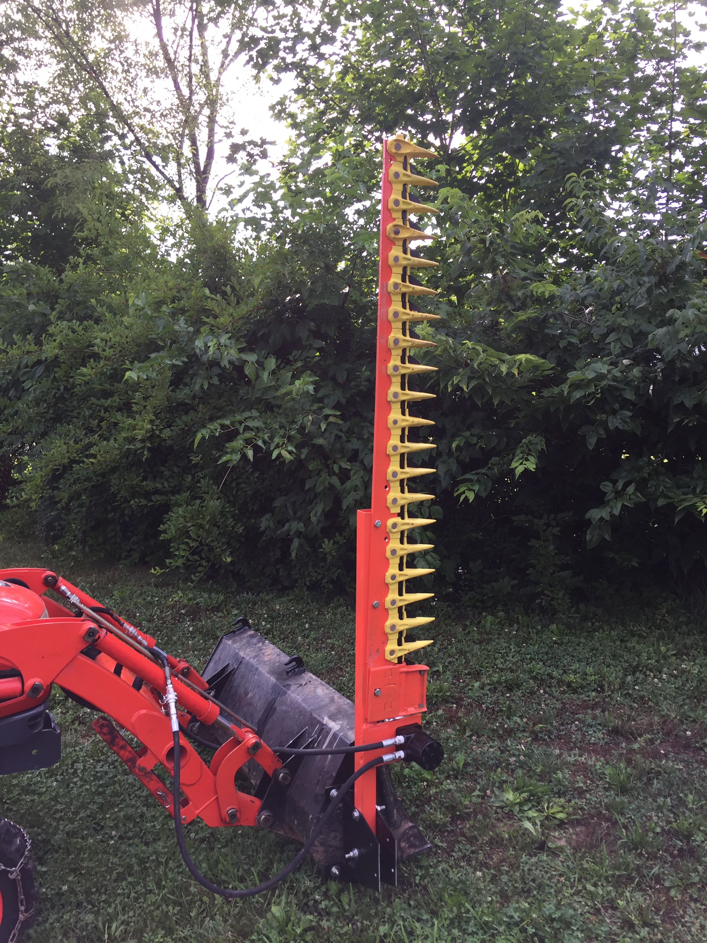

I have a hedge row that is about 250 feet long and it takes me several days every year to trim it with an electric hedge trimmer. I decided to build a man sized hedge trimmer for my Kioti. I went looking for a sickle bar for a Cub and found one. I sand blasted it and painted it then started designing a mount and drive system for it. I bought a hydraulic motor and machined an eccentric flywheel. I took it out for a test drive and it now takes me less than an hour to trim the entire hedge row. IMG_0223.jpgIMG_0224.jpgIMG_0217.jpgIMG_0199.jpg Man Sized Hedge Trimmer - YouTube
