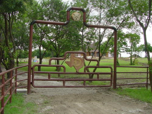

When we're done a visitor will send an alert via internet to the homeowner's tv or office computer. The homeowner will be able to see, converse, and operate the gate from same points.
On another thread I've mentioned a cabinet with all the power and electronics close to the gate but still about three hundred plus feet from the house.
The camera is in a beautiful billet aluminum housing. It's got it's own diode light source. And it needs to be in the overhead. I haven't decided if I want it in the rock or if it'll be a distraction.
What do you think of the pink tips on the star? I did that this morning because I could. Darn, I've heard that somewhere before, must of read it in a book I got for Father's Day. /forums/images/graemlins/grin.gif /forums/images/graemlins/grin.gif /forums/images/graemlins/grin.gif

I got the star up just before the rain came again--still. We're running at a rate to have number two June record for rain this year. At Bird's I'll bet they've already beat the 1928 record.
You gotta luv the mud. Of course it could be worse, it could be muck. /forums/images/graemlins/smirk.gif

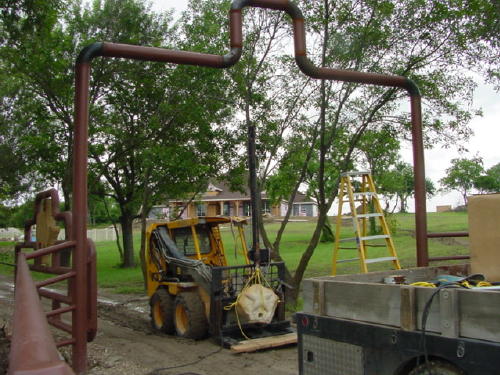

The hole in the bottom is for the camera. It, the hole, is two and half inches across and three inches deep. The camera is two inches in diameter and two and a half inches deep. In the back of the rock a rectangle is cut out for a weathertite electrical box. And there's a five eighths hole between them.
I've still got to color the star rock with the torch so it'll look like the Texas one. I was lucky to get it up before the water came down. The place is a muddy mess.
It was a little bit of a challenge to install it by myself. But Lucy was there and she's so willing and capable. /forums/images/graemlins/grin.gif

Harv, that looks great. Of course, I might tend to be a little leery of driving under a rock that big. /forums/images/graemlins/wink.gif
And you're probably right about the rain. I really needed to mow today, but there were still puddles standing in the yard and then we got another downpour this afternoon.

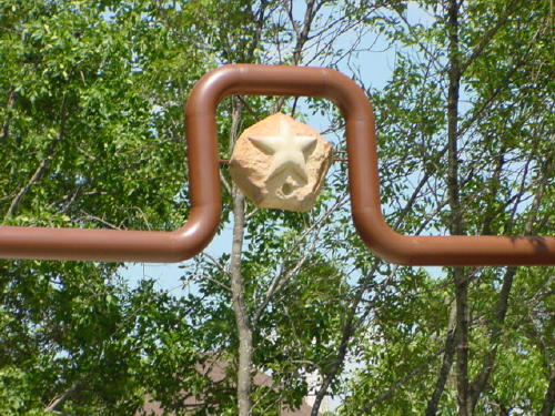

</font><font color="blue" class="small">( Anywho, the pink tips look great. How did you color them?)</font>
I used a torch. I know it sounds silly but a cutting torch works great as a paint brush on sandstone.
*one of those factoids I've discovered all on my own* /forums/images/graemlins/grin.gif /forums/images/graemlins/grin.gif Don't ask.

Here's the star after I "Painted" the surrounding surfaces and left the star out of the fun.

Two questions, Harv.
1) Does that "painting" method cause sandstone to deteriorate faster than normal?
