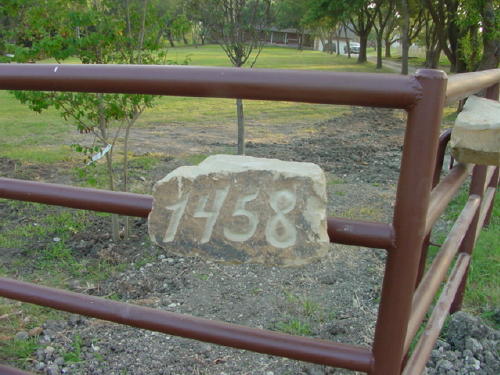

That was the only carving done with a sandblaster.
It's really quite simple to do. First you freehand out your desired inscription on a sheet of aluminum. Then you cut it out with the plasma torch. That is the template which is clamped to the stone of choice.
Blast it.
Remove aluminum template.
Drill two holes in backside of the stone and epoxy in studs. The studs are welded to the pipe fence.
This job is done.
It seems like it's lasted forever.
