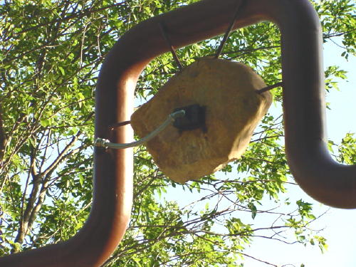

The other day I ran the coax and power cable from the cabinet to the star. I used some liquid tite between the overhead where I'd welded on a nipple. And a weather tite box that I'd screwed and siliconed in.
Here's the north end of the southbound star.

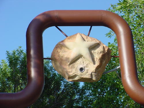

This is the southend of the southbound.
I had two bags of grout from tiling our bathrooms, different colors. A little of this one and a little of that one, some water, and I love being lucky more than anything. Don't ask me how but the color came out close.
What I did was use some packing foam to position the camera in the cavity. Then I grouted in the part that would show.
This way if there's a problem it will be easy for the security crew to chip out the old grout and free the camera.

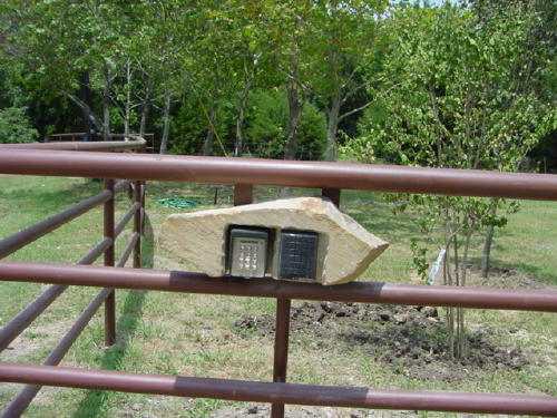

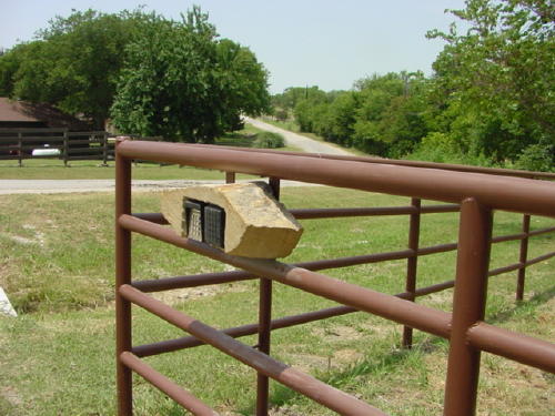

Yesterday I installed the talk box and key pad. I recessed them in a chunk of stone. I think we got lucky one more time.

Here's a shot of the installation.

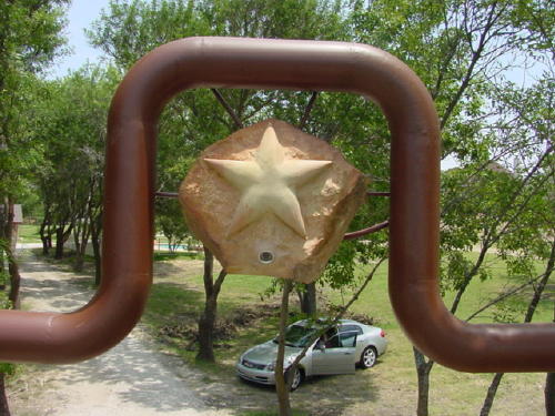

Leo wanted a better shot of the star. So I got up in the bucket and son in law made like an elevator operator.
