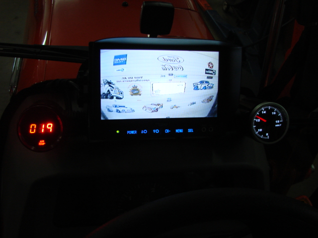

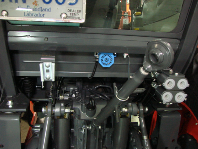

Here you go Boris1. This is where I mounted the ambient temp sensor. It's the most accurate place on the tractor. This is how it looks in the 5740 now.

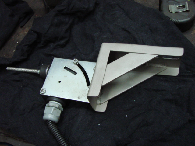

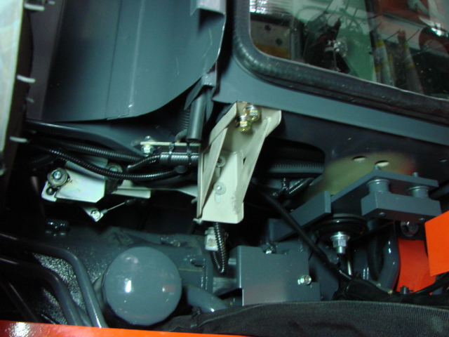

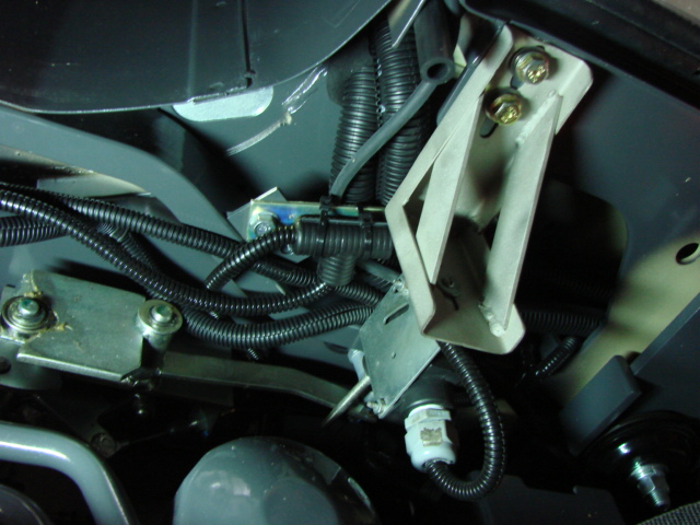

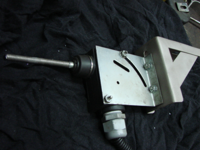

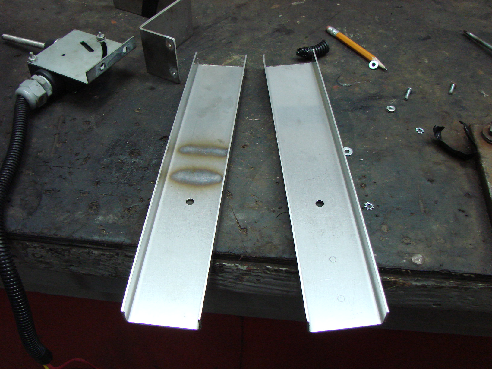

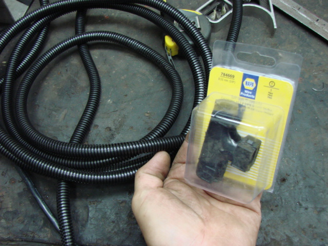

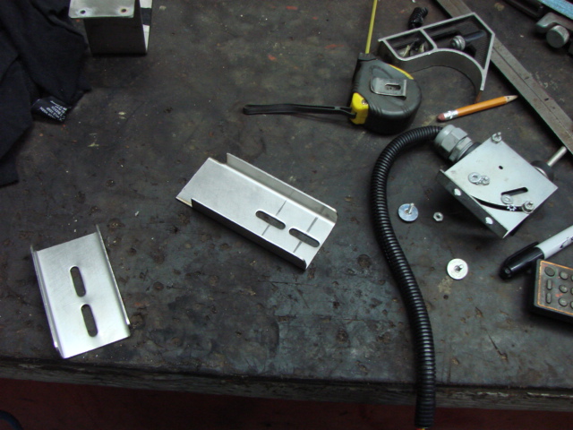

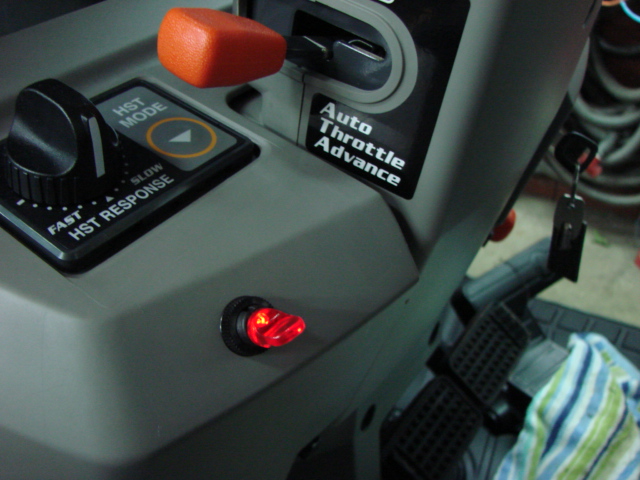

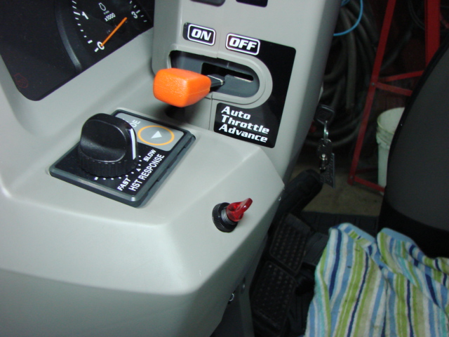

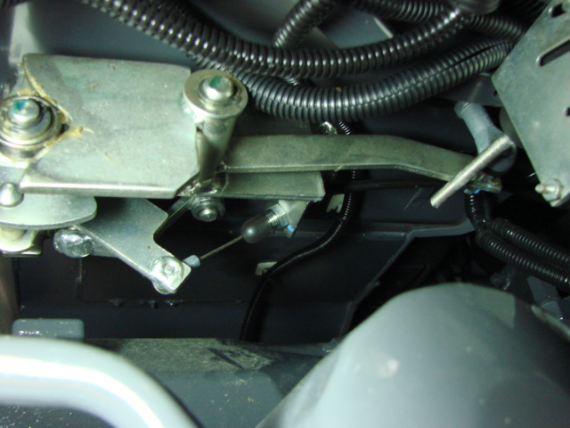

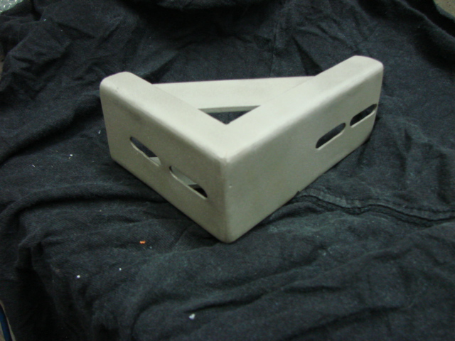

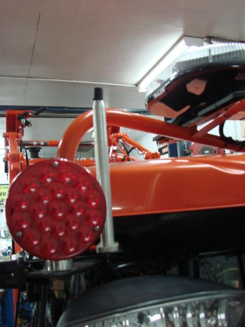

Today I spent the morning re-installing the reverse beeper. It was a different hook up from the 4240 so I had to make a new mounting bracket. I had some scrap stainless steel so I made the bracket out of it.
To accommodate all the accessories I installed an aux fuse panel and you'll notice that i also installed a reverse alarm by-pass switch that way IF I'm in an area where there are no people around or it's late night or early morning I can just turn the alarm off. The switch also has a L.E.D. light in it :cool:
I attached a few pics just in case someone out there with a Kubota 5740 HSTC3 ever wants to put a reverse alarm on there's they'll get a few ideas from this.
After I got the alarm installed I spent 9.5 hours on the exhaust stack mod. If all goes well I should have that completed tomorrow. :)
