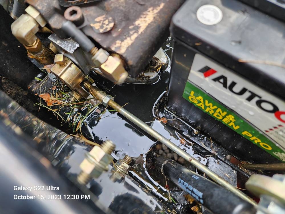

That's a nice looking machine. Seeing as though it is new to you, you may want to run it just to confirm that you didn't have an oil spill from the last guy. Or can you actually see the source of the leak?

The right hand pump is the leak source. I cleaned all and ran it 0.6 hours and the right side is soaked.
   / The new mess. Exmark Laser HP 23hp with weak hydraulic drive. #15
If mine leak (and they have in the past), they always leak on the bottom where there is an aluminum pressure die cast bolt on cover (bottom of the charge pump) and under the cover is an 'O' ring.
What I did was I replaced the 'O' ring but first I took a flat file and filed the removable cover flat as the casting(s) were a bit rough and bolted it back on. If you do that, you need to mark it as to orientation (I used a small punch to mark the casting and the body so I installed it correctly. If you install it backwards, the pump won't work. Neither of mine leak any more.

Temperatures settled at 170-175 for left and right pumps and 155-160 for left and right hydraulic wheel motors. Temps rose consistently left to right. So, nothing with the temp gun said that there is an obvious issue. I may look for a local dealer and have them spend an hour or 2 diagnosing it to see if they can tell me for sure.
Hydrogear came out with a replacement charge pump cover kit because the aluminum cover warps causing the leak that you describe.
And to @Rock Crawler It looks like the leak is low on the pump. Could it be the line coming from either the filter line or the return line to the tank. Could be cover leaking but would check everything to find the leak. And also as a side note your bypass valve is activated on the right pump which could be part of your drive issues. the bolt through the hex with the plastic cover needs to be turned closewise matching the one on the left.

#19
So, I watched a couple really informative YT videos of breaking these pumps down, what to look out for and getting them back together and sealed up. There really is not a lot going on in here, they are fairly simple creatures. I think I am going to order the seal kit and tear into the right pump. A common issue is that the pistons that ride on the swash plate get buildup in the bores and the pistons stick up inside. If you get 1 piston stuck, sounds like you may not realize it... but get 2 or 3 stuck and you really drop in flow and performance. They can be easily removed and the bores scrubbed with brake-cleaner and some fine Scotch-Bright. But you have to inspect it all and if if you have gouges or other hard part damage, you may as well toss the pump and buy new.
But I spoke to a fellow yesterday (chatted) on FB market who is selling this same model and he broke down the pumps, cleaned and reassembled at 780 hours and they have worked fine ever since. May as well at least try that with the $40 seal kit and some winter labor.
