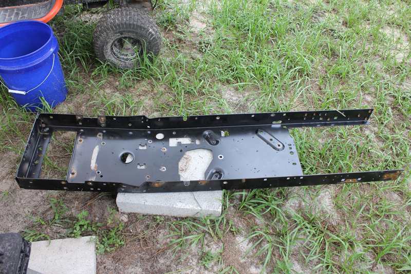

My original chassis at 63hrs on the clock,
Here it is bare,
I found out that many Husqvarna GT owners going back before 2012 have been in the same place, and endured the same or similar Corporate Abuse I had, but with a twist?. many were afraid to be public and endure the ridicule from other owners. This upset me too. So I took this straight on, the good and the bad. I haven't always tackled things that might make me look good (this seemed disingenuous to me) .... I just do my best.
If someone seeks out my original story, I warn you it's raw. The reason, is how offensive it all became, over a $150 chassis, and the words "Husqvarna will never warranty their chassis, ever!" and "if there is a problem with the tractor it will show up the first day of use" also helped contribute to the offense. The Dealer was Backed up by Husqvarna, because, according to Husqvarna, those decisions are left to their authorized representatives, so they stand.

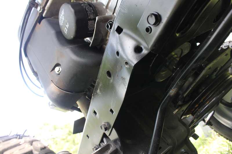

The biggest difference was adding the extra 1/4" hard steel and extending all the way to the back of the rear sleeve plate.
One continuous welded piece on each side from the very front to the very back (the extra 3" beyond the original chassis, the TS chassis is 57"). The rear sleeve plate on the Husqvarna TS354D (GT), as an example has a lot of stress placed on it, but does not have full support of the chassis because the chassis doesn't go all the way to the back, (the missing 3").

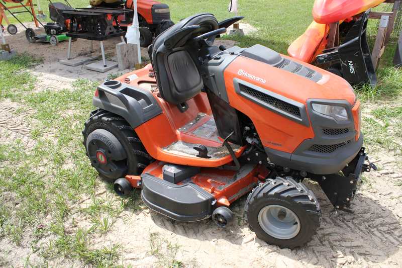

here it is, what I believe might be this Country's newest fully restored Garden Tractor,
As of today it has 184.5 hrs on the clock. 121 hrs since rebuild, approx 12 hrs have been mowing grass, the rest have been Johnny Bucket JR.:) The JBJR is so durable and usable, I can't imagine not having one.
