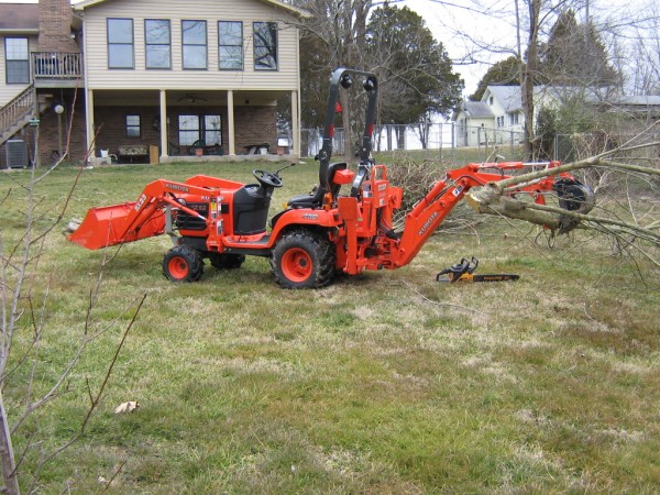

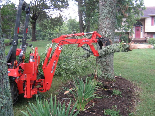

I haven't read of a Bro Tek slipping either. Haven't heard of one breaking or bending either for that matter. Can't think of one negative thread on the Bro Tek....... Course I could have missed it.
A few more shots of the handiness of a thumb on a BX TLB
