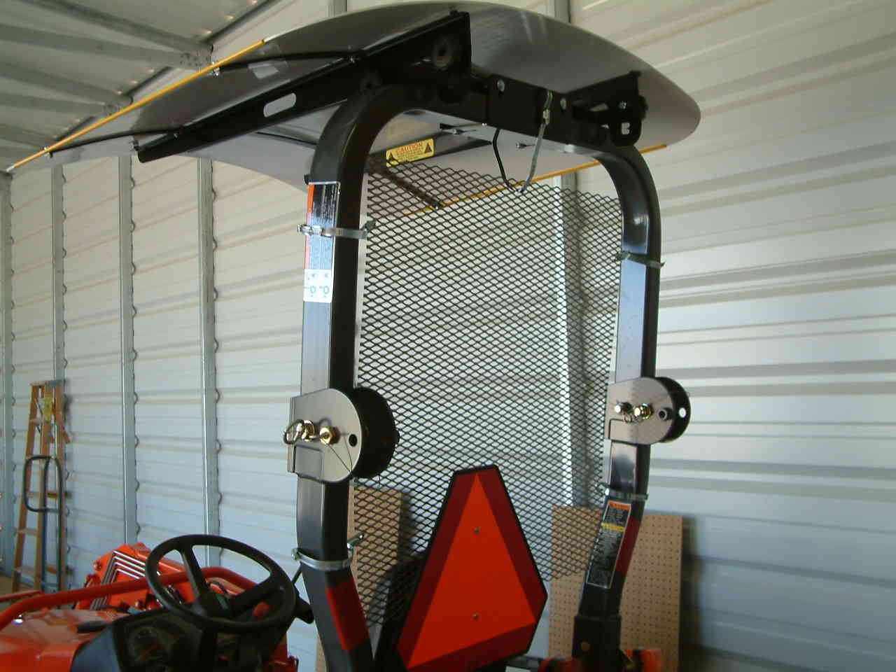

If you have to mount something on your ROPS, consider U-bolts or cheap hose clamps before drilling or welding. See attachment for an easy way to install an expanded metal protection screen on your ROPS.
