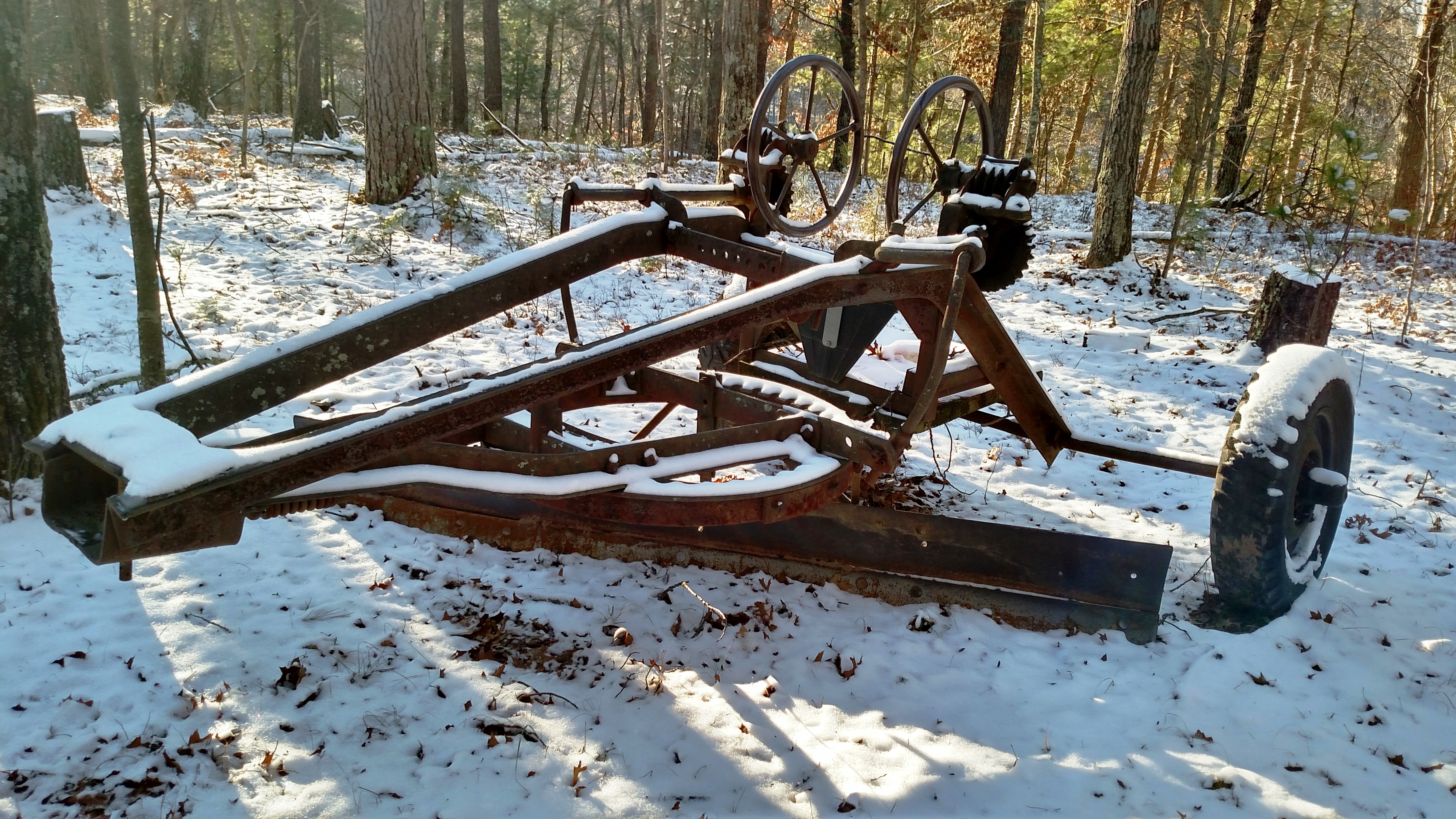

This sounds pretty close. A rear blade or landscape rake is even better for driveway maintenance if it has a tail wheel / guide wheel. I have a rear blade and a box blade, but what I use most for my 1/2 mile driveway are:
or
