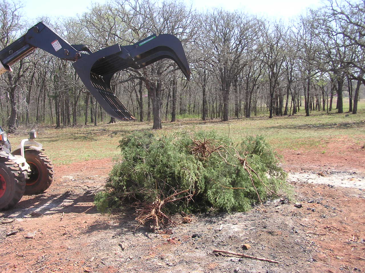

Loflin Monster Grapple, 6' wide. It weighs almost 1200 pounds.

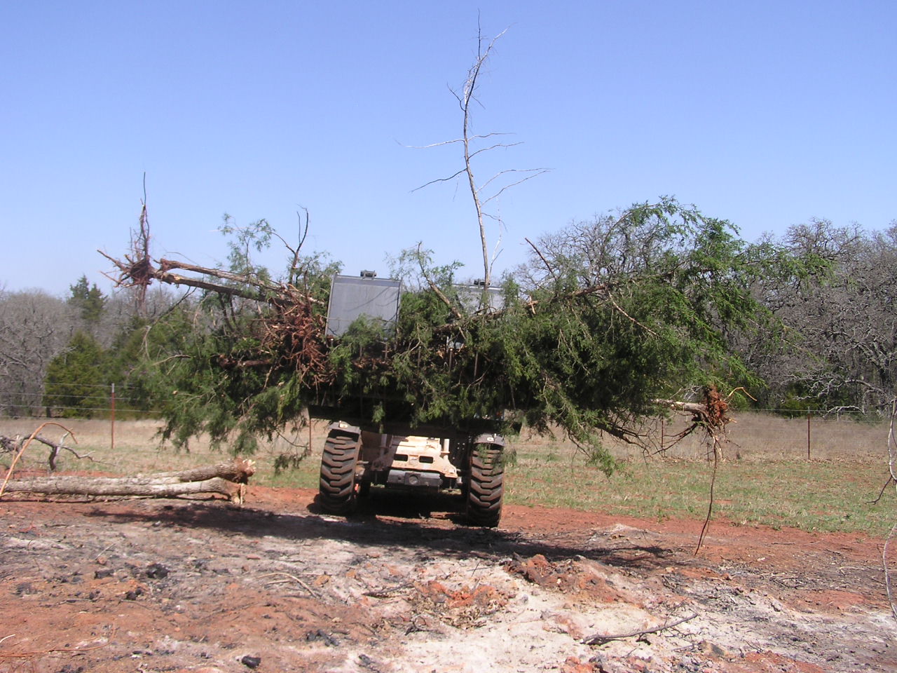

Last April I pulled a bunch of cedars with the tree puller and left them in piles of 3 or 4 trees.
I put the grapple on and made one trip, "smooching" and picking up piles until I had all 10 piles in the grapple.
This is about 35 trees.
​You can't do this with a 30" opening grapple!
