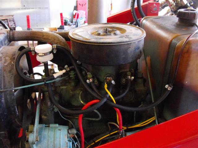

The one I went with does not have a cap. It is supposed to be filled by the injector fuel return line but so far no fuel seems to be going into it.

If this thing doesn't start filling up I may just have to do something like that. I ran the tractor around the place for about 20 minutes today pushing dead trees around, ran the engine fast, slow and up and down but still no fuel in the bottle:confused:. Maybe it will just take a while to fill up the extra lines I added. I know it had a leak on the line on the #2 injector and at least now that is fixed so some fuel must go down the line at some point. Still, at this point I haven't accomplished anything by adding it

Can you describe those parts? I can't quite make them out from the single photo. What is that white plastic-looking piece in line?
And how is the reservoir vented?

Make sure thats not a check Valve. Could be there to keep fuel from running back into the injector when sitting. And if the hose going into the Tank gets submerged and pressures up the line it could prevent fuel from flowing in or most likely slow it down.

Hopefully this photo is better. It's a little larger. The TS tank is vented back through the line that returns the injector return fuel to the tank. No actual vents in the TS tank itself.

OK. Thanks, I can see it now. Could you also doube check that the one-way valve in the line leading to the TS reservoir is installed in the correct direction?

If you are talking about that little white looking piece, it is a reducer from 1/4" to 1/8". The injector banjo's are 1/8" but the fuel bowl is 1/4" fittings so I had to use 2 different size hoses. I took the line loose at the reducer and can blow air though it back to the fuel tank to make sure it is not blocked.
I've got the oil pan off right now and waiting for the new gasket to come in. When I get it back together, I'm going to pull the line off the bowl on the injector side and run the engine to see if any fuel comes out. I don't know how much is supposed to come from the injectors or how often it does.
