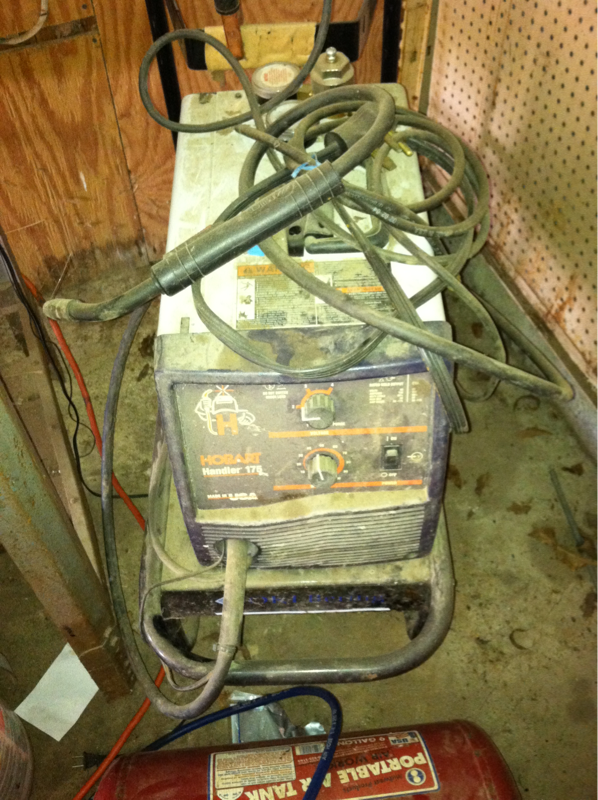

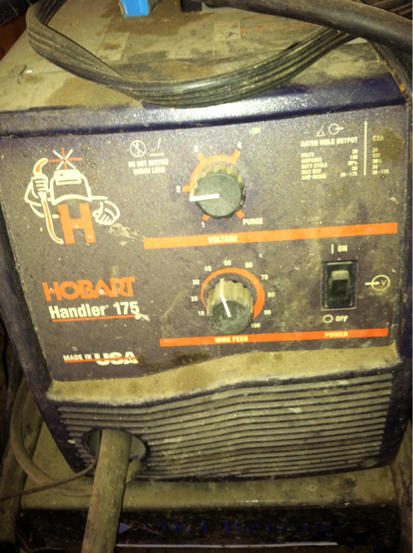

The last post didn't add my find, so this is what I got! Now (scratching head) how to use it?

Hi guys, just an update. The handyman finally got timt to wield the T-bar on this past Saturday, I didn't get to help because there was only one shield, but we are planning to have a learning time when we are not trying to get something fixed. Also, he didn't use the small welder that showed above, there was a huge gas powered one that I thought was a generator in the other corner... haha!
