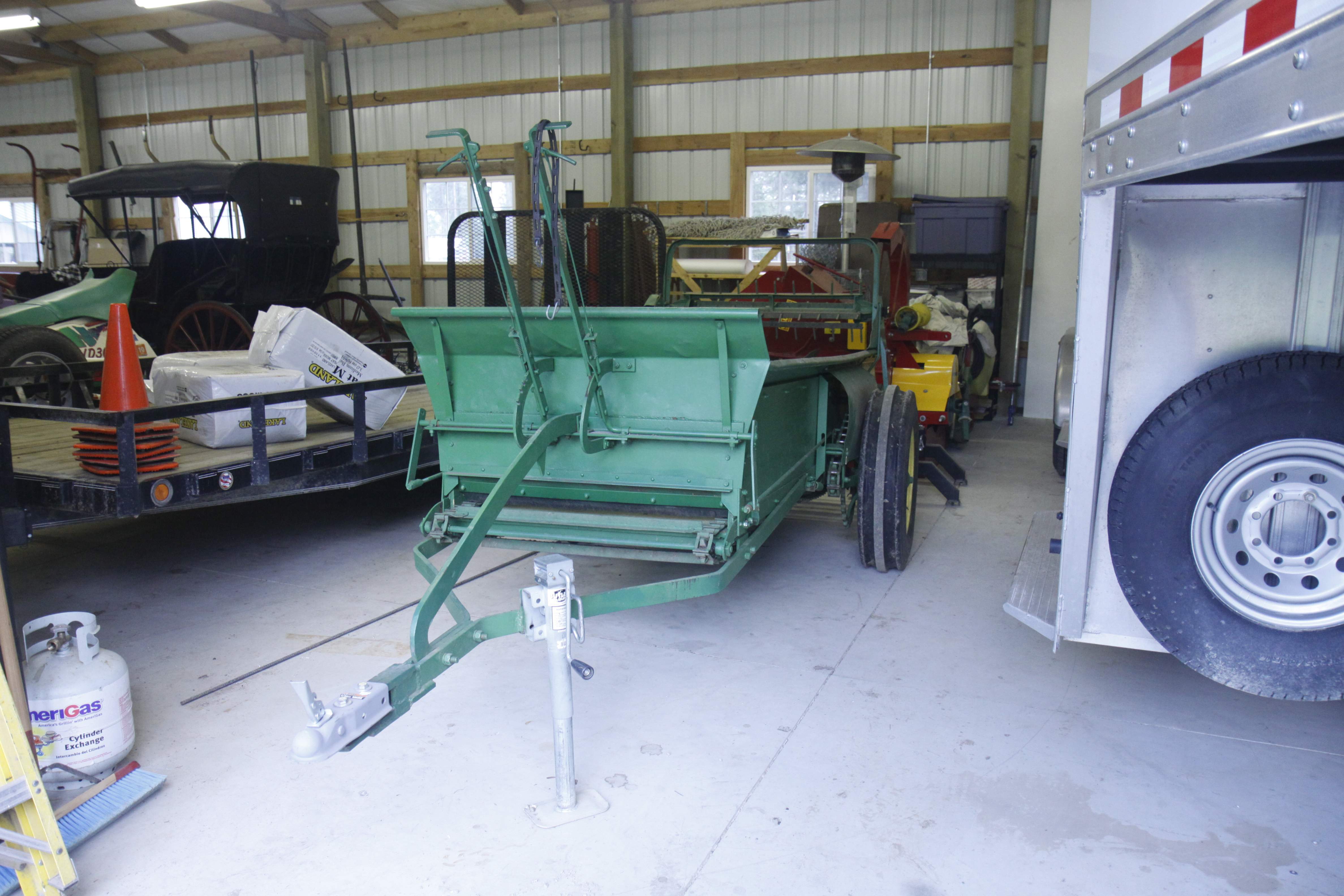

grsthegreat
Neat and clean. Do you take it through the car wash when finished using it? Brings back memories.
Noted yours has the different square chain than shown for the New Idea spreader the OP has. Your Deere chain comes apart differently.
And to LTF, when you rework the apron, make particular note that there are equal number of square chain links on both sides. The way the flights are broken, makes me think there may be a link short on one side causing the chain to ride over a sprocket and get out of synch. Just a passing thought.

no car wash....just hose. hay...car wash, that would make my life easier, but the car wash owner whuld have a s*&% fit . hehe

Hi guys, just an update. The handyman finally got timt to wield the T-bar on this past Saturday, I didn't get to help because there was only one shield, but we are planning to have a learning time when we are not trying to get something fixed. Also, he didn't use the small welder that showed above, there was a huge gas powered one that I thought was a generator in the other corner... haha!
He figured that the chain needed to have one link taken out on both sides to tighten it up and then when working on tightening it we counted that the last person had one more link on the right side then the left!!!:confused: Also, on the spreader both shearbolts were, well sheared.
