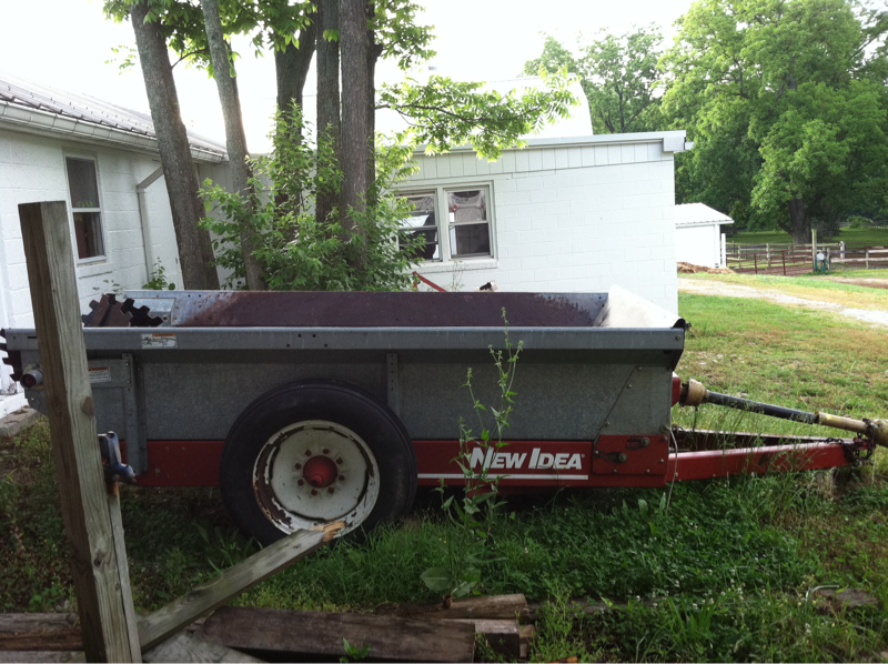

I have not one but two manure spreaders provided by the farm, I would like to know what to look at to see if they are in "working" order. They have sat out in the weather for at least 2 years. What maintenance should I do before using them (I figure check the tires and air pressure). On a side note, I plan on spreading compost with them from composted horse manure, is there maintenance I should do after I have finished the job? I will be storing them in a covered equipment area.
/ Things to inspect on manure spredders #2
Much will depend on what type/style the spreaders are that you have. Care to post a pic or two, and the make and model #'s ? I'd suggest some "dry" runs with nothing in them, to see if the mecahnical parts are working (after checking for any broken or missing parts).

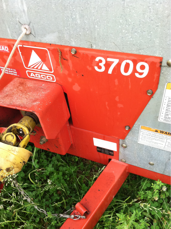

Been, here you go!
#1 is a AGCO New Idea 3709 is the number.
#2 is up on the hill and I will take more pictures later

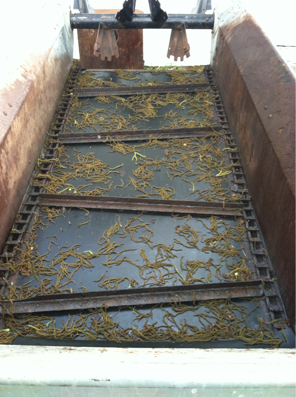

From the pics, looks like the apron will need to be fixed, as one or two flights appear to be broken away from the square chain. You'll get some learning on how to slip apart the square chain links (having the right anvil tool will help a lot here) and possibly how to repair the rivets that connect the flights (cross bars) to the special links. Having a neighbor or friend nearby as a tutor will help a lot here.
Getting a manual with parts breakdown will help a lot.

I happened to catch one of the guys that does some maintaining on the farm this weekend. There are many broken/rusted snapped flights (learned a new word). He said that yes, the power part is fine but the chain had jumped and a lot of the flights are broken. If I buy a new set it is $450. That maybe easier than learning to wield. Haha!

Flights is what Been called them I figured they were the bars. The chain and bar things are rusted really bad, most bars are broken. I found the bolts which is how to remove the current chain. All of the equipment on the farm was abused by the last field person. I knew him (the reason the chain is hitched is he was liquor drunk 90% of the time) and he left it that way. I found a finish mower in the weeds missing a wheel (I am hoping that is the next piece I fix up). I am not a life farmer, I didn't know that machine shops (places to fix stuff) existed. Do I just take in the broken bars? I am not trying to throw money away, I just don't know what else to do but replace.

I notice that Shoup's calls the flights, bars, crossers by the name of slats. These slats may be just steel angle iron that can be bolted to the right and left t-bar chain links. If so, repair will be much easier than trying to weld them up. Deere calls the crossers 'flights' and the assembly that I've always known as the apron, they call the conveyor. So names are all around the place. :) But they all are the movers. ;)
For rust, many will use a pressure washer to clean the spreader after manure use, and then if storing it for a period of time will spray it down with used motor oil. That will help the rust and also help preserve any wood in the floor boards.
