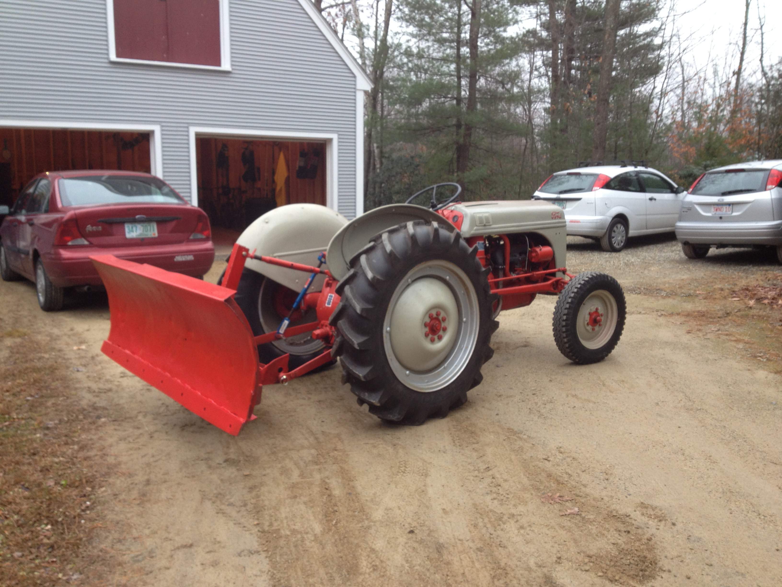

Using a bucket for snow takes forever. I use a rear blade and it is much better. If you don't want to dig into the grass or gravel, try using the blade the wrong way. On pavement, use it the correct way so it scrapes clean. If it snags the cracks in the pavement, angle the plow. I have a 5' Lorenz blower but I use the plow most of the time instead. With the blower, my travel speed is slower and the rpm's are more. I have plenty of places to push the snow too. snowblower1.jpg

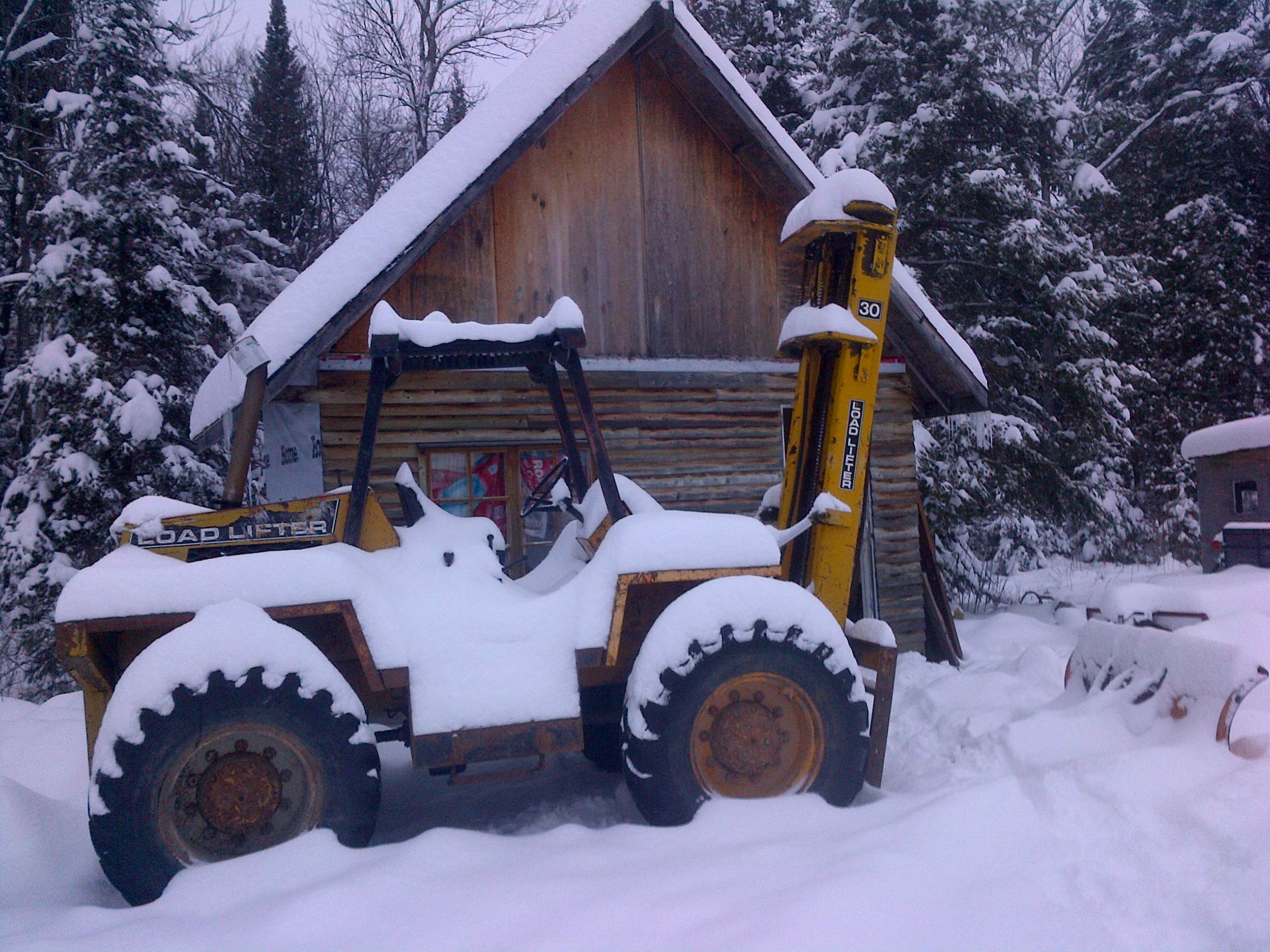

Then, when the blowing is taking too long, you get the big guns...endloader.jpg

very nice , does it work well ? That's a ford 8n ?
Correct, it's an 8N. The plow works great, the high reverse speed of the 8N really gets the snow rolling.

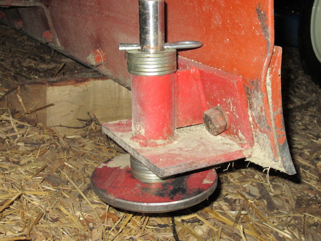

For a gravel drive, I made these bolt on shoes. I can quickly pull the pins to remove them to scrape the pavement.rhino shoes 001_1.JPG
