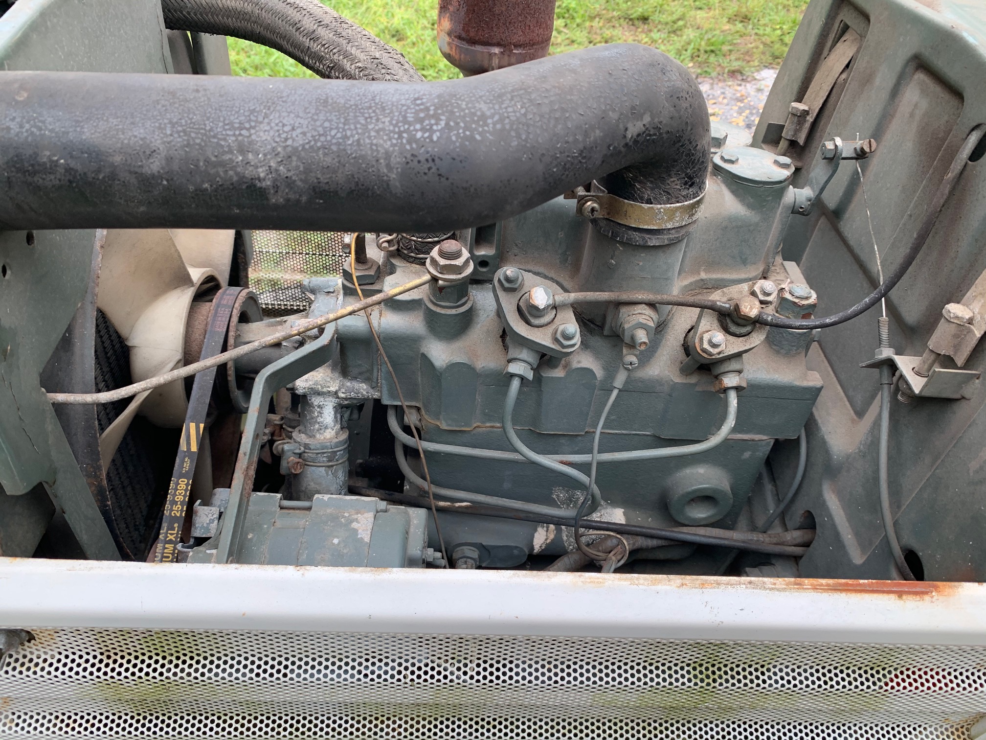

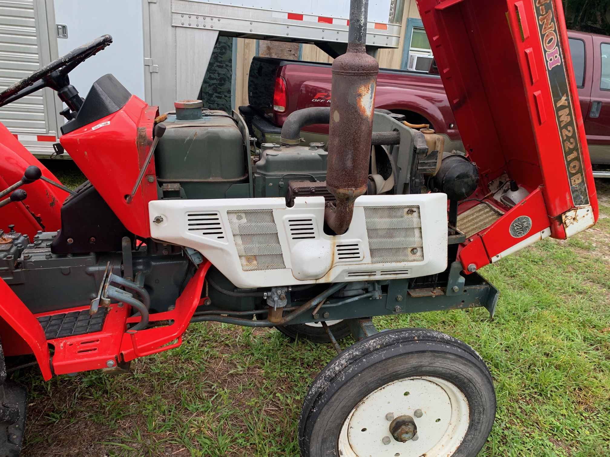

Again, thanks for all the good wisdom. Got it home yesterday and gave a harder look over. Motor looks great - oil clean and overall tight with no visible leaks, battery is late 2018 and starts right up. A bit more surface rust when I looked closer, mostly on the hood and a fender near the flasher. Lights work, as do dash lights. Found the filter screen cover and sprayed some pb blaster on it last night. Got the box blade off with the help of my loader. 3 point arms act like they are just disconnected - totally free - can lift them up easy and they drop right down when you let go.
I'm going to start with the hydro flush and see where we go.

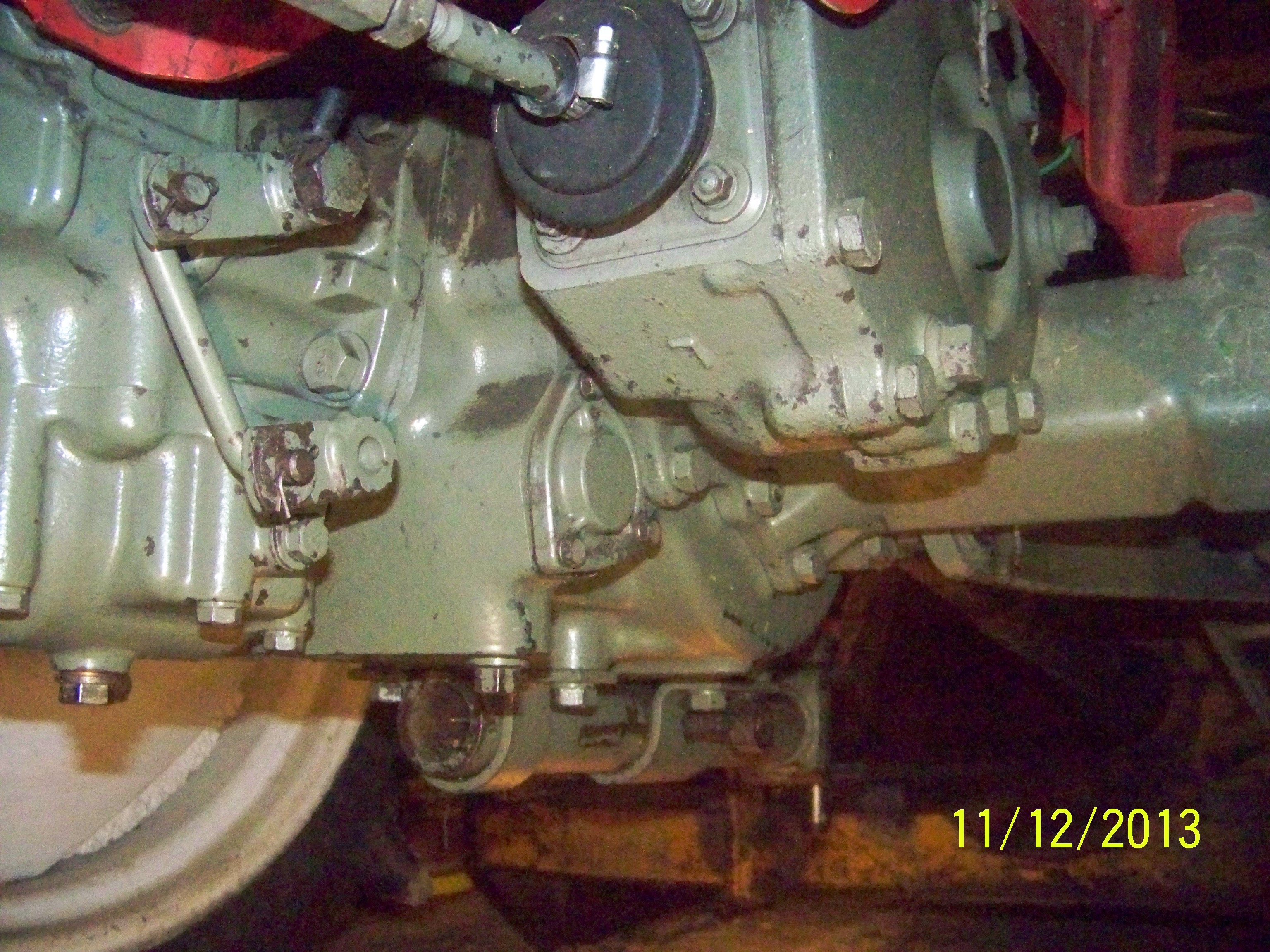

While I was under the tractor working on the screen - I saw a couple of heavy metal loops which look like maybe where a shaft fits for a drawbar but it's round - does anyone have a drawbar on their 2210? Is it round where it fits in the tractor?

I think (?) its universal that within the YM's, gray market will have round drawbar. And US YMs, flat bar.
