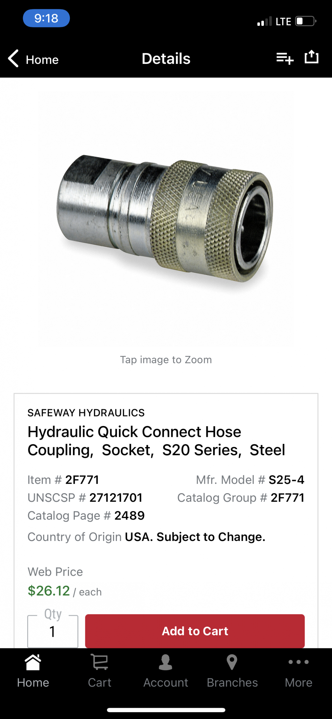

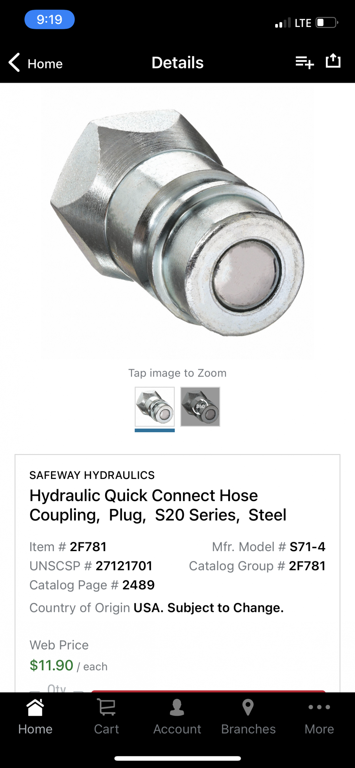

I went ahead and bought 2 sets from summit of pioneer style quick disconnect total was 19$ I like the pioneer style disconnects better they are easier to connect went without 3/8s because that's the size of my hoses to my 3rd function so 1/2 wouldn't help I would need the adaptors. The only implement I have is the grapple so I think it should be fine One make connector was going to be like 12$ Without the caps so I figured I would splurge and get new ones with the caps for an extra 5$ lol
/ Third function disconnects ?
#22
Just wanted to say thanks for the advice. Got my new 3/8 summit pioneer style connectors and installed them and man is it 1000 times easier than the skid steer connectors I had. No more fighting with trying to push as hard as I could to connect. Just pull back and click. So much easier. Well worth $19 should have done this years ago
