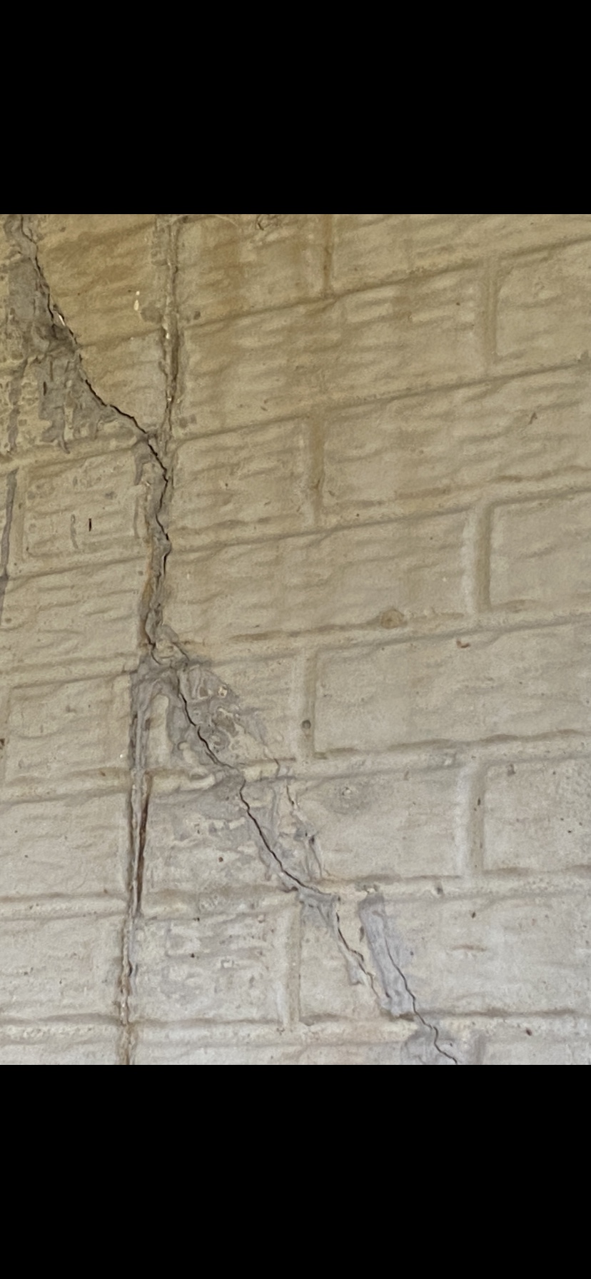

Eddie it was very common around here to use that type form on exposed basement walls. Has a laid brick design. I've even saw people roll reddish color paint on the walls to make it look like a brick wall.

Does the 2400 square feet include the basement?
Is that a pattern on your walls that was created by a form? Looks a lot fancier then just plywood forms.
Does not include basement, and 2400 is rounded. Bigger now with rooms over garage.
Forms have a brick pattern. There are people that paint them to look just like brick.
Here’s a closeup, with crack the excavation contractor put in backfilling. Current picture.
