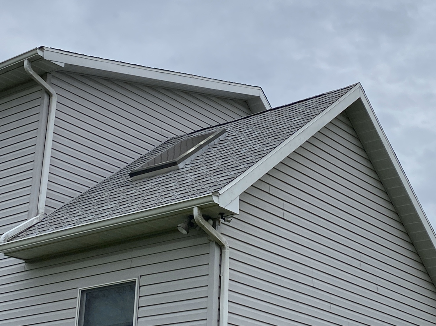

Here’s current picture of the back 10ft 10/12 pitch I mentioned Saturday.
