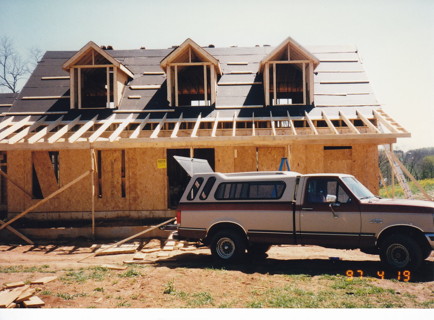

19970418 Friday
3 months since I started framing.
After work, more porch rafters.

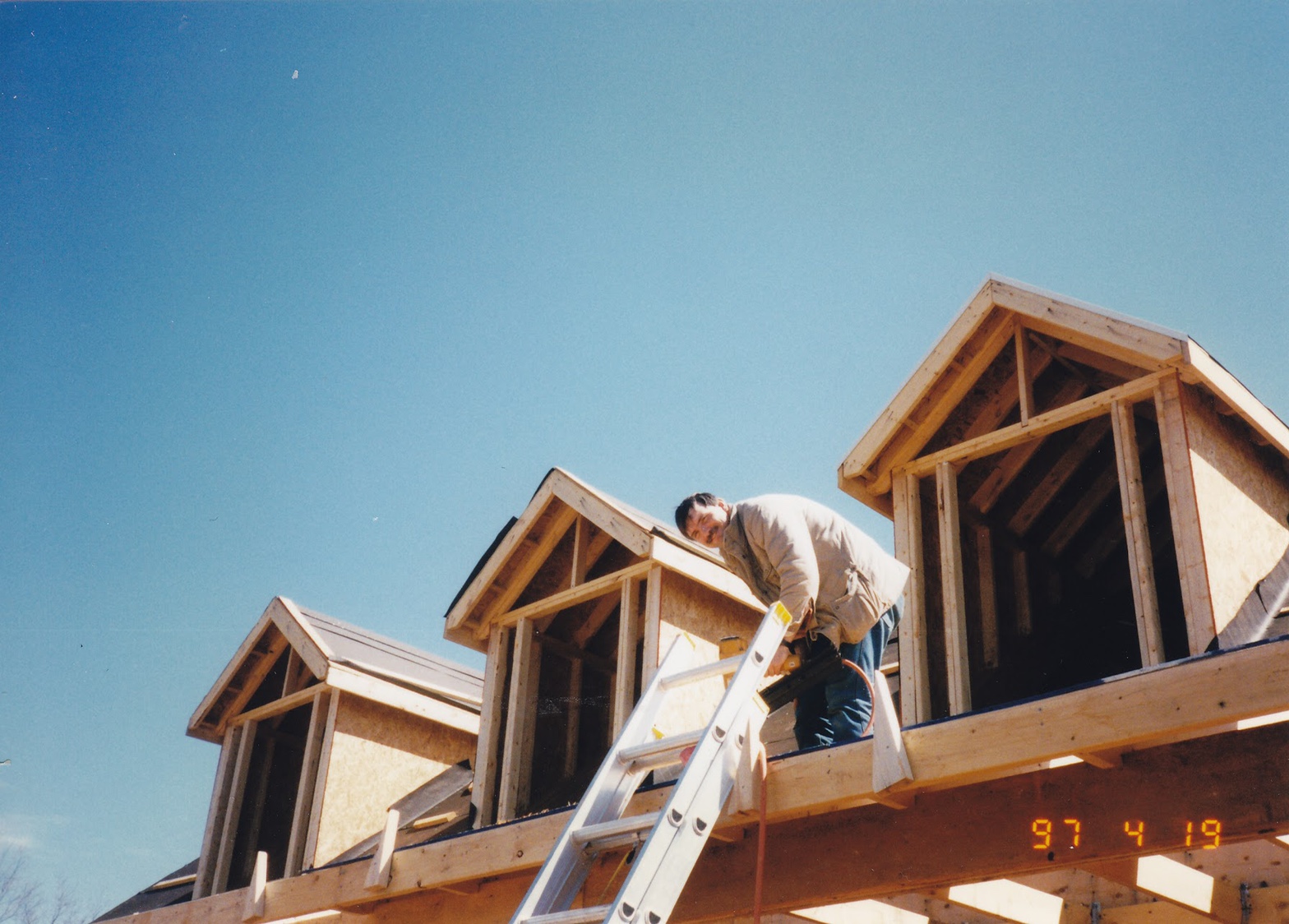

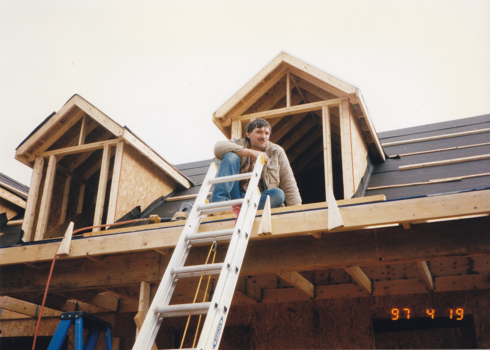

19970419 Saturday
Finished the left end wall (needed it done to build left porch) triangle hole in this pic.
Installed overhang and header on right end porch roof.
Sheath porch to left end of house.

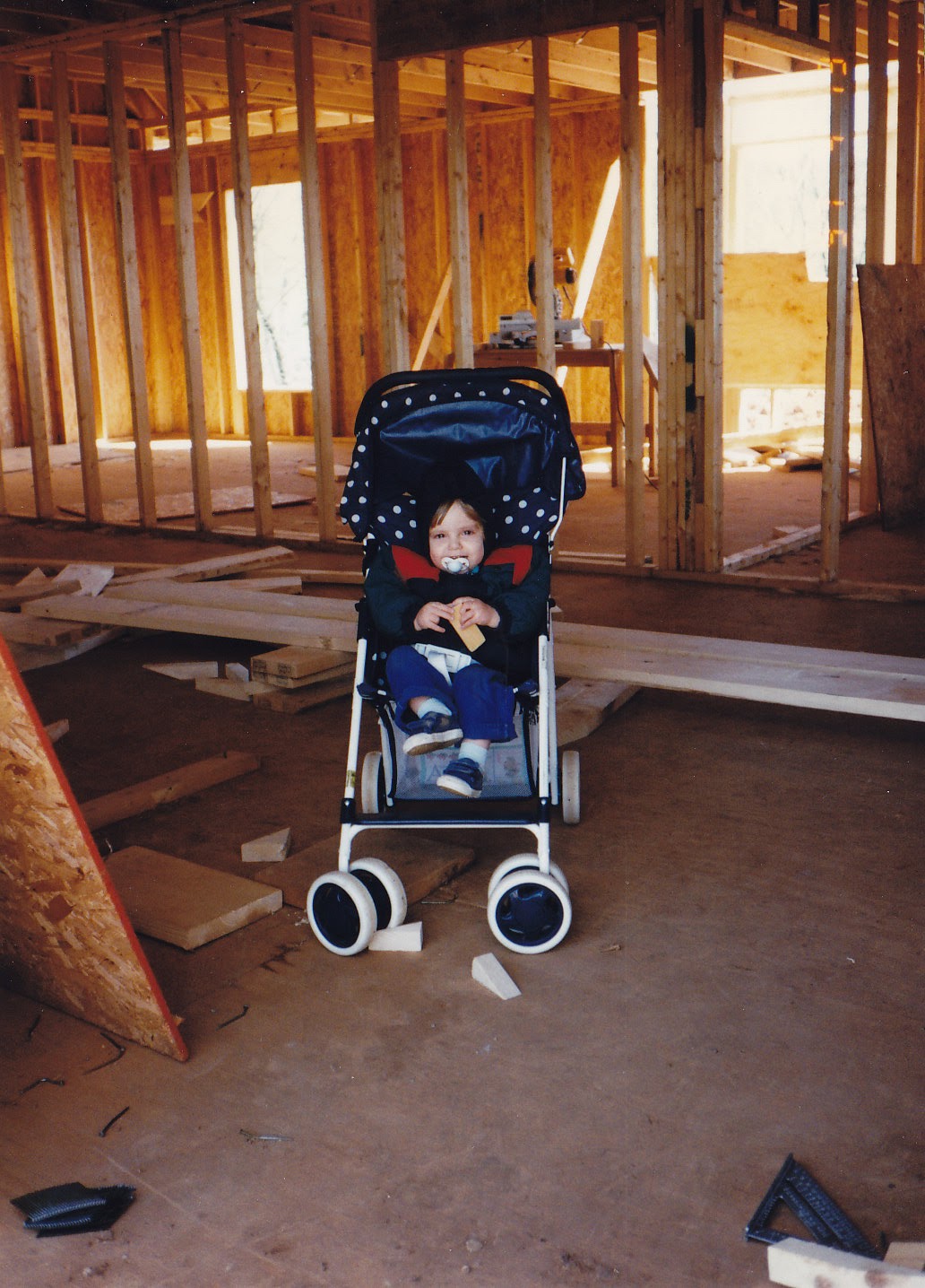

19970423 Wednesday
Start half bath walls, right behind the stroller.
