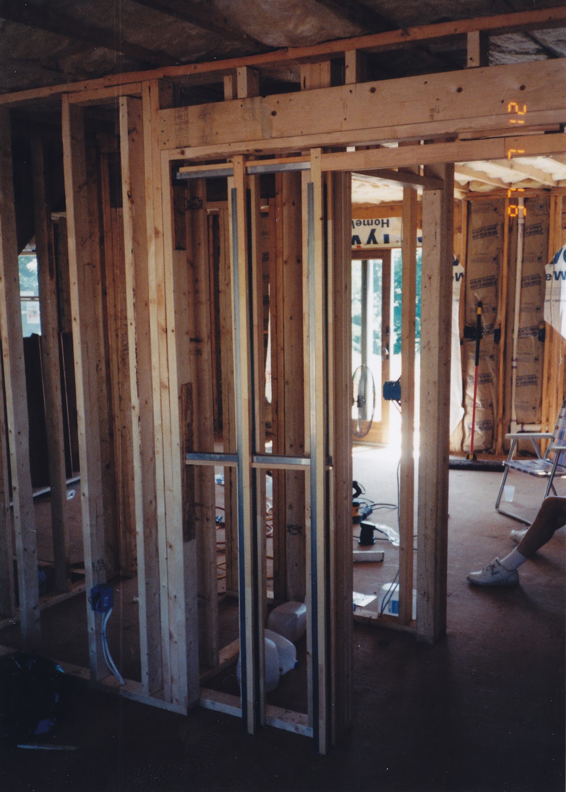

No recorded work for the 23rd, but here is a look at pocket door framing for the office.
