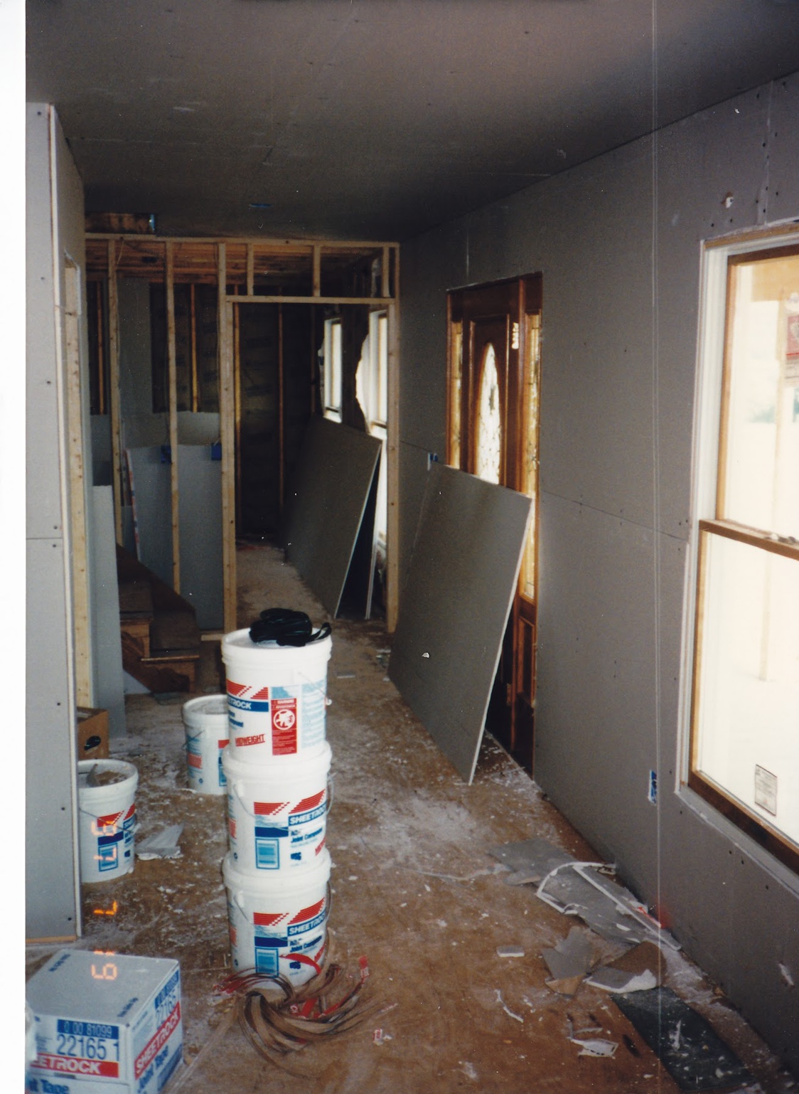

19970718 Friday
Dry walkers started hanging Sheetrock.

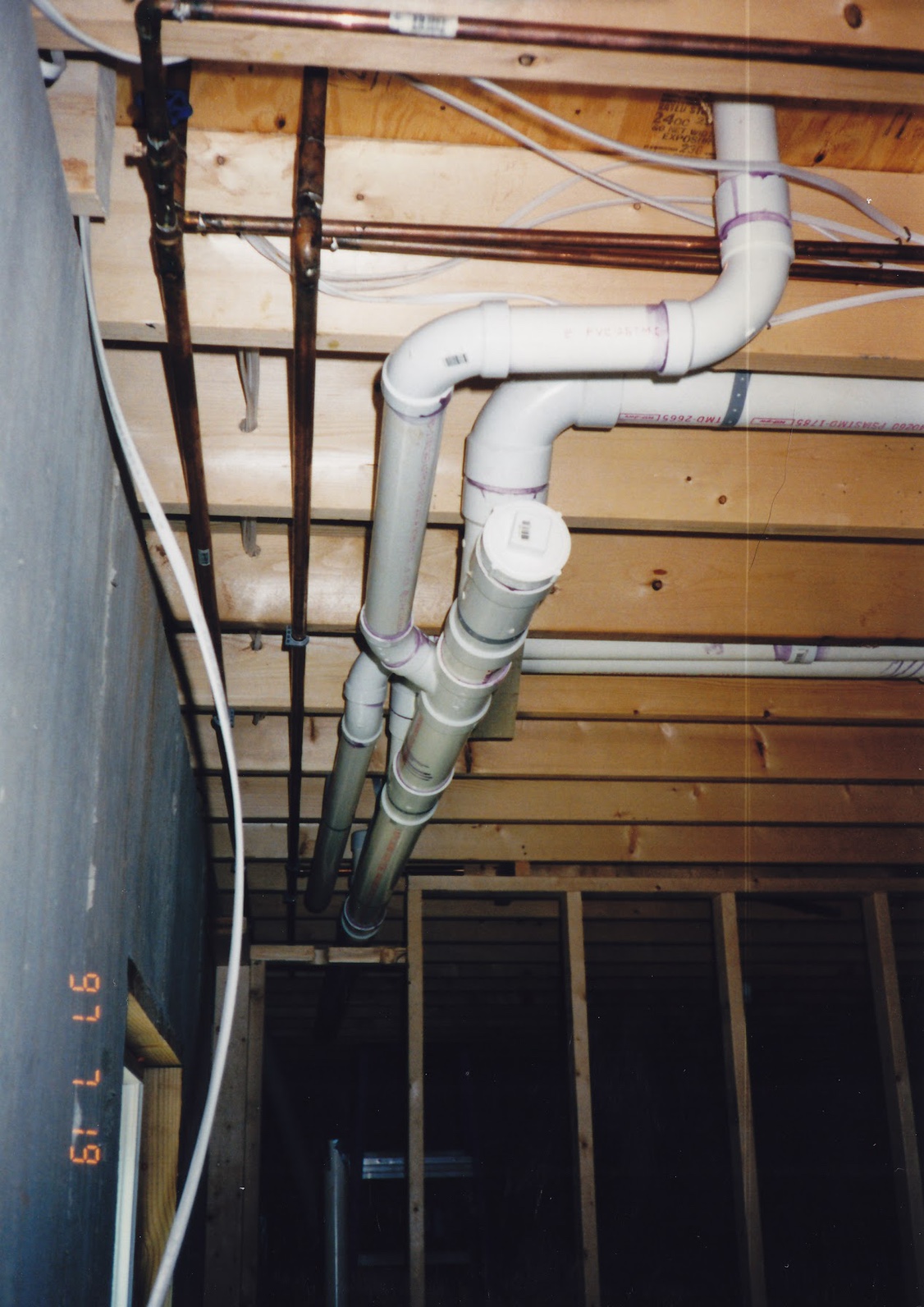

#466
19970719 Saturday
Put together drain stack in basement.
Run 1” well line across basement ceiling

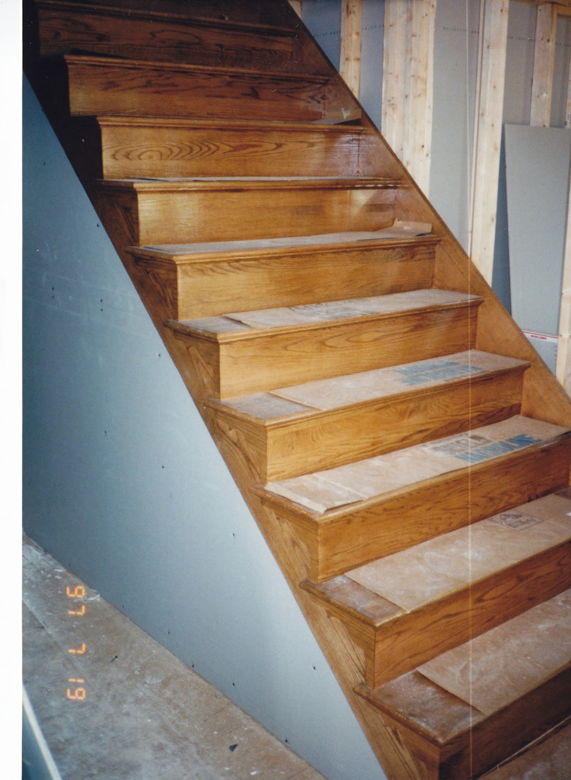

19970720 Sunday
Work on basement laundry waterlines.
Build right wall next to basement stairs.

#469
19970721 Monday
Drywall guys hung most of 2nd floor.
